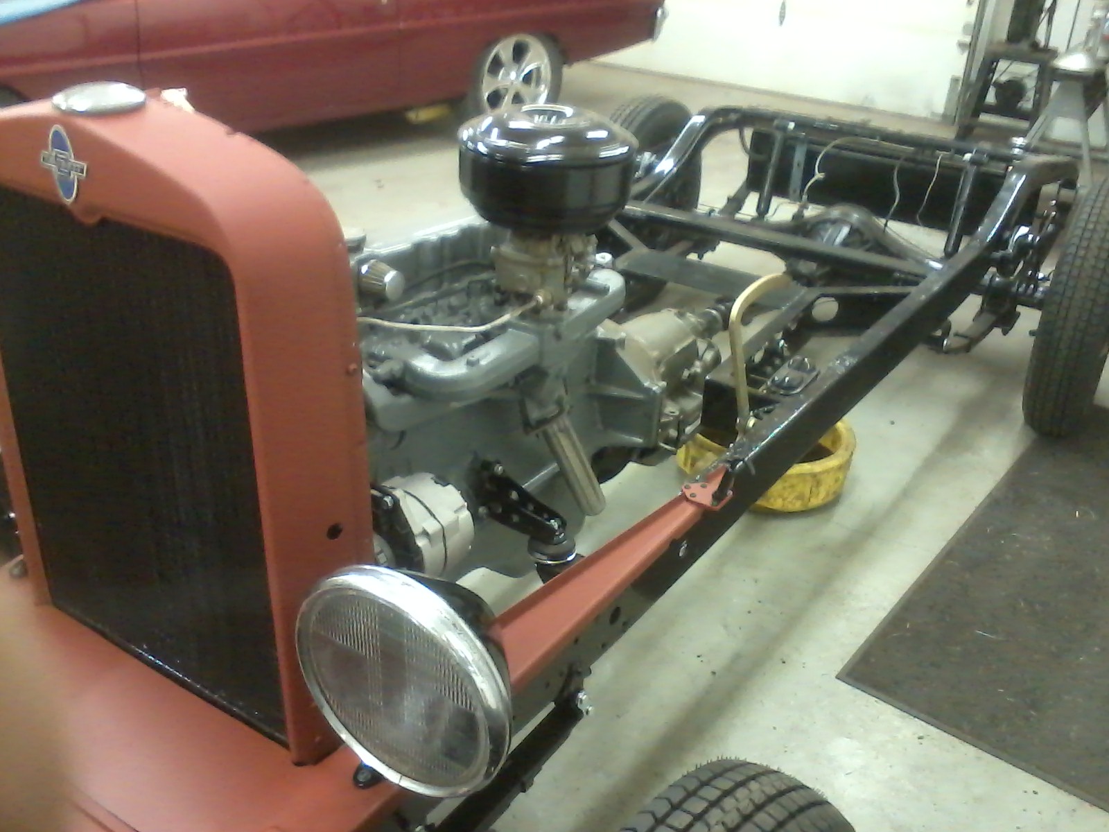

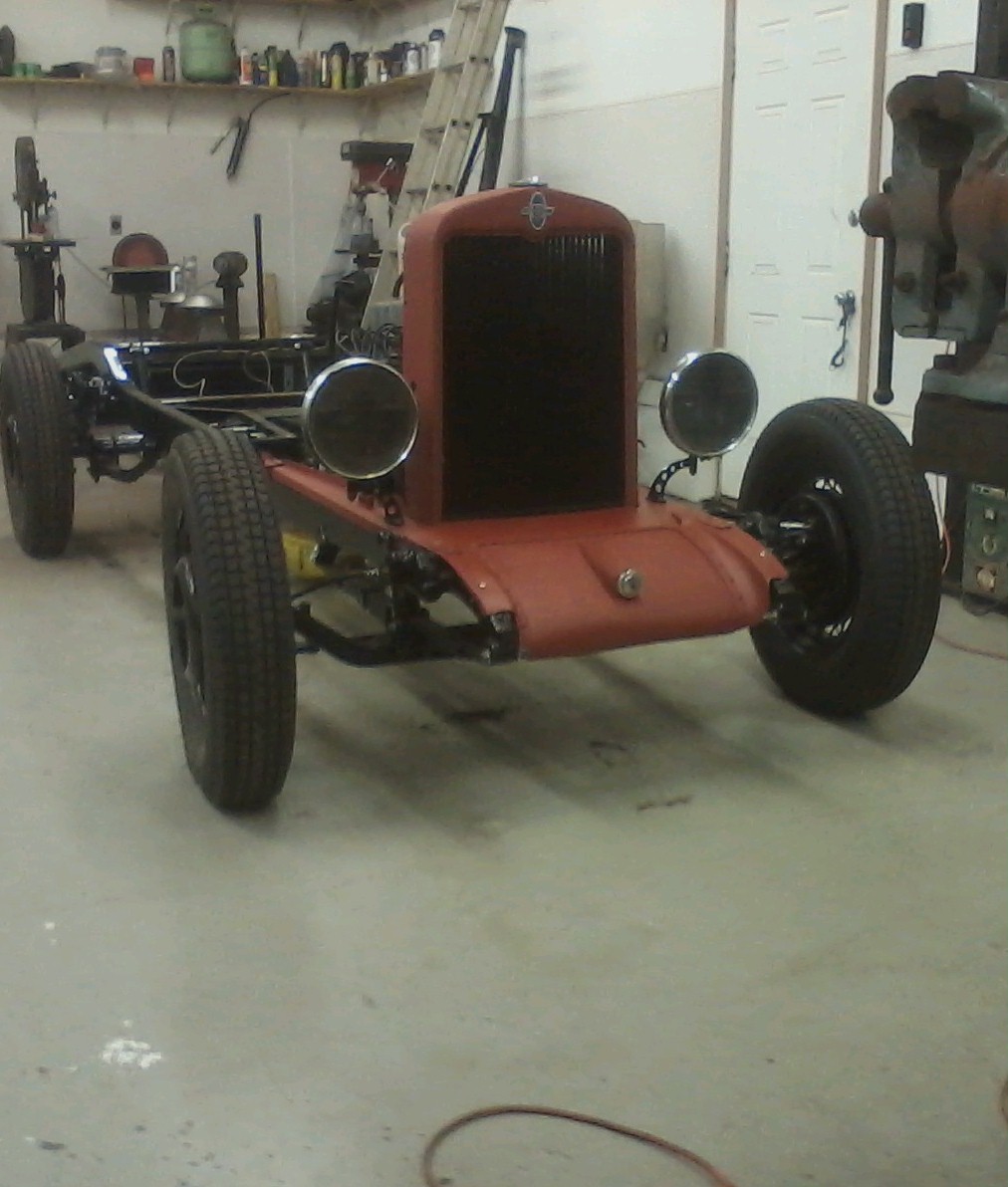

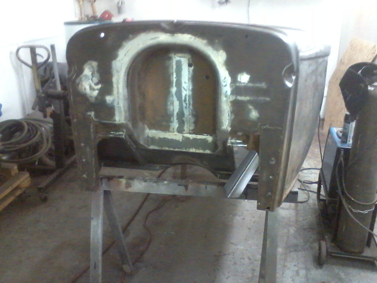

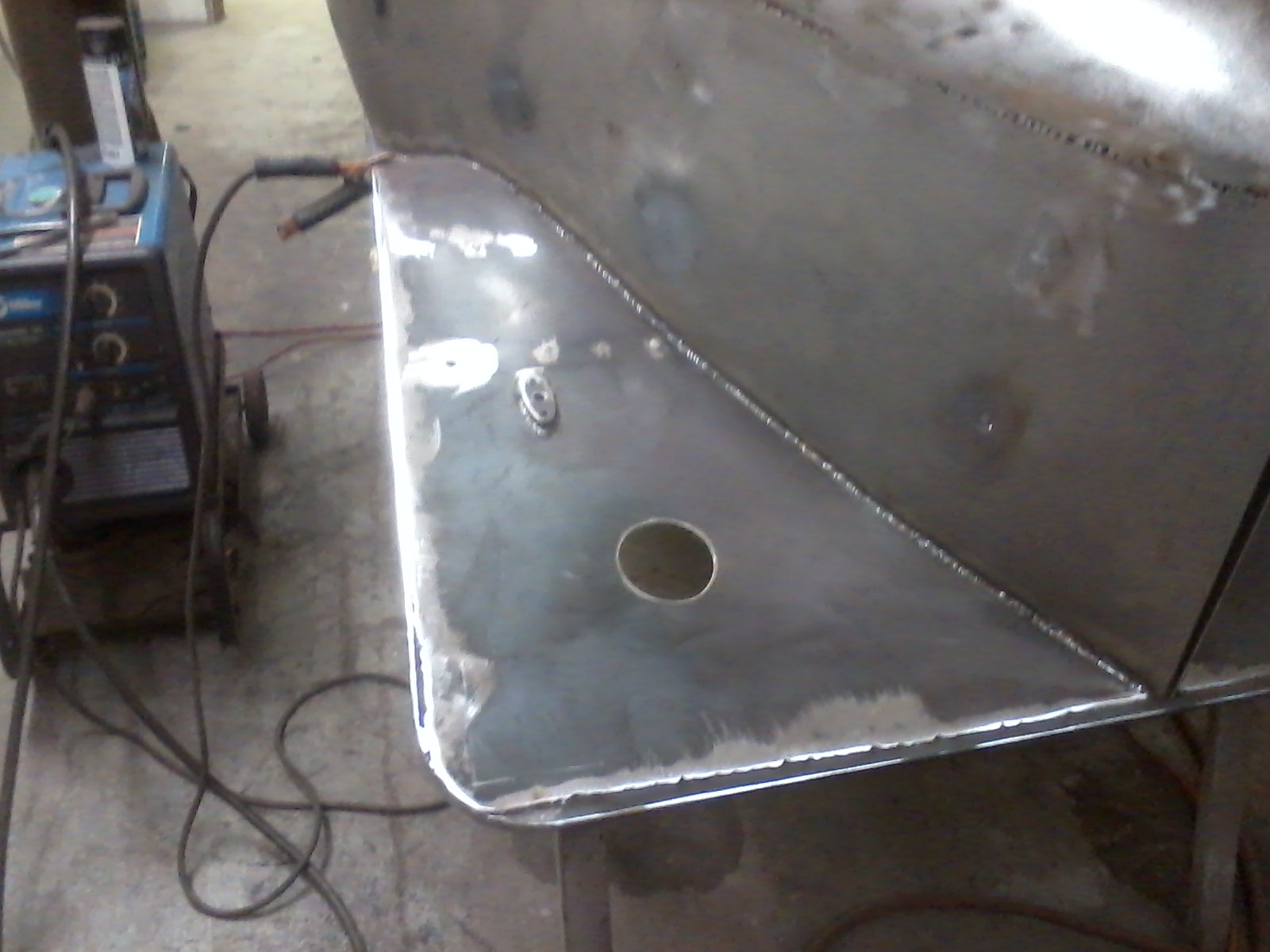

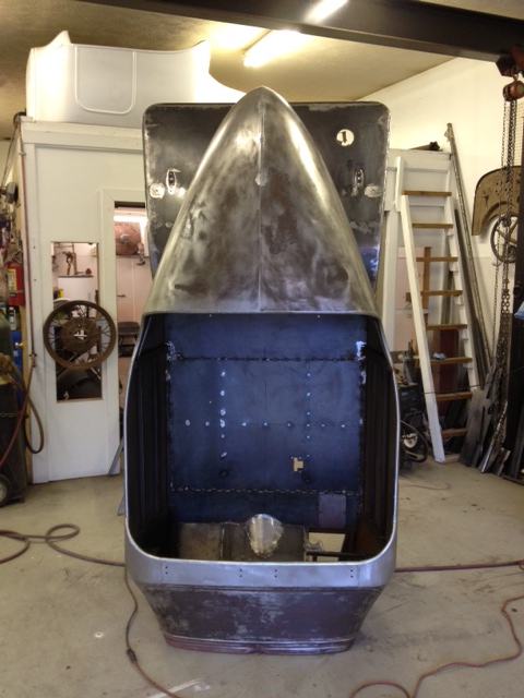

    1930 Chevy boat tail Speedster. I haven't posted in awhile. We are working on the body tub now. Engine sounds good, driveshaft is in, it has brakes. Lookout here we come. I can't thank my friends (Roadburner1 and his father) enough. Gary
    volvobrynk likes this.
  8. Six Ball
    Joined: Oct 8, 2007
    Posts: 5,833
    Six Ball
    from Nevada
    This is really looking good! I love the front end and my '26 will be very similar. Are you using stock springs and axle? What size are the wheels and tires?
  9. 2NDCHANCE
    Joined: Sep 11, 2007
    Posts: 997
    2NDCHANCE
    Six Ball, Using the stock springs front and back with three leafs removed from the rear. Using 1954 Chevy half ton pick-up front axle (six lug) and drum brakes, 1995 Nissan Pathfinder rear end, limited slip, with six lugs, perfect width. Rims are 17" 1936 Chevy Master deluxe wires with Coker Excelsior Radials (6.00-6:50 size 29" tall) Not cheap...but they have the look. They balanced out pretty good. Thanks, Gary

    Thanks for the details. They help me sort out all the stuff rolling around in my head. By the way I like how you are doing the boat tail too.

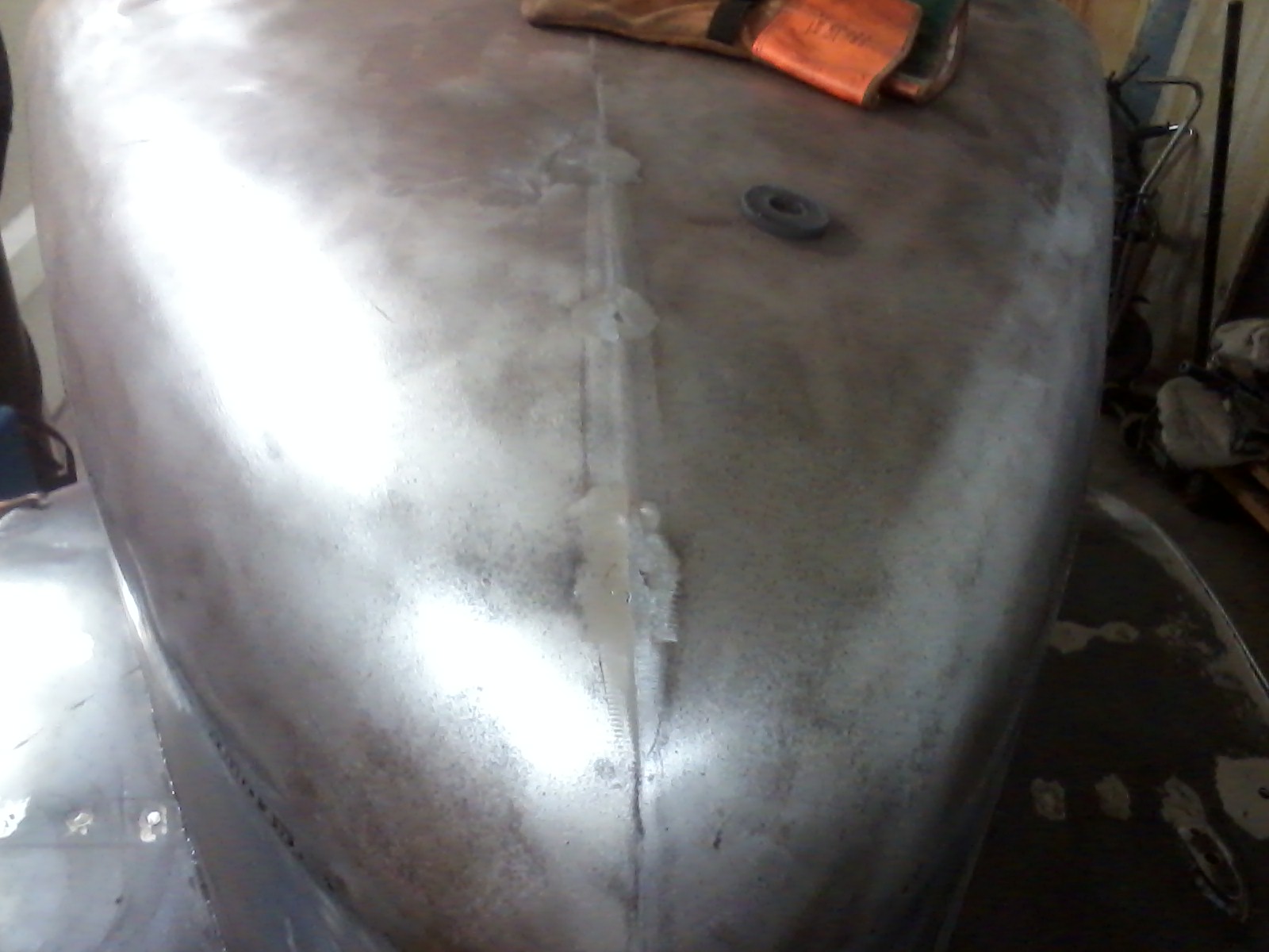

    2NDCHANCE, That is beautiful!

    Thanks Gary. Looking at your torpedo tail body (for lack of what to really call it) & that is really going to be something when finished. Actually it is really something nice right now. That would be a great build to follow.
