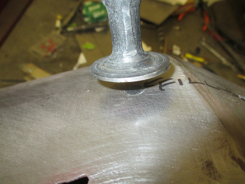

    Begin by making a tack and checking that the patch is still flat.
    Next fully weld the patch in.
    Then back it up with a dolly and smack it solidly but not enough to damage the area to stretch out the weld shrinkage (this does not work as well with a mig weld because it is very hard).

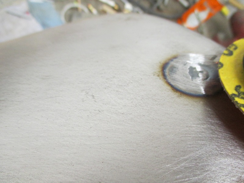

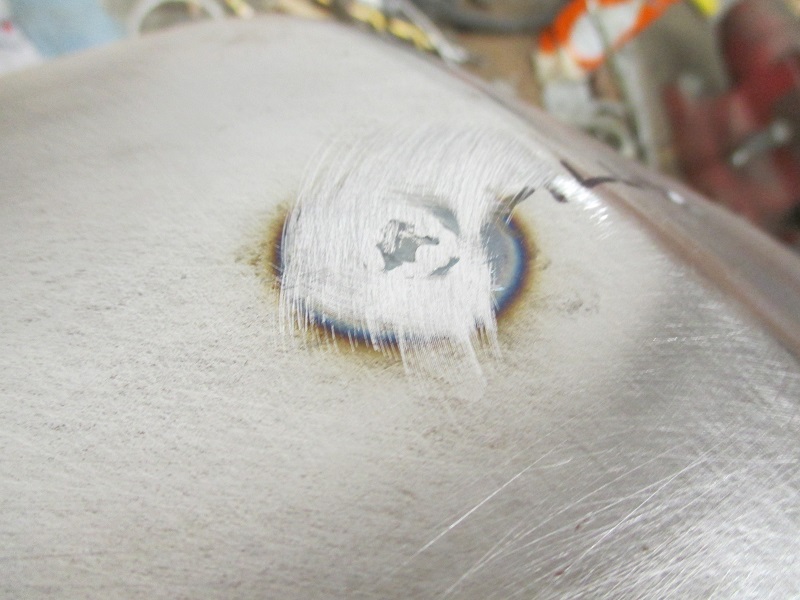

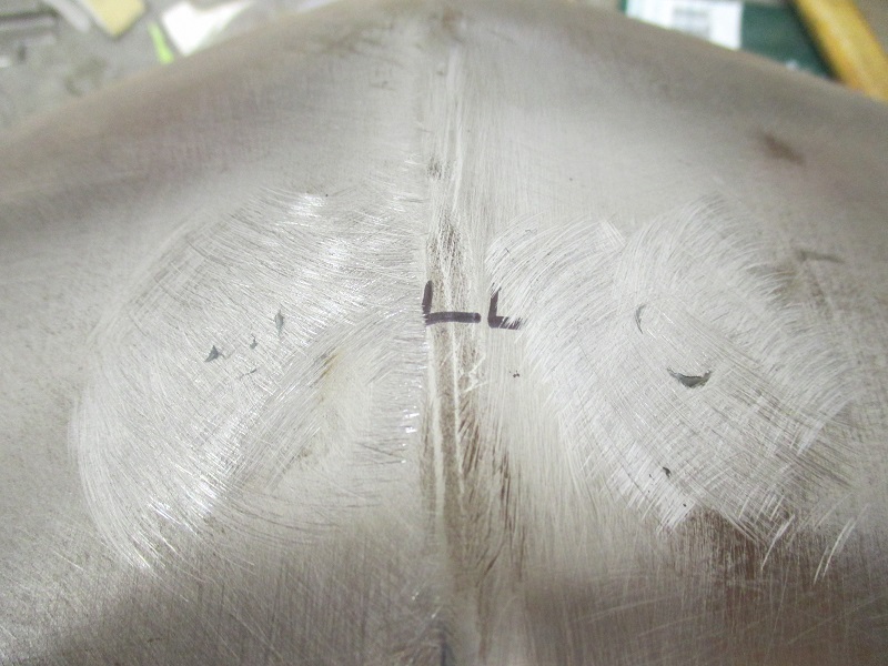

    Grind down the weld with a sharp paper disk (I use 36 grit) until you are close to the base metal. At this point take it slow and use a cross pattern of grinding alternating directions so that you don't create a divot on the leading edge. Some would want to use a Vixen body file to smooth it off, I don't own one yet so I got good with a grinder.
    Repeat the process for the next hole. since the patch was thicker than the base metal you can also grind the backside for a seamless finish inside and out.
    Well hopefully this helps out in keeping metal warpage to a minimum. Get out there and hone your skills on your hot rod or custom.
