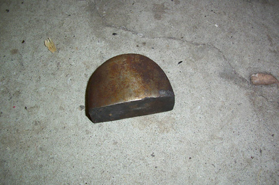

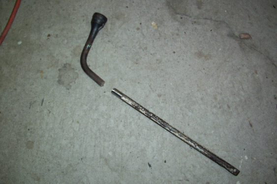

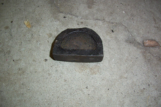

    I made something tonight I thought some might have a use for-
    I have several old tire irons laying around I use surprisingly often. Tonight I needed a thin wedge I could hammer on to get an exhaust manifold off, and came up with this idea which can serve many uses...including bodywork in hard to reach places. You can beat on the one end to from creases, use the dolly end to get behind panels and hammer away, or you can use it like I needed as a wedge. The dolly was a el-cheapo I never used.
    I cleaned everything up, welded the tire iron to the bottom of the dolly, then welded a washer to the dolly and the tire iron for even more strength.
