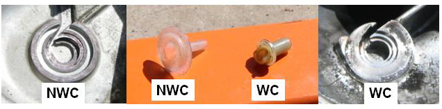

    One of the items I never see mentioned during the various "bolt an S10 tailshaft on your Camaro/Mustang T5" discussions is that of the countershaft oiling funnel.
    I have maintained that the funnel needs to stay with the tailshaft due to different machining in this area.
    While a WC oiling funnel will go into the pocket of a NWC tailshaft w/o any interference, there will be some minor loss of lubrication to the 5th gear cluster due to leakage around the funnel.
    A NWC oiling funnel will probably not allow a WC tailshaft to seat properly, but nobody ever does this.
    I just happened to have a Mustang T5 out to fix a speedo gear issue & thought I'd snap some pics. From left to right is the oiling funnel pocket in a Jeep NWC T5 tailhousing, a NWC oiling funnel, a WC oiling funnel, & a Mustang WC T5 tailhousing oiling funnel pocket. It's very difficult to tell with pics, but there are different depths to each of the steps between the two pockets as well as different overall shape.
    So, if you're going to swap an S10 tailshaft onto a WC transmission from a Mustang or Camaro, grab the oiling funnel too!
    (This will be added to the T5 tech)

    Since I posted this a few years ago, I've discovered there are variations in the machining between various tailhousings - and they're not the same WC-WC or NWC-NWC. Sooooo....I have to revise my recommendation to use the oiling funnel that fits your tailshaft and countershaft! I believe there's only two funnels, so use what works is probably the answer...

    Sorry - original post meant to say keep the funnel with tailhousing. The funnel fits into the countershaft, but the machining is in the tailhousing.
    But I've seen variations in machining now. I've also seen converted trans with "wrong" funnels and no apparent damage to the countershaft. I have seen combinations that won't allow the funnel to fit properly and the tailhousing to seat.
    So, I guess my new advise is to be sure and use an oiling funnel - whichever one fits your application....
    The more I play with T5s & learn about them, the more I'm convinced just about anything is possible....I've seen so many variations on things...
