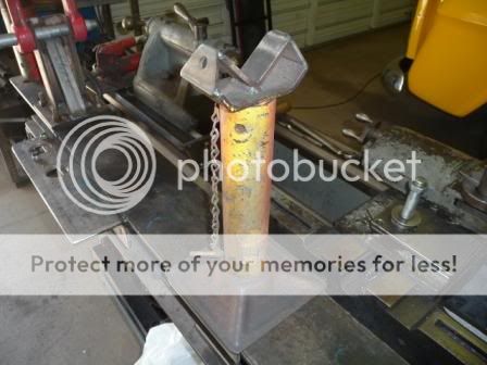

    The other end of the housing is supported with the jackstand that has a piece of angle iron welded to it allowing the housing to rotate easily. The jackstand can also slide on the I-beam to accomodate different housing widths. The jackstand is used to provide a height equal to the height of the Porta-Power and support the housing, nothing more:
