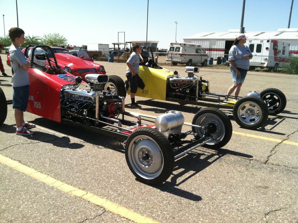

    thanks guys we have had lots of fun with the cars and are still flying high from Saturdays test and tune .....now a little story on how they ran and what we need to do .... the red car had a bog off the line and I couldn't hold it on the line .. we found out today that the converter is out of a 1975 and is more then likely a lock up converter . I could only get it up to around 900 rpm before it would try to roll out of lights ....need to find converter .... also had a bog coming off line need to get a smaller set of ventures the ones I am running now are for a sbc which needs little more off the line ...other then that the car ran good thinking about making those changes and see what we get I only turned 4800 at the lights and the car really started to pull in 3rd gear but ran out of race track so we make the little changes then maybe see if we need a gear change..running a 3.70
  5. moracing
    Joined: May 13, 2011
    Posts: 195
    moracing
    from arizona
    now marks car the yellow one is little better little bog off line .. maybe ventures to big.... same gear little slow off line he said was spinning tires off the line a little so need to lower tire psi .... also around 4800 at lights pulling real good in 3rd gear so maybe need gears .....

    ImageUploadedByH.A.M.B.1369360812.581628.jpg this is one of the best pics of the week end the boys are just as pumped up as we are ..

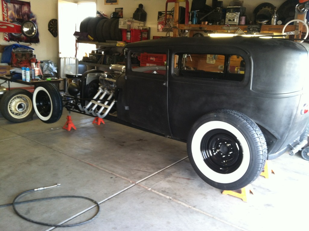

    ImageUploadedByH.A.M.B.1374296484.042877.jpg ImageUploadedByH.A.M.B.1374296526.906749.jpg ImageUploadedByH.A.M.B.1374296561.032482.jpg

    Here's what we been putting together the last few months .now it's off to Texas

    Nice project. Did you build it to sell?
    Any slant 6 speed secrets you learn from your machine shop guy and are willing to pass along would be appreciated.:D

    Well guys that is one nice open wheel two door sedan hot rod. Did you cut & chop the top in house? Real nice job. Do you guys have real jobs or do you just build hot rods and SDRA race cars?;)
    Nice machine shop find.:D

    Owner of car picked it up chopped ... As for jobs I hang rain gutters and do sun screens mark owns and operates his trucking company ... We do cars of all kinds just for fun ... Now we ready for it to start cooling off and get some racing done

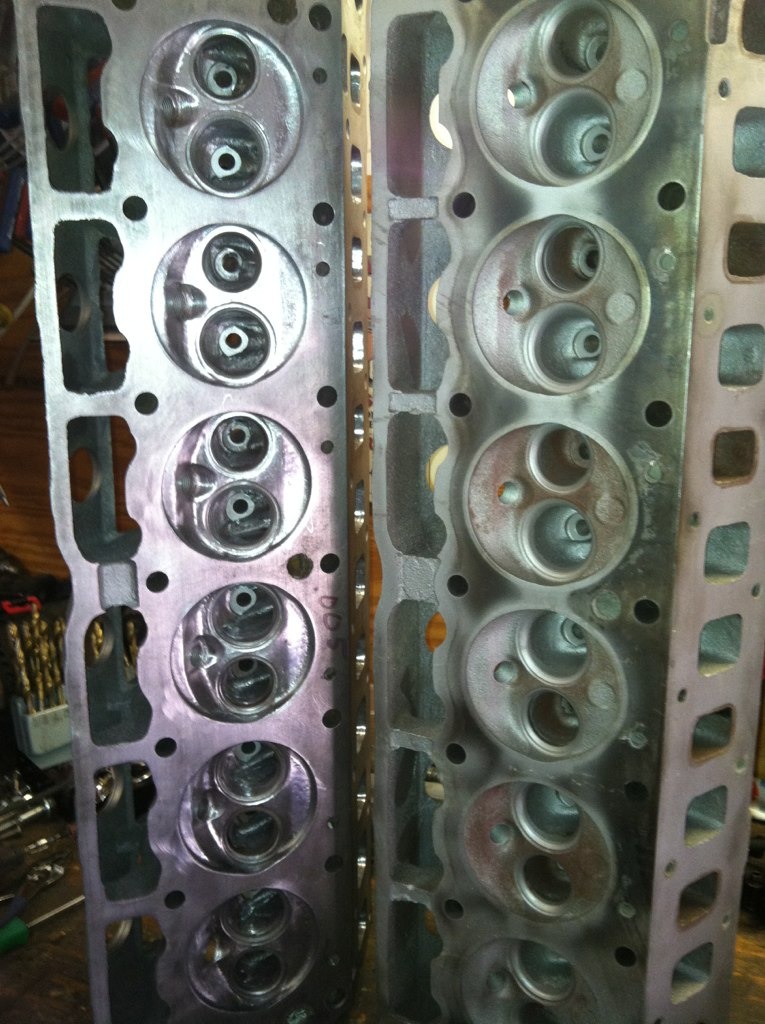

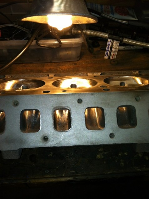

    Sorry haven't been online ... Motor parts should be coming back from machine shop next week .. Found a deal on a 2500 stall conv they should be here Friday cams are still at Snyders getting a regrind .... Haven't see anything on paper on a race date at firebird but they are getting the place cleaned up Nice here's some pics of little port work we did ImageUploadedByH.A.M.B.1379468980.822031.jpg ImageUploadedByH.A.M.B.1379469004.516990.jpg
