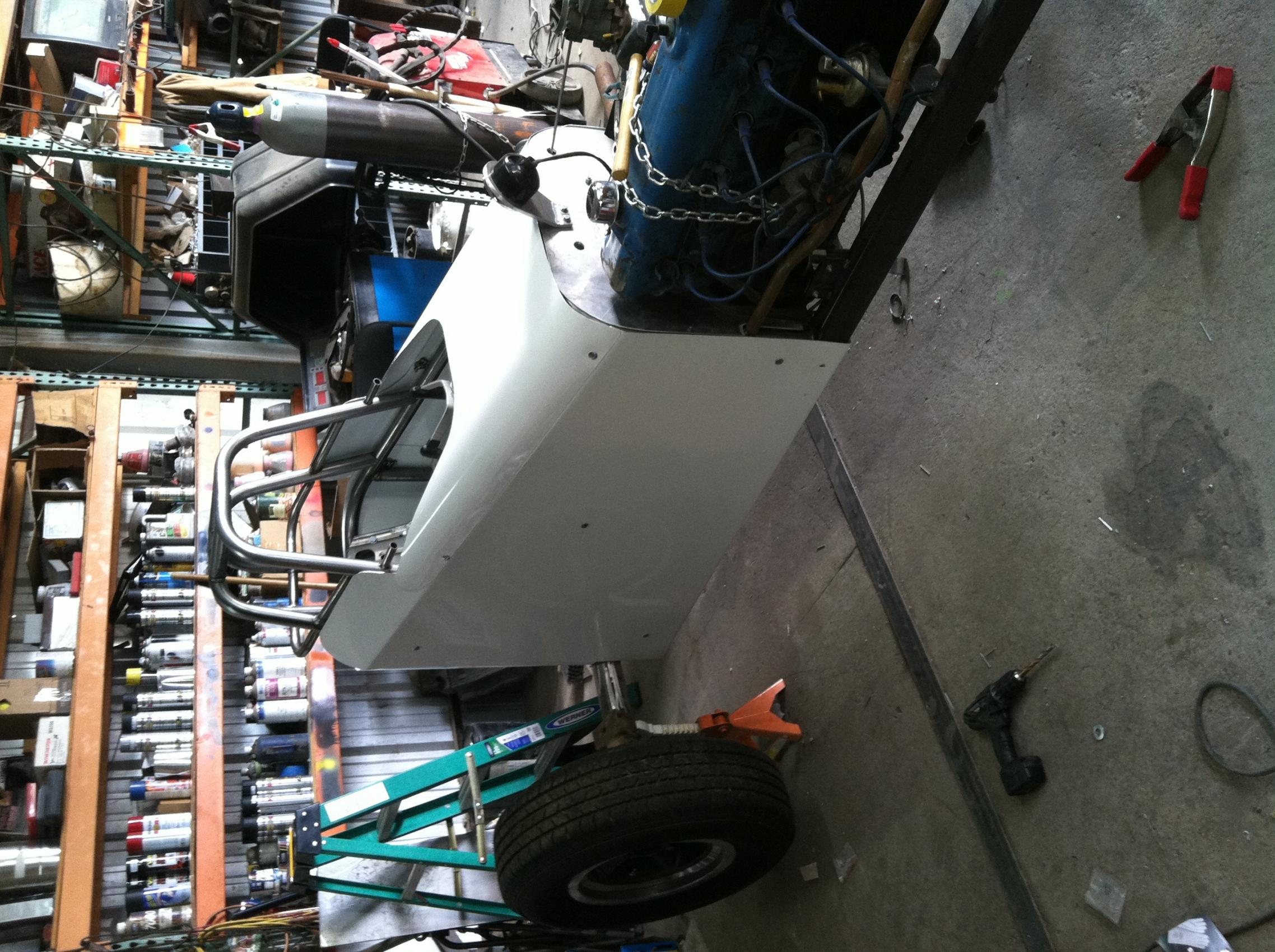

    car#2 pics floor almost the same as car #1 frame 2" narrower cage #2 shorter and car same wheel base 129" ..... on a side note we put car #1 on the scales and full of fuel and no driver it weighs 1408 .....:eek: the boys drove it around the house like 10 times and running good so they say :D

    We put a 4 kick in the frame so the motor sits lower in the frame rails by doing that we get lots of leg room. . Car # 2 has a lay down seat in it so we lowered the top cage bars .. Makes it nice to sit in but little harder to get out of .. Thanks for all the good words guys ..
