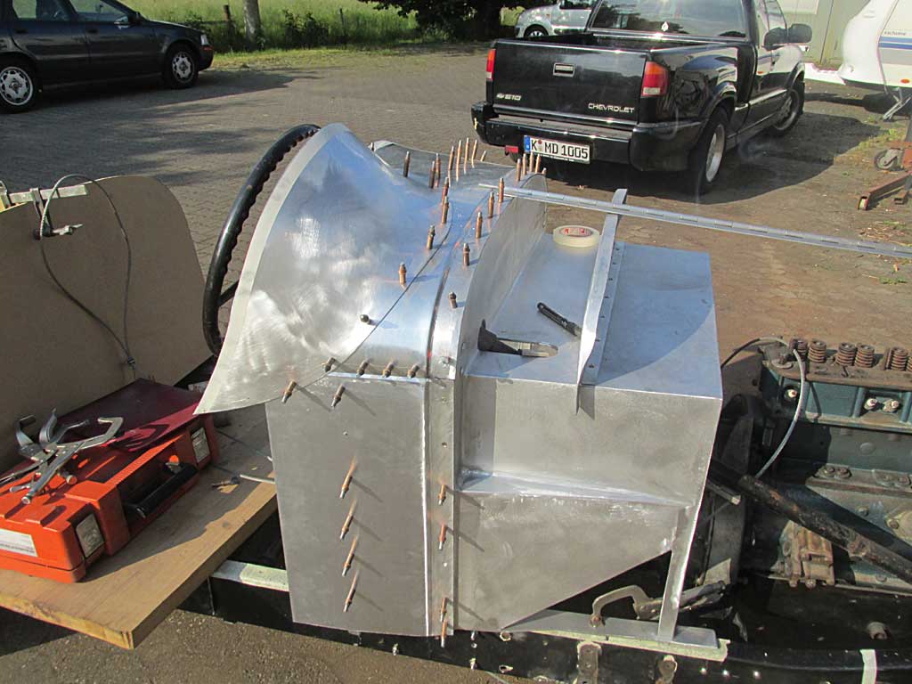

    Rover_3.jpg I'm in the process of building a Rover Special for a customer. It used to be a Sedan but the body was way beyond
    repair. I moved the engine about 210 mill further back for better proportions.
    Now started building the body. First welded up the firewall from 5 mm Aluminum. then made up the structure
    pieces from 1.5 mm sheet and the skin from 2mm.
    Have a look yourselves...

    Very interesting. What are you using for the frame, suspension, etc.? Gary
  24. marioD
    Joined: Nov 20, 2005
    Posts: 231
    marioD
    Gary - its all stock! It's the original 6 cylinder engine/trans and the original frame.
    All needs to be reworked though... Surprisingly frame and all mechanical parts are in very good condition.

    Forgot to say it's a 1937 Rover.
