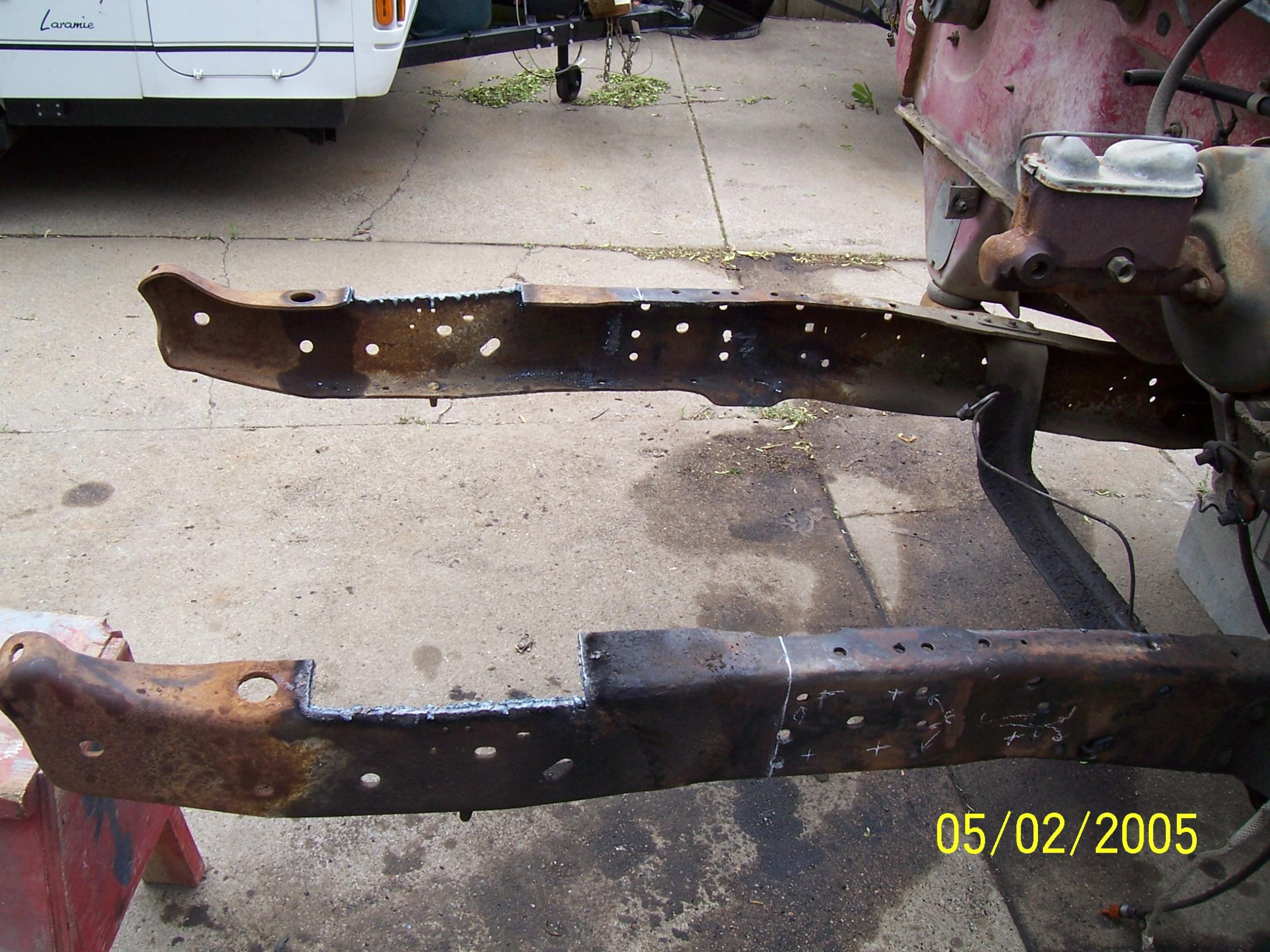

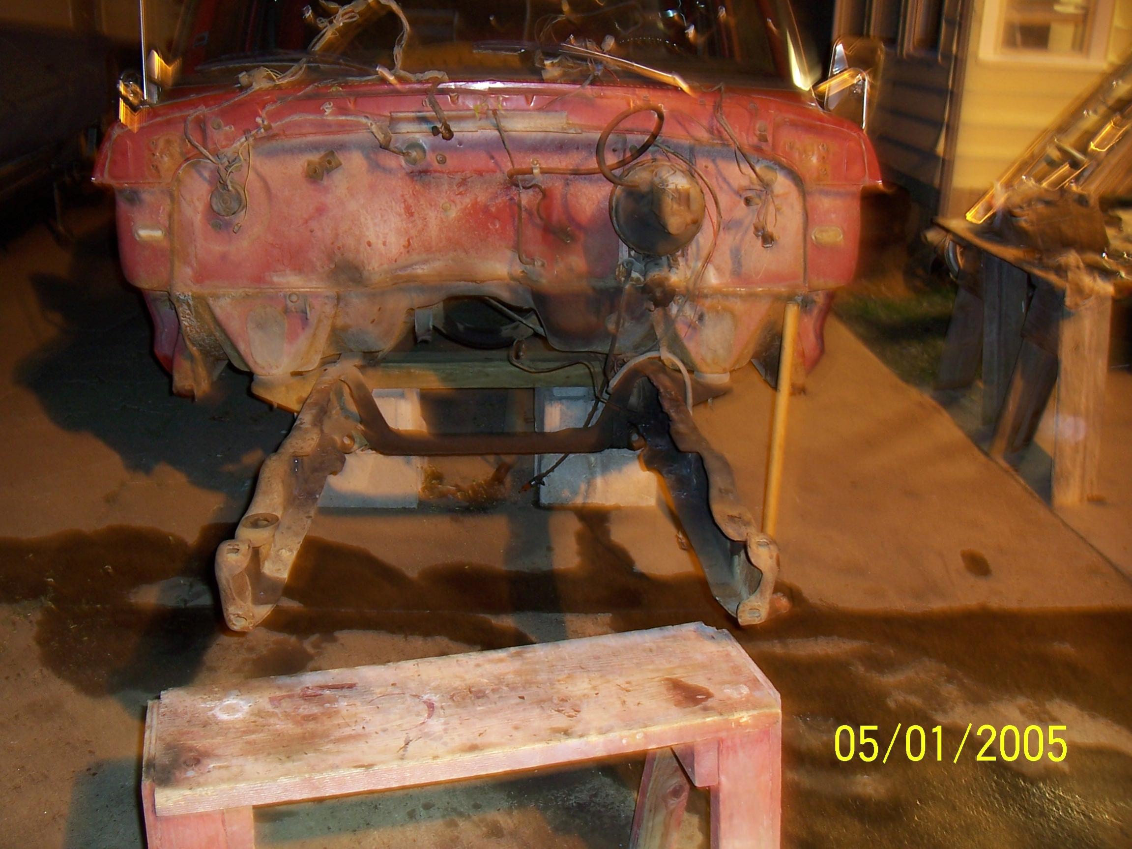

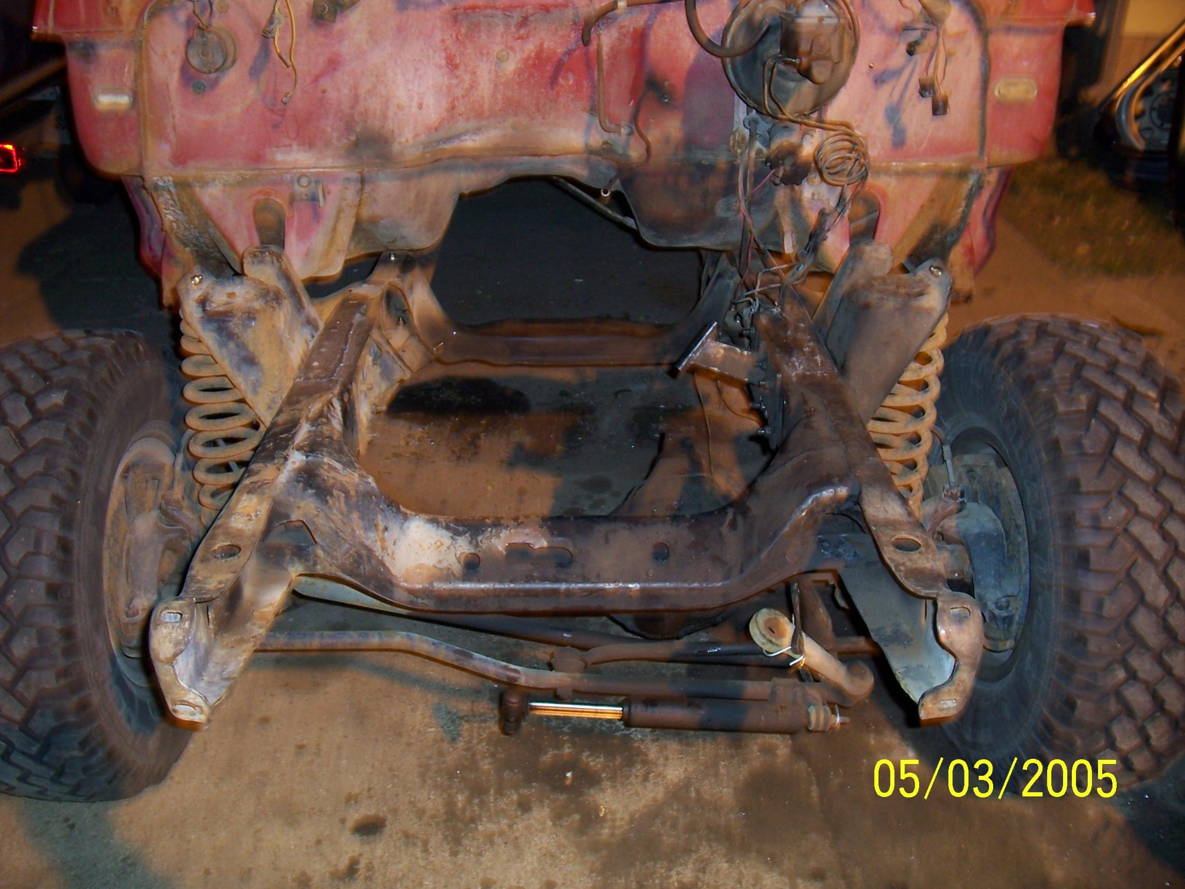

  26. Scorch67
    Joined: Jun 6, 2009
    Posts: 85
    Scorch67
    from Omaha, Ne
    before you do anything make it look like this, the stock crossmember will only be in the way
    I put a solid front axle in mine but it's a 4x4. You can see the frame rails are pretty simple once you surgically remove everything else.
    Dont know if you'd want to mess with 4x4 coil springs and trailing arms to suspend a drop tube axle.
    I'd think it's be best to run a dropped axle with radius arms, coil springs, panard rod and a saginaw box with front steer.
    Most of the undesirable ride and control traits present in a solid axle front suspension are coming from the leaf springs, not so much from the axle being solid or ifs. A coil sprung trailing arm solid axle front end is pretty dang smooth and accurate.
    My 77 f150 4x4 cruises 70 mph with your hands lightly rested on the wheel. I've never had a leaf sprung 4x4 ride and handle so good.
    That twin I beam front suspension does get squirrely if anything is worn but for sure it goes down any potholed rough old road way smoother than any of my chevy trucks
    I'm also with what the others have said..that crown vic setup is a really nice way to go...
