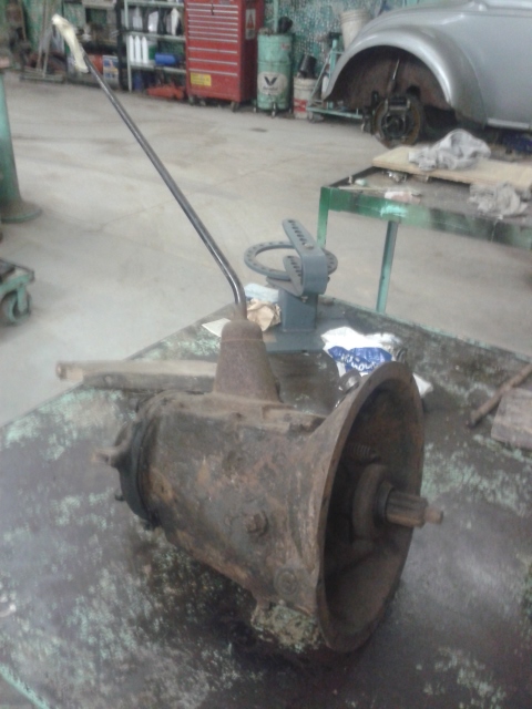

  10. Dropped by Algoma56's place this afternoon & picked up the gearbox from his 34 Victoria, was great to meet up, swell guy, very helpful, looks to be the exact same (slanted shifter base).
    I haven't had a chance to check the internals on the transmission from Algoma 56's yet, but I'm hoping the internals look better than than the one I opened up this morning that was in my Grandfathers old barn !! YOWZA !! Don't think that gear set will be any good !

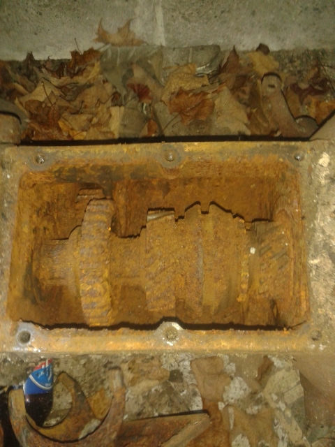

    Pictures below are the old flathead & internals of the transmission that was in my Grandfathers old barn - the motor & tranny had been outside for many, many years before being moved inside... hard to tell eh ? ha ha ha

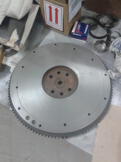

  12. Found a local machine shop to turn my flywheel, thought I should get it cleaned up... the machinist that turned it is a guy that grew up in my mother's neighbourhood, is currently building a 55 Chevy & actully seen Snewpee years ago... needless to say he was the perfect guy for the job & had an appreciation for it !
    a little progress all the time... plus I start 2 weeks vacation in 5 more days !

  18. This weekend I was busy with family pictures, company party & childrens christmas party so time was limited, however I did have a chance to take the top cover off the new transmission, there was a small puddle of water on top of the very old gear oil that had settled into some form of jello like state, then just typical sludge in the bottom, currently it has a 1/2 gallon of varsol in it to loosen everything up, so far it looks really promising, typical "rubbing" on the square cut 1st gear, but no missing or chipped teeth I could see for the few minutes I had to inspect. So far, so good !!

  20. Got the spare transmission torn down today, much better shape than the other one, appears to be exact same "era"as Snewpee's transmission - even has an intact Syncro ! ha ha - I will send pictures to Vanpelt for review & then go from there !

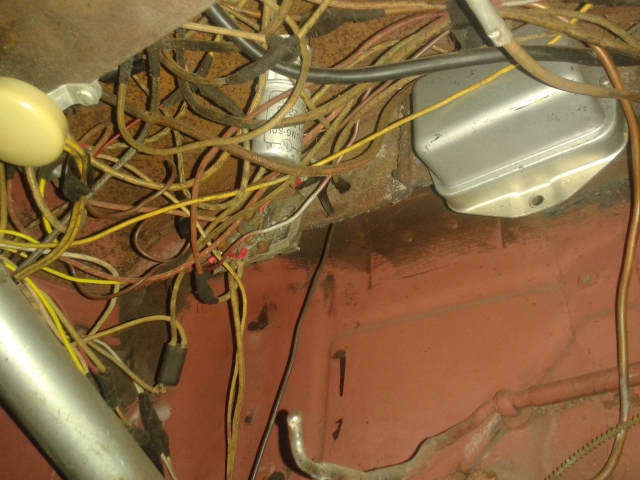

  22. ha ha - would you use this wiring harness ? Started removing this afternoon once I took the seats & floor carpet
    out... already found 3 "rubbed" wires... & a vintage unopened KFC "folded fingerbowl" along with a metal comb & a 1962 & 1964 nickel..

  23. studebaker46

    what is your plan of attack on wireing. That looks impossible to sort out. Tom

  24. Ya I don't think there was much of a plan when it was wired up in the early 60's by a couple of teenagers ! Whewww I knew it was bad, but the more I got into it today the better I felt about choosing to replace the harness instead of repair. I'm trying my best to preserve the car, but I thought it was foolish to use the existing harness & risk an electrical fire & loose the car, over something nobody even sees, aside from the engine wiring, which I ordered a cloth generator harness for - the harness is a basic 8 circuit 6 volt vinyl harness from Rebel.
    I work in Electrical Maintenance for a living so having bad wiring harness wouldn't bode well :), I plan to reuse as many switches etc. as possible, and will install new regulator, solenoid etc.
    I traced the wiring for the column turn signal & headlight switch today, labelled & made up sketches before disconnecting, hope to finish the old harness removal tomorrow & get the new fuse panel mounted... wanted to do this job when I had a few "clean" days to work on it, not fun walking away from a wiring job part way thru...

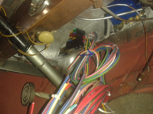

  27. "Out with the old"...
    and very close to "in with the new"...
    I couldn't get the dash out thanks to the fixed column, plus I probably would have destroyed the capillary tube for the temp gauge... I'm dizzy from staring up under the dash... wheew time for lunch :)
