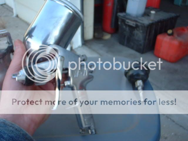

    I was planning on shooting this single stage (whatever I select) with a small touch-up gun similar to what Overspray is using in his thread (http://img34.photobucket.com/albums/v104/overspray/DSCF0136.jpg), since these are pretty small parts. It's a gravity feed (non HVLP). Any recommendations that may persuade my selection one way or another? Will I have problems using a non HVLP gun with any of these products?

    Don't confuse yourself with nonHVLP and HVLP especially with the little guns. Gravity feed is a type of HVLP, in that it uses less air because the fluid does not need to be siphoned up with air, thus it is more efficient because the air only has to atomize the fluid, which feeds to the spray tip by "gravity". The small gun I use is very efficient and was even my most used gun in the body shop for production work. A painter is always spraying small parts, small areas/jamming, and the small gravity feed gun was a time and material saver. That one in the post "Shootin' a Track T-Garage Paint 101", has a 1.0MM tip which is somewhat in between a "touch-up" gun and a larger gun for color. It will atomize well down to 15psi at the tip which really lessens the "overspray" while not using the "Volume" of air required for HVLP guns. For spraying suspension parts, even frame rails, it will save material and produce a nice finish. Key to this, is gun settings and reduction, which is easy to "dial in". The small gravity feed will probably apply paint at a lesser film thickness, but just add 1 or 2 more coats to get the thickness. Transfer efficiency of the little gun will still save a lot of material. Super good "bang for the buck" for a $50.00 gun.
    Chinese copy of an IWATA

    YEP! Mine is just like the purple one in that picture. So you think a regulator setting of 15 psi is good?

    The little purple gun has an orafice or spray tip about half the size of the copy cat IWATA. Going from .6MM to 1.0MM is a big difference. The smaller tip won't work well painting a frame or suspension parts. It's too hard to get enough paint on the part when you have the smaller "hole" to put the fluid through. It's still a good gun, but for much smaller areas. If you don't get enough paint on the part (film thickness), you decrease the durability of the finish. The 1.0MM tip is just more versatile for small to medium jobs. Smaller guns will perform or atomize more efficiently if the paint is reduced slightly more, therefore you will need extra coats of paint/material to get the required film thickness for durability of the final paint film.
    I prefer to have the air pressure adjustable at the gun, even though I do use the same set-up you describe to set my initial pressure. In 50 feet of hose, the pressure will drop by friction loss, so from your adjustable regulator to the gun it will drop 5-15psi at the tip of the gun. Final pressure regulating at the gun just gives more control, especially when painting irregular shaped objects and contours and smaller parts and areas. It really saves walking back and forth to the regulator. The small guns need a finer adjustment to get the pattern even and efficient. Painting a car is different with large panels and not much variation needed in air pressure.
