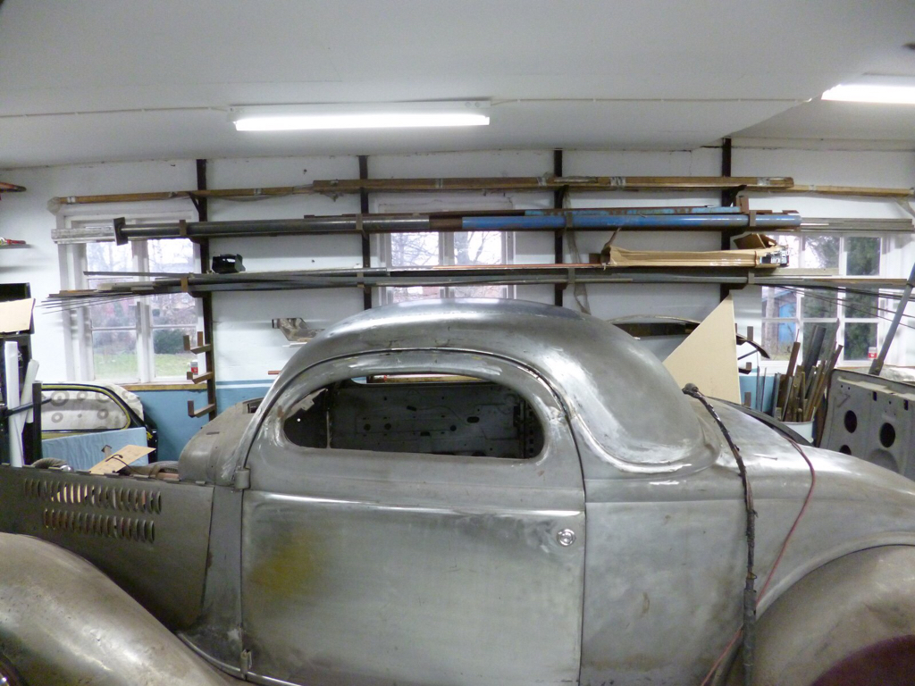

  1. I think I need to aspire to a perfectly round shape like the bare metal version. Even better than the other chopped version. I have a lot of catwalk to work with so It may be do able down the road. Due to my elongated cab I may not be able to get that shape though. I see myself doing it like Sledge though. Getting it drive able first. I'm itching to see it on the road in primer. ImageUploadedByH.A.M.B.1427083244.768160.jpg

  3. Almost always, I can get more candy and info for my eyes by comparing pictures. I cropped these down first to wheel base, then body line, then dropped everything forward of the hinge. The pics aren't at the same angles, so it throws it off a little but if you had a pic of your car at the bit lower and more square photo of the brown car we could do it again.
    On the brown car, I notice the profile of the roof is almost the same shape as the door. Those lines flow well.
    If your mind can blot out the window, you'll see the shape is nearly the same, in the roof line its bigger and slightly rotated down at the back. Maybe you see the door as being slightly up at the back. Again the flow here is awesome .
    Now if I look at your car in the same way using that pic, I get a bit lost because the flow is off and relationship between the door and roof isn't there.
    Just my .02
    Love this build !

    I think, and I don't it well sometimes, that if the window/door line was cleaned up at the rear and you could then get the top to match your unusual window shape it would really enhance the tail dragger stance. It would give a tear drop shape to the whole line. Lower, longer, sleeker to the rear. I can't believe how far you have come with this. There s so much you just had to work out as you went. You're getting close, don't let a few more fixes do you in!

    Yes, If you clean up the top rear door/window line them match the top to that I think your eye would start in the front and just flow off the back. I think it would support your window treatment, you know harmony.:)
  11. Lowcoe, pick something to follow and stick with it. You might decide to do a bit of both to the roof and the door- because not only should they work together, the need to work with the rest of the car.
    Get the guys on the photo shop thread to help with a visual aid. They are awesome guys and incredible talent.
    Uh-huh! Excellent flow of the lines on this one.
    But Don't get thrown off proportion wise by the 5 window layout.
    See how the roof line hits the decklid in relation to the fender/line opening? This sort of establishes the length of the back of the car, or at least how long it looks
    Can you see how or where the slope/curve of the roof - if continued would end in relation to the fender?
  13. I think if your eye sees the perimeter of the two windows as just one big window it matches the roof very well.

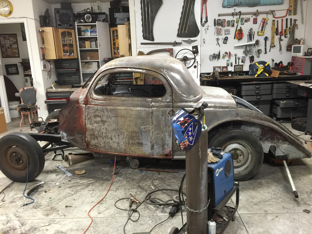

  15. Prolly over posting but here marks the last of the rust repairs on the passenger side. Tried to make it purdy for the camera. Started the other side too. The PO had braised in a repair and even to my low standards it needed to be redone. Apparently he restored 6 36's........ ImageUploadedByH.A.M.B.1428286517.428178.jpg

  23. Thanks Ron. Got the cowl patch installed on the drivers side. Then tackled the passenger door top. My first attempt was pretty weak but I'd like to think that I've learned a bit since then. I used a donor top to get something that looks halfway decent. I like the shape of the first try and I think I'm gonna stick with it. I will need to add some filler on the back edge and the back part the roof definitely needs a haircut as discussed but it's progress. Im still haven't finalized the floors because I'm struggling with direction on the front end. ImageUploadedByH.A.M.B.1429405507.967492.jpg

  25. Here's a couple versions of the door and roof from the nice guys over on the photoshop thread. Both have extended the cab back about 4 inches onto the catwalk. The first one is mainly just squaring off the window. Second is Kenneth's cab on my car :).. ImageUploadedByH.A.M.B.1429672937.466492.jpg
  26. Wow, two sure does sweep nice. Which one do you like ? This car deserves to make you proud. There isn't much you haven't touched. You're the man. Happy hammerin' brother.
  27. Blue One
    Joined: Feb 6, 2010
    Posts: 11,462
    Blue One
    from Alberta
    Both have a nicer roof profile and side window shape than what you have so far.
    I like picture 2 the best.

    Man I've stared at those 2 shots for about 20 mins now and I can't decide. The second one flows more (better?) but something about the first one I really like (refering to the roof lines)
    As far as the windows go I like the first one
  30. Thanks Kid, welcome back...
    I like them both. I'm still kicking both around..
