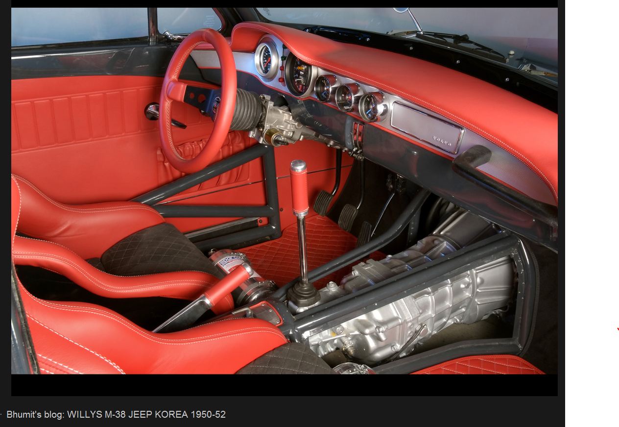

    I think the fresh bread smell when it got warm would drive me crazy!:D
    Nice job on the tunnel and firewall bracing. Makes you want to use lexan to cover it so you can still see it all...

    Thats sort of the plan, the floor is going to be colored lexan. Just in the drivers compartment the trunk will have a sheetmetal floor. And all the bread will be stale by the time I get this car on the road.:D

    Man I really love the Idea of the Lexan floor and the trans tunnel looks great. That will be wild.
