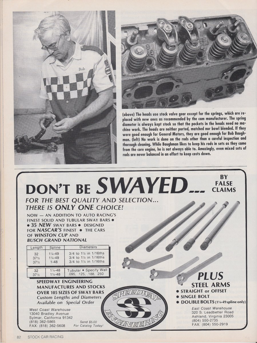

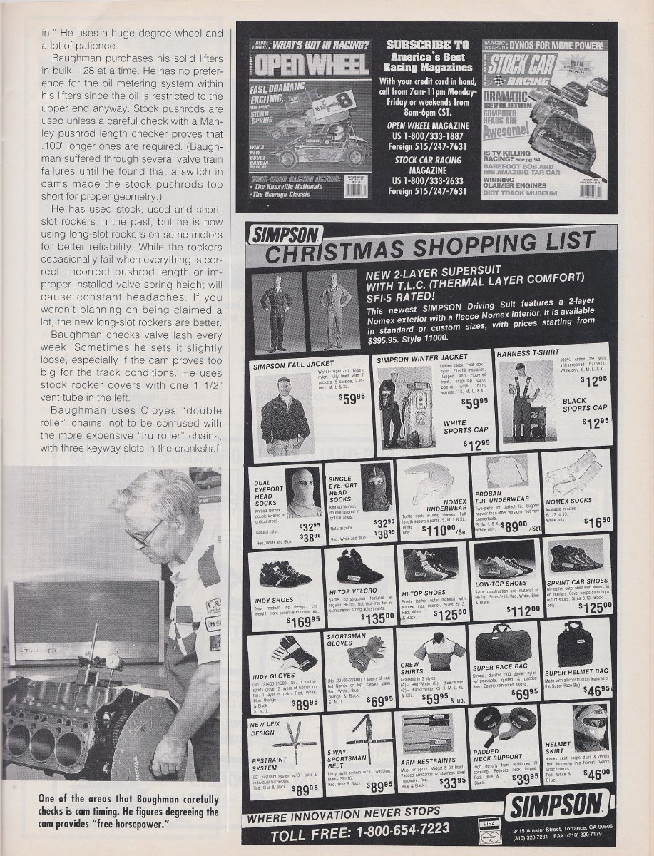

    If its ok with Old Wolf, I'm going to add this here for the "scrap it and buy a crate motor" crowd (not that they will actually read it:rolleyes:). And this guy isnt putting these motors to the local cruise night and leaning a cry-baby doll on the fender, he us running them to 7000 rpm at the end of the back straight 50+ times a night...
    Not saying I would necessarily do this, but it kinda puts the "you need" stuff in perspective...
