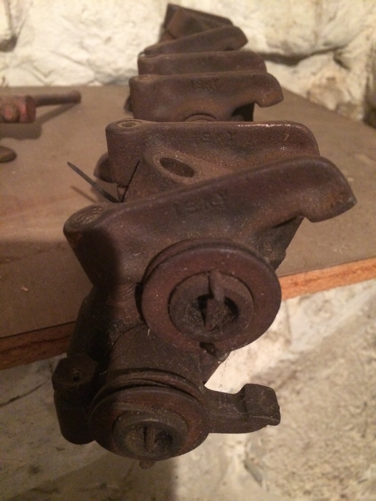

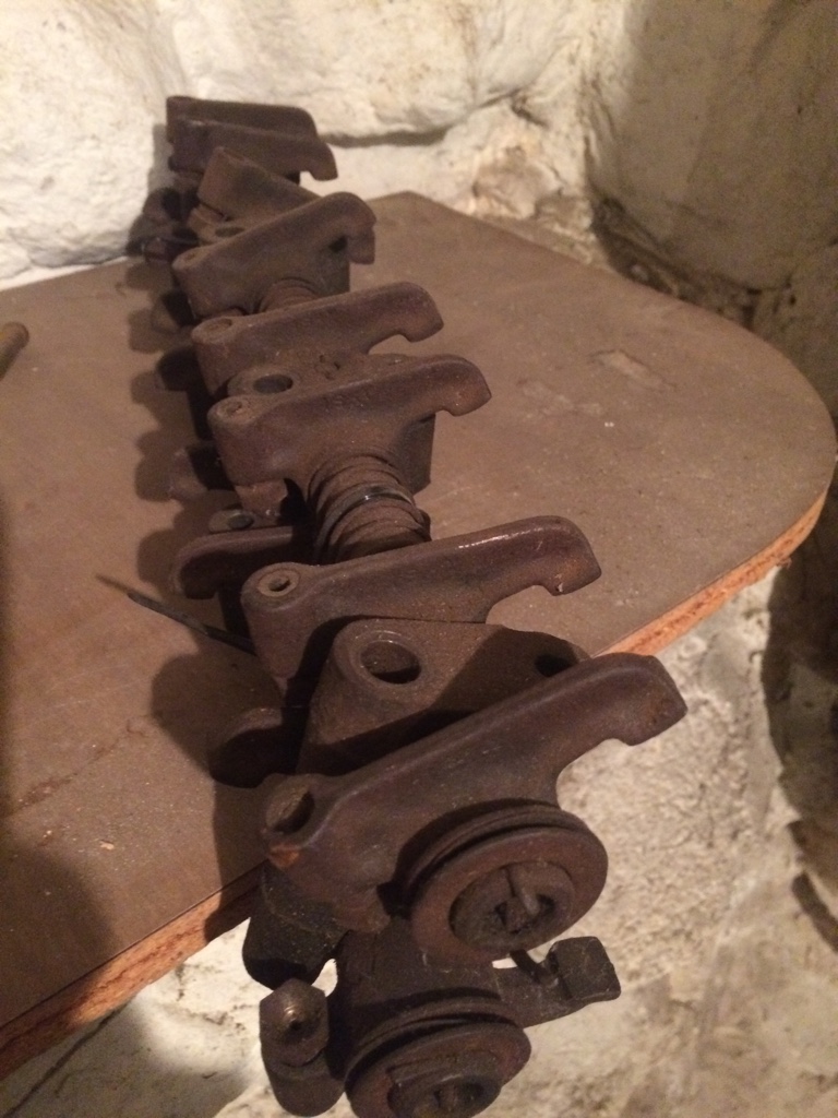

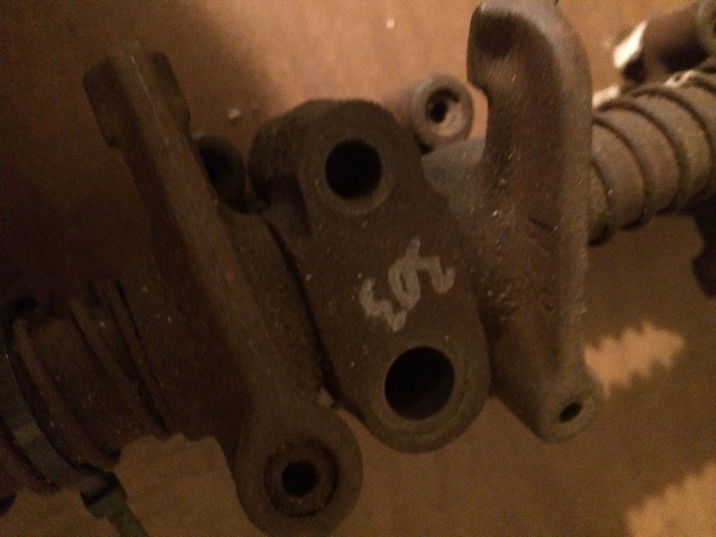

    I have a set of adjustable rockers that I pulled off an Olds 303, is there a way to check what ratio they are by measuring?

    Is this the the measurement you're referring to or are you just playing hard to get?

    On my 1.8s the shaft has a clearance notch for the large bolt.

    yes of course a rocker ratio can be measured.
    divide the distance from the center of shaft bore to valve tip contact patch by the distance from center of shaft bore to center of push rod cup.

    One thing to consider. There's lots of reports about guys breaking old school 1.8 adjustable rockers, my hunch is this is down to running them on modern cam lobes with aggressive hydraulic intensity numbers. I haven't cam doctored my E-3, but I have cam doctored an E-2, it had a hydraulic intensity number of 48. That's pretty gentle by modern standards, For comparison, the modern Comp Cam lobe in my truck has a hydraulic intensity number of 32, and the most aggressive flat tappet lobes can be down in the high 20's.

    I'm not sure I would even bother running them, I was mostly just curious. If needed I'll buy a set of adjustable pushrods and use my stock rocker arms. I still need to strip the motor and send the block out to the machine shop to see if it's salvageable. I turns halfway then gets stuck. I've had the heads and pan off and cleaned out some of the rust that was in the cylinders but it still needs a little persuading. Thing might be a boat anchor.

    Here's a couple pictures. Pretty grimy still but you get the idea.
