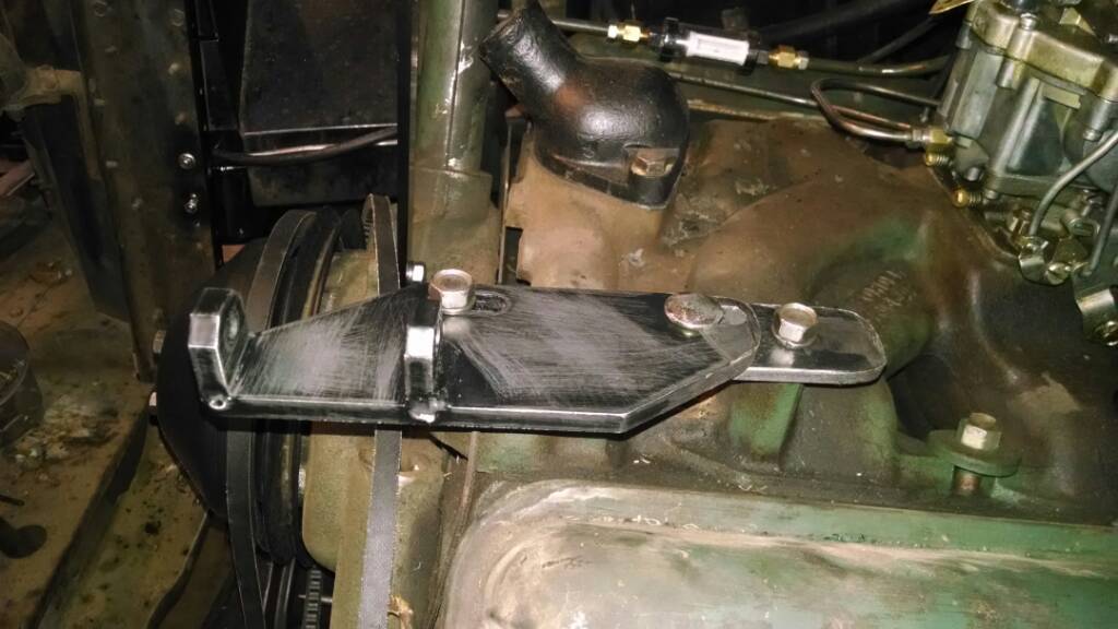

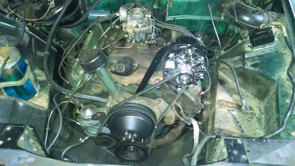

  4. OK.I tried the alternator bracket from a 54 Chevy I-6.with minor modification and a adapter plate on the bottom it worked like a charm .the top adjusting brace is from a corvette setup. This mod uses the same belt as the original generator. There is plenty of adjustability and room over the top.no clearance issues here : )
    jakespeed63 likes this.
