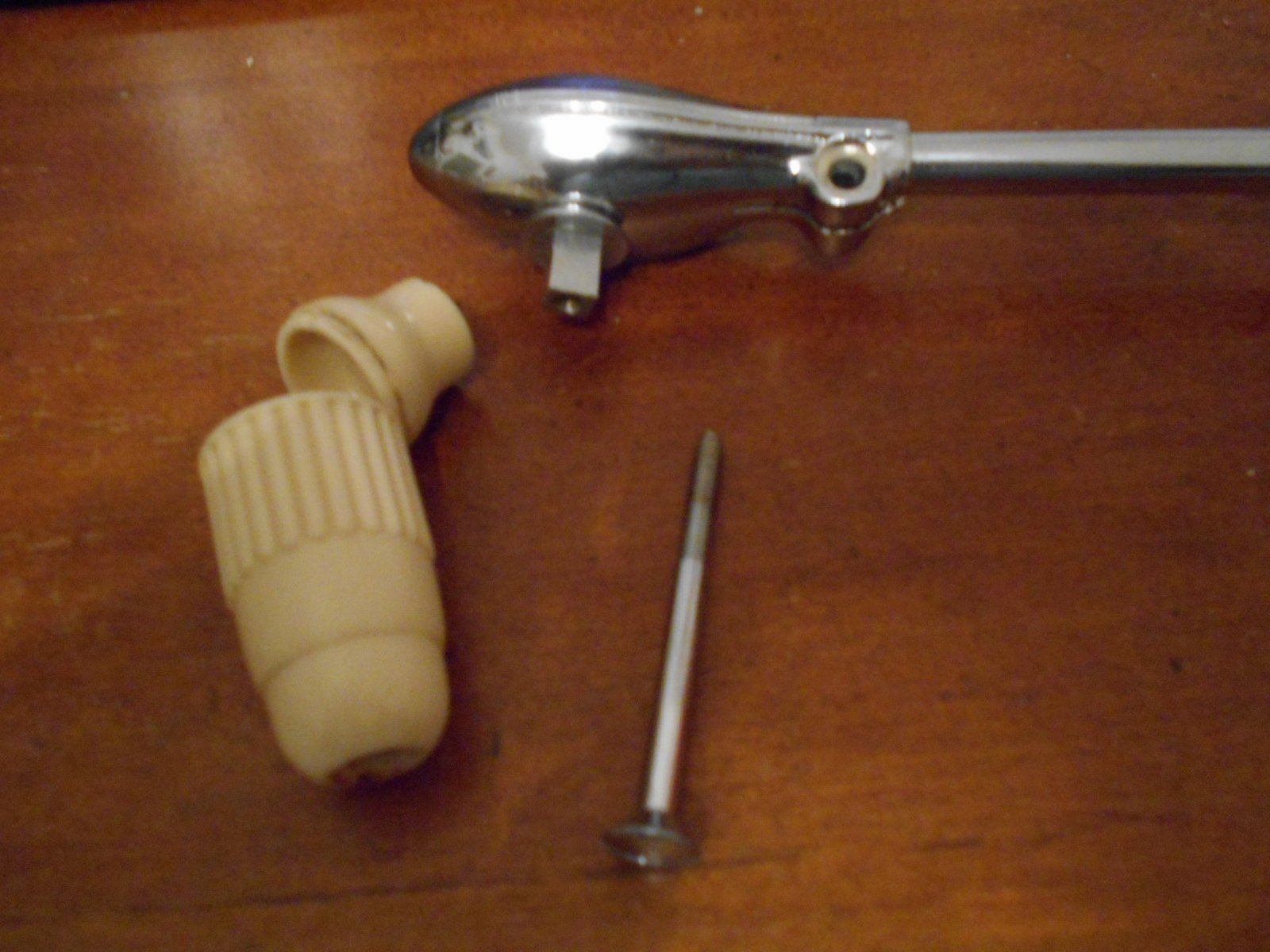

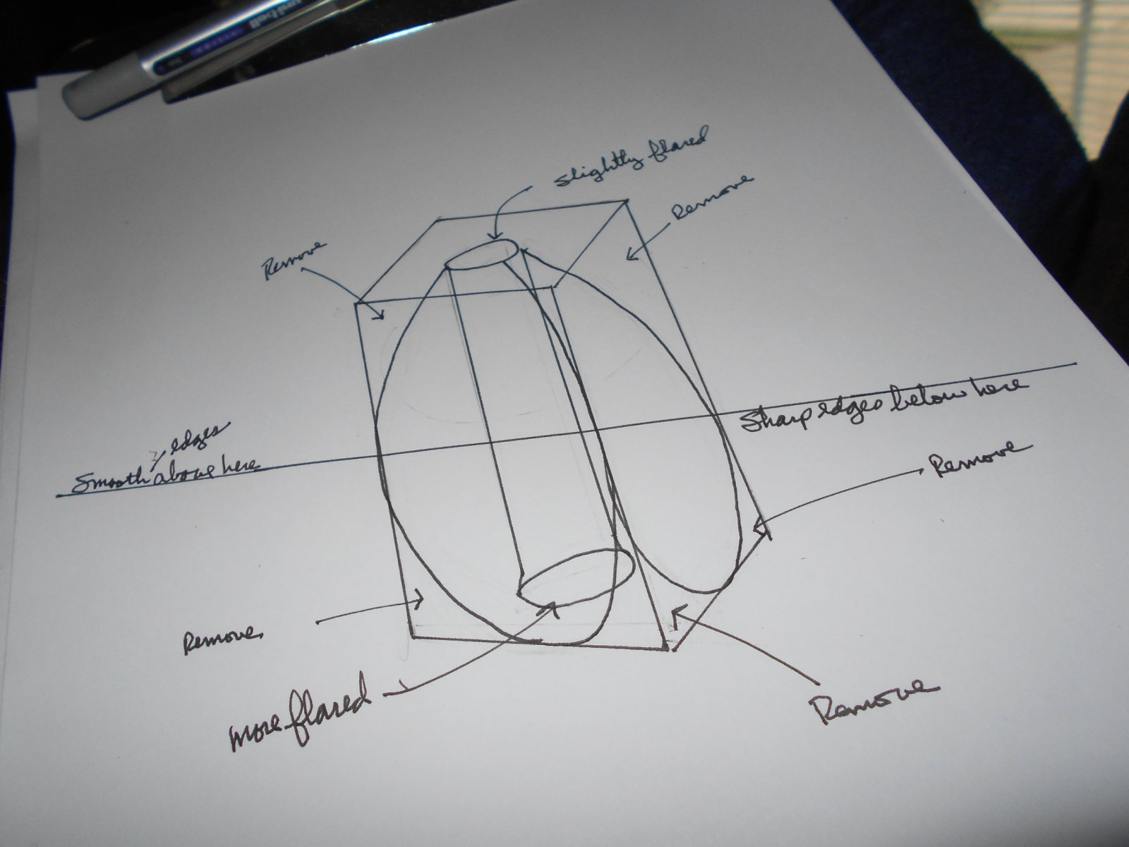

  16. jivin jer
    Joined: Sep 14, 2008
    Posts: 3,321
    jivin jer
    002.JPG 001 (3).JPG 001 (3).JPG Unfortunately I haven't assembled the (in the ruff) pics for this like the knobs, but we will press on, and I'm sure you'll get it.
    This shows what we have to deal with regarding the various components to this part of the project.

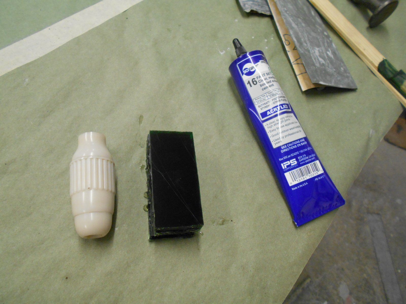

  17. jivin jer
    Posts: 3,321
    jivin jer
    007 (2).JPG A hole must be drilled thru the block, excess material needs to be removed. I ruff out the pear shape on my bench grinder, then use my hand held grinder with a cut down 40 grit disc, and finish up with finer and finer grades of paper on my da.

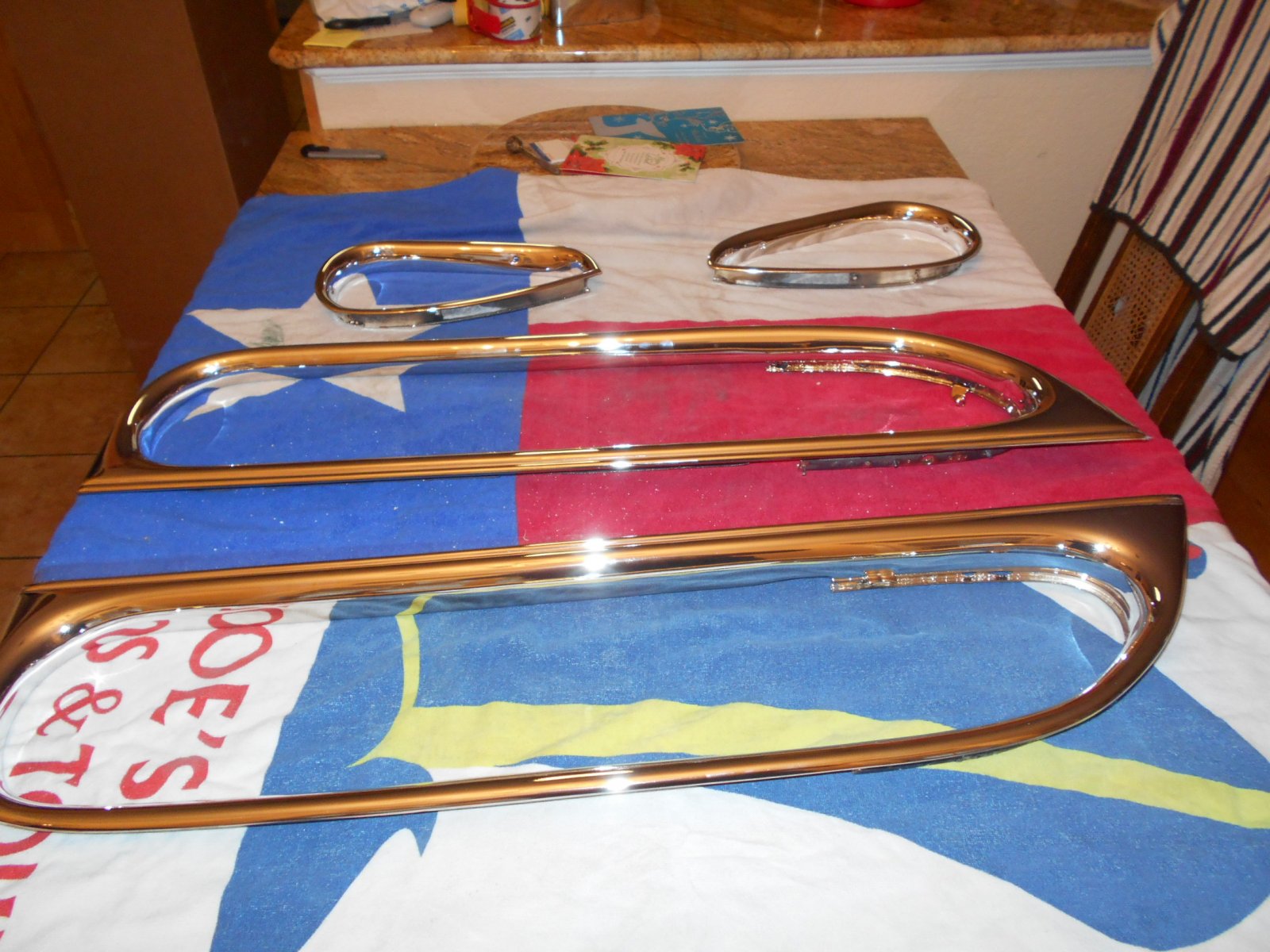

  24. jivin jer
    Posts: 3,321
    jivin jer
    001 (9).JPG 001 (3).JPG 002.JPG 002.JPG Everybody remembers these? Well, they look best when they're installed.
    daddio211, Eric H, drdave and 3 others like this.

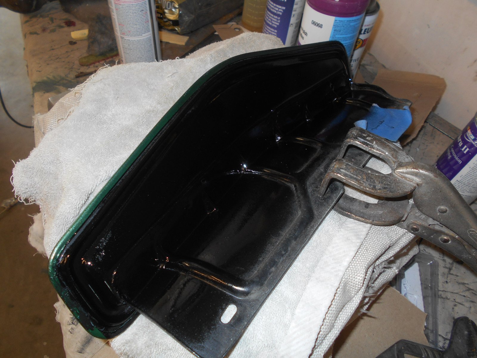

  27. jivin jer
    Posts: 3,321
    jivin jer
    343.JPG 343.JPG 344.JPG 345.JPG It was better to have Don redo these than make new ones. They still need to be handled with kids gloves.
    Well I need to keep this from getting too boring. With an advanced case of CRS getting everything together requires patience and a plan b always at the ready. With two weeks before "the big shew" everything is looking good. I have a new seal in the vent hole, and cleaned up the part that you rarely ever see.
