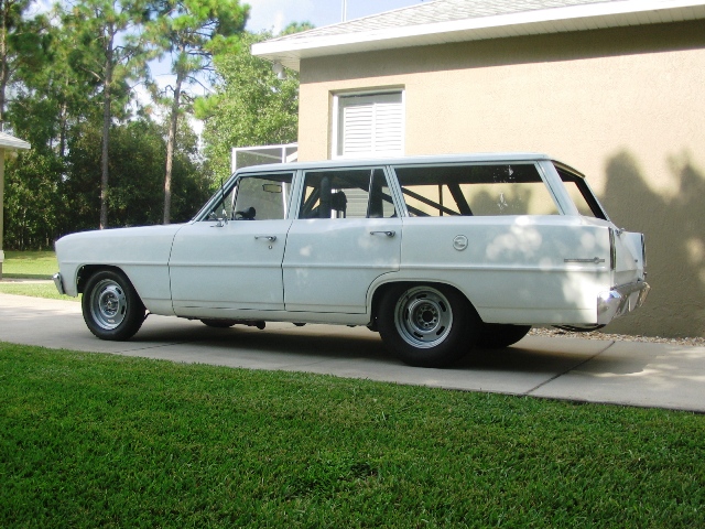

  15. RainierHooker
    Joined: Dec 20, 2011
    Posts: 2,031
    RainierHooker
    from Tacoma, WA
    Nice, I've always had a soft spot for wagons. Probably stems from my childhood family vehicle being a '60 Chevy Parkwood. Lots of grear memories in that thing. That, and I've always loved first-gen Chevy II's. When the other half mentioned, "I'd like to have a Chevy II like the one I had in High School," I replied, "how 'bout a wagon." We started looking that day...
    I'd love one, I painted a Rainier logo on my aircraft when I was in A'Stan the first time, a few years ago...
    Alas, I don't think it'll fit the theme of the build this time around.
    Anyway, I got the distributor all adjusted to TDC and the like, apparently in my haste and grumpyness last night I had it a little off. Also I really need a new positive battery cable, one of the ends is falling apart and when you crank it, it arcs pretty good. Definately cause of a week spark. Off to the Auto Parts Store I go...
