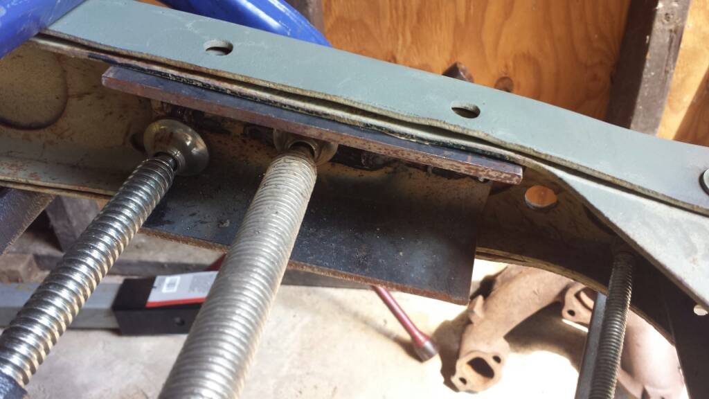

    Boxing plates from WelderSeries wrap down the X rails to stiffen the frame at this juncture. I'm not gonna have mega horsepower, just a SBC. I will scallop the ends kinda like the hatching shows.
    Yes it is the dreaded M2, but I had nothing to start with and gradually pieced together all the parts. A spindle from E-bay, a R&P core at the swap meet. Crossmember is from JW Rod Garage.

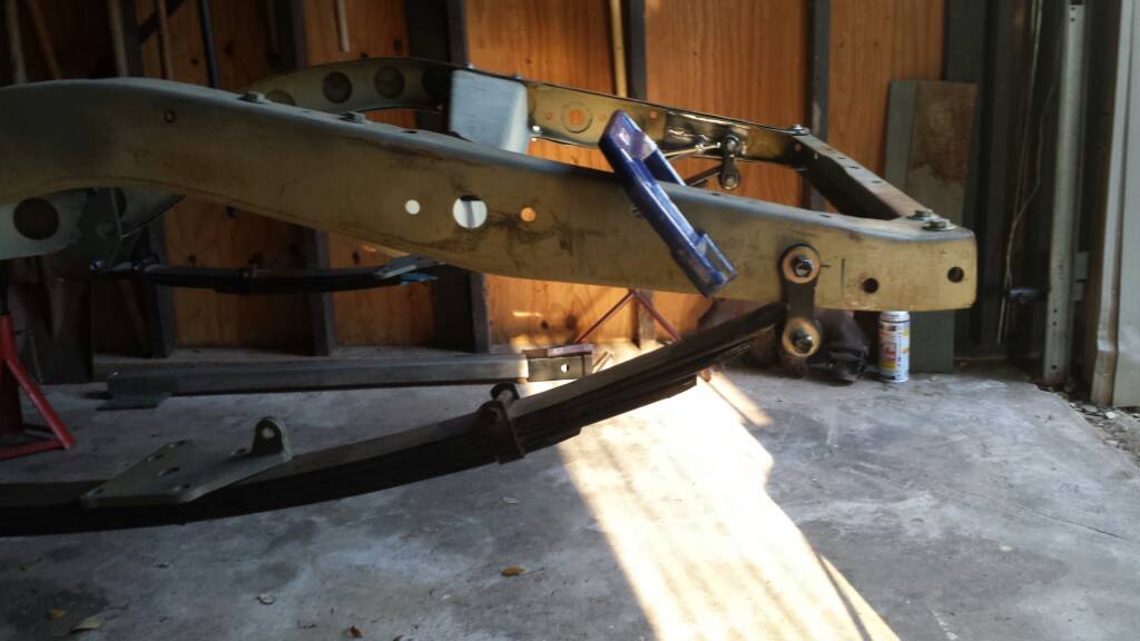

    brought the frame out from storage to our house after cleaning out the garage. gathered a few parts and started bolting. Felt good. Got the TCI rear spring brackets mounted. I will fab some new rear mounts that attach through the frame, rather than under it thereby lowering the rear about an inch. this is the way the SAC kit was, but I didn't buy one before they went out of business. 20160223_195356 (3).jpg

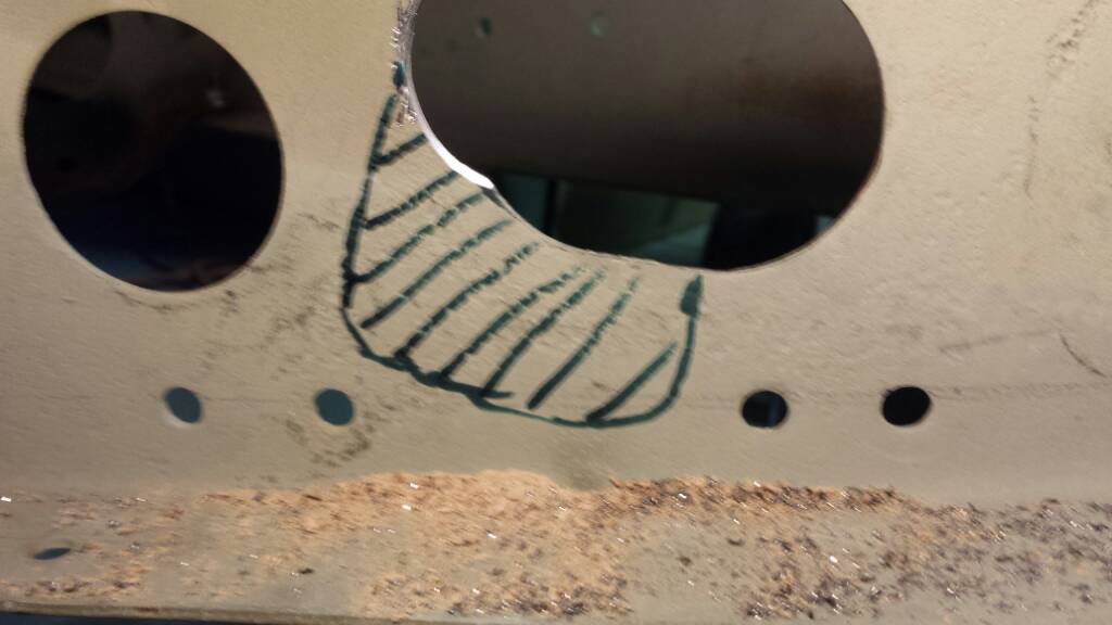

    So, I'm using a frame cobbled together (Thanks Austin Speed Shop) from several 35 - 38 donors. I want to use a '40 pedal and clutch bracket, but it goes "thunk" (picture 1)and the bolt holes don't line up. HMMM... I found a nifty little cutting template here:
    http://www.classicperform.com/tech_articles/Pedal_Power/Pedal_Power.htm
    and backed up the cut area with a piece of scrap wood. Using a hole saw, I made a couple of clearance cuts and smoothed them out. By jingo it worked!
    [​IMG][​IMG][​IMG]

    No torch or plasma work, but it still came out. Next to get the bracket bolted up and begin making the master & clutch cylinder adapter plate. To work with a hydraulic clutch m/c, the original pedal will not do, as the clevis point is above the pivot and pushes toward the front when you mash the clutch. This is fine for a mechanical clutch, but my NV3500 trans is hydraulic and the clutch fork sticks out on the other (passenger) side. Instead of cutting up the clutch pedal, I had a small inspiration. While piddling around with the original assembly, I happened to put the brake pedal on the clutch pivot. Bingo! Clevis point is now underneath and works the right way. I scoured out another brake pedal (Thanks Junkman JR!) and will hopefully post up the assembled bits soon.

    I've never liked the way the TCI kit brackets hang below the frame. so I made some through frame brackets like the old SAC kits. Some 3/16 plate bent at tapered angle to fit inside the frame rail and some tubing with the same ID as the TCI brackets. this raises the rear spring mount 2" and the axle 1" I hope to not have to use spacer blocks to achieve a proper stance.
