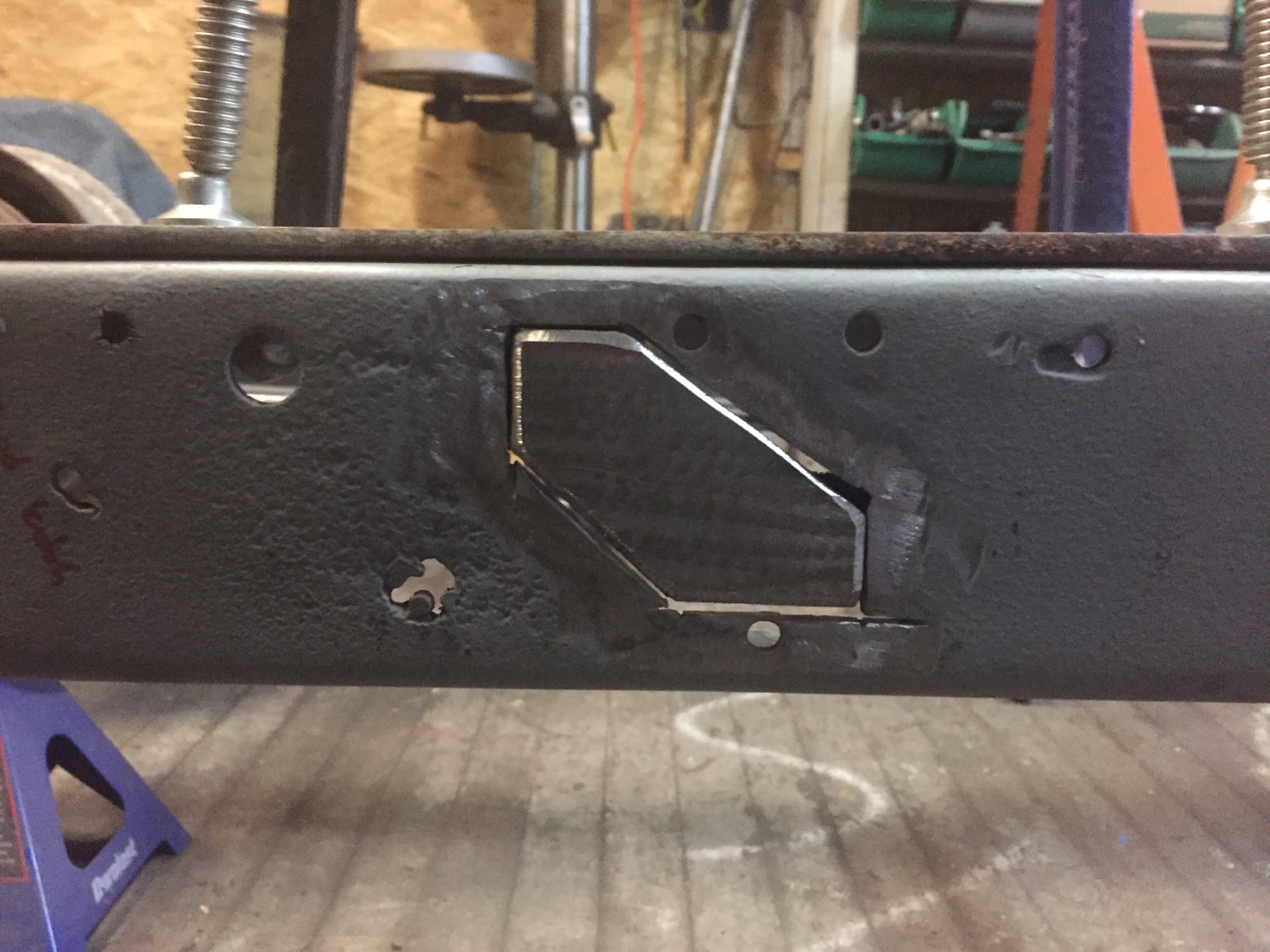

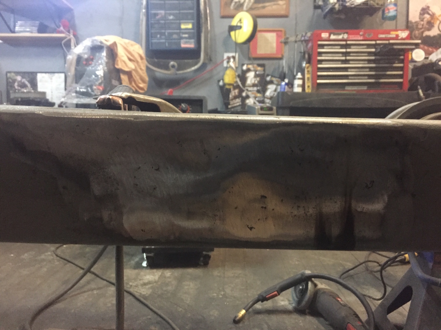

    Got some things off my check list this past week and weekend.
    Got my radius rods fabricated w the added 1-1/4" DOM tubing. I ended up figuring out (afterwards) the larger tie-rod ends have a larger shank on them than used in the tapered mounts I bought. So I had to hunt down a reamer and reamed them out so they fit.
    Got that done and got things fitted up I welded things together. Moved onto the frame by removing the tabs someone had welded on for some type of radius rod/4 link setup at some point before I bought it.
    Cleaned those up, filled the banger motor mount holes with plugs I made from some 3/16" plate. Filled the added steering box mount someone torch cut back when. Filled an exhaust pipe relief someone cut into the frame on. It's top and bottom sections of frame rail.
    Filled sanded, filled sanded fender and running board bracket holes down both sides of the frame...

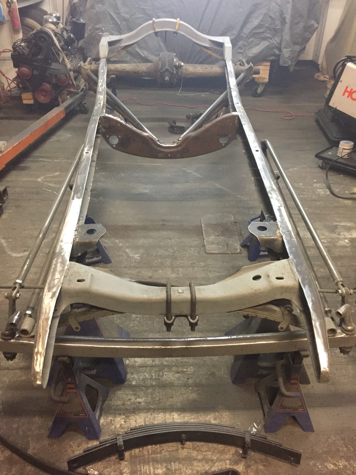

    Been a few weeks since I've posted anything. Been picking away at things cleaned up the frame a bit more.
    Got the F1 crossmember mounted for good finish welded my radius rods.
    Finally got the front spring/perch/shackles figured out. I used the main leaf on a 31" reversed eye and used the leafs from the orig spring I purchased with the axle. Minus the #2 leaf. (I don't like those plastic sliders) [​IMG] (I need to shorten the lower leafs and put my rebound bolts on the spring )
    Got the hairpins mocked up and the mounts tacked onto the frame. Had to modify the top tube by removing the last 1/2" of thread so I had equal thread showing and equal adjustments if I need to change my caster in the future. [​IMG]
    Axle is at 6-7deg with weight on the spring. Mounted some cycle tires on the 40 steels and set it on the ground. [​IMG]
    With the weight on the springs my frame has a 3deg rake. I'm pleased with the stance at the moment.

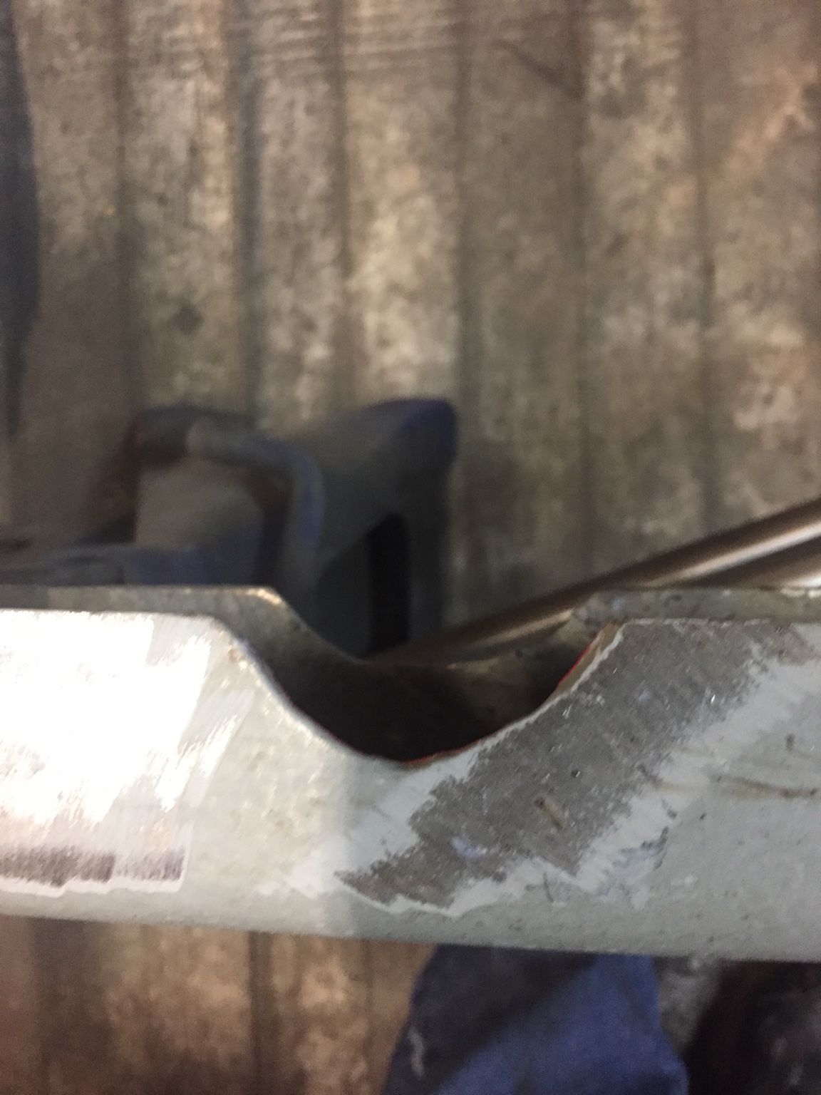

    Ups dropped off all my Brake parts for the front today and also my wheel bearing kits for both ends as well as a few boxes of other things I need to keep moving forward.
    Time to start researching how to channel this thing ...
