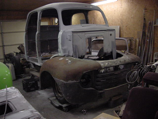

  1. Here are a bunch of pics that is a condensed progress on my 49 Ford COE project from about the last month. Follow along the description with each pic. I already have the COE body, now I just need to mount it on a chassis, I am not using any of the stock frame or drivetrain. This is a low-budget build, trying to use existing parts and not spend any real big money.
    First have a good buddy give you a suitable donor chassis. Tim (TERPU) had this 74 GMC, and only wanted the 454 and turbo 400 back. The chassis was mine to use, I drove this home and started disassembly.
    Stripped the GMC down to the bare chassis. Lots of pressure washer and engine cleaner and now I had the rolling chassis ready, note I kept the brake booster and master all hooked up, gonna use that as-is, along with the GMC's inside swing pedal assy:
    Next, take my wife's 37 Chevy coupe apart to get the 350 SBC from it, a good runner, nothing beyond stock. The 37 is going to be built up Westergard style, but here it is getting ready to start stripping the chassis and minus the engine and trans.
    Next, after making a deal with Tim to keep the turbo 400 trans from the GMC, I gave him a slip-yoke 400 instead. This enabled me to use the driveshaft and not require any custom work. Some cleaning up degreasing and bolting to the 350 which also was degreased and cleaned up, here is the COE's drivetrain:
    Hereis the engine and trans mounted in the chassis. The engine and trans mounts are the same as the 454, so it is an easy bolt-in:
    Once the chassis was ready, time to put the COE body on, start trimming metal and mock up the location. Trimmed off about 12 inches from the front of the GMC frame, and lots of sheetmetal from the COE inner fenderwells:
    This is the inside cab, the firewall is about at the front of the engine, and will have pretty serious trans cover:
    Finally, here is a shot with the hood just set on to show the overall look. The suspension needs serious lowering, it will sit much lower when finished. but I need to get it all mocked up and need to get the body mounted for sure, then do the suspension:

  3. Forgot that part, it will just be a flatbed, cheap and easy, will be about 10.5 feet length.

    Richard, the suspension is not even compressed at this point, it is sitting all the way up. The front sheetmetal is channeled somewhat already, that is what i cut all the inner fenderwells to allow.
    Burger, the engine cover is not actually that bad, it will be tight, but I actually think it will be pretty good room. The floorpan can be flat until almost at the bellhousing, then it just needs to go up and over the distributor and carb and around the heads.

    Update, the brake booster and master cyl are mounted on the firewall under the hood, it fits fine. This is the exact one fromm the 74 GMC chassis donor. Used the same swing pedal set-up from the truck as well.
    Steering right now I think I can use the stock box, just need to get one of those high dollar U-joints for the angle between the box and column. Will find out for sure this weekend.
    Boones, there are truck turbo 400's that have a bolt-on yoke, kind of like a rearend yoke. With the caps and all, the driveshaft must have the slip yoke. Think of a front driveshaft on a 4wd. Car versions have the slip taken up by the yoke sliding in and out of the trans.
    Flt-Blk, I just sold the 59 El Camino last weekend at Turlock. To a guy from Sweden believe it or not, it is going overseas. Yes I still have the 51 GMC COE and that will be made into a car hauler, but several years out until that gets worked on.
    The 49 Ford COE will be my daily driver soon as I get it running. I will post more progress pics once I get the more photographic stuff done. Cab mounting, brake and steering are not too exciting of pictures to look at. That is what I am working on recently. Thanks for the interest from everyone, it will be fun once it is up and running.
