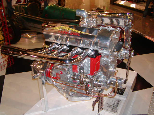

    As always, thanks for the wealth of info- here is a pic from Speedy Bill's of the Fronty DOHC that I was thinking of fashioning the Quad4 after- The cam cover would need to be reshaped, and the earlier 2.3l Quads had valve covers without the indentations that could be used, or fabricate new ones with the Frontenac logo. Anyway, I know it's a stretch, but would give me the "look" of a Fronty without selling my kids into indentured servitude and the reliability of a newer drivetrain.

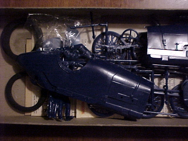

    Here is a bit of a flashback for you Mac, and maybe a first time viewing for others. The Aurora Monroe Special was part of an Indy Car series that came out in 1958. I might ruin the value of this kit and build it some day.:D
