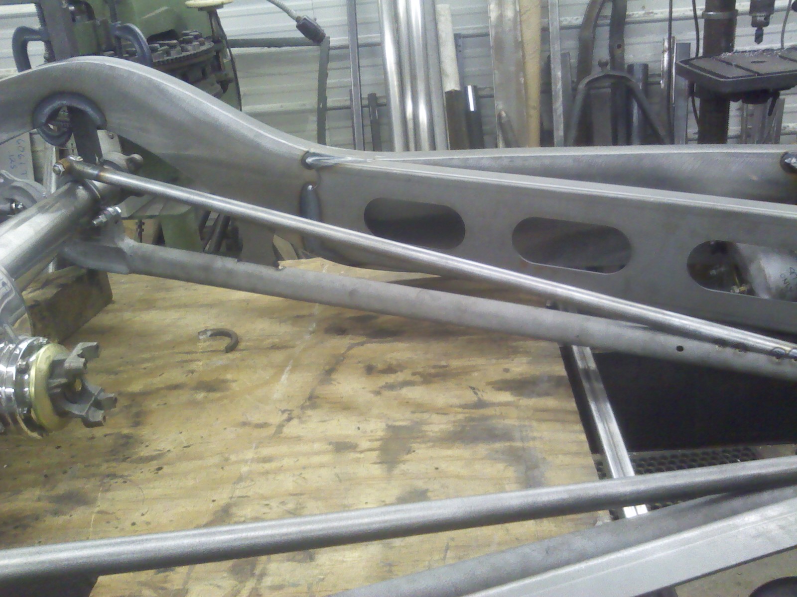

    I assume youse guys are running them with a torque arm? Or in a ladder bar configuration?

    Cool! I over-built the snot outta mine, then.

    Wow! that looks impressive,... well if they are prone to failure,... you have all the basis covered. :D

    These two are all I can find at the moment.
    This one is a 392 / TH-350 / 9" Bronco
    My sons old T project, 302/C-4/8"
    I can look to see if I can find any more pictures,... but these will have to do at this time. I am actually still looking for "Failure pictures of these bones"
    As in all suspension set ups,... spend a lot of time setting up your geometry, before you do any finish welding.
