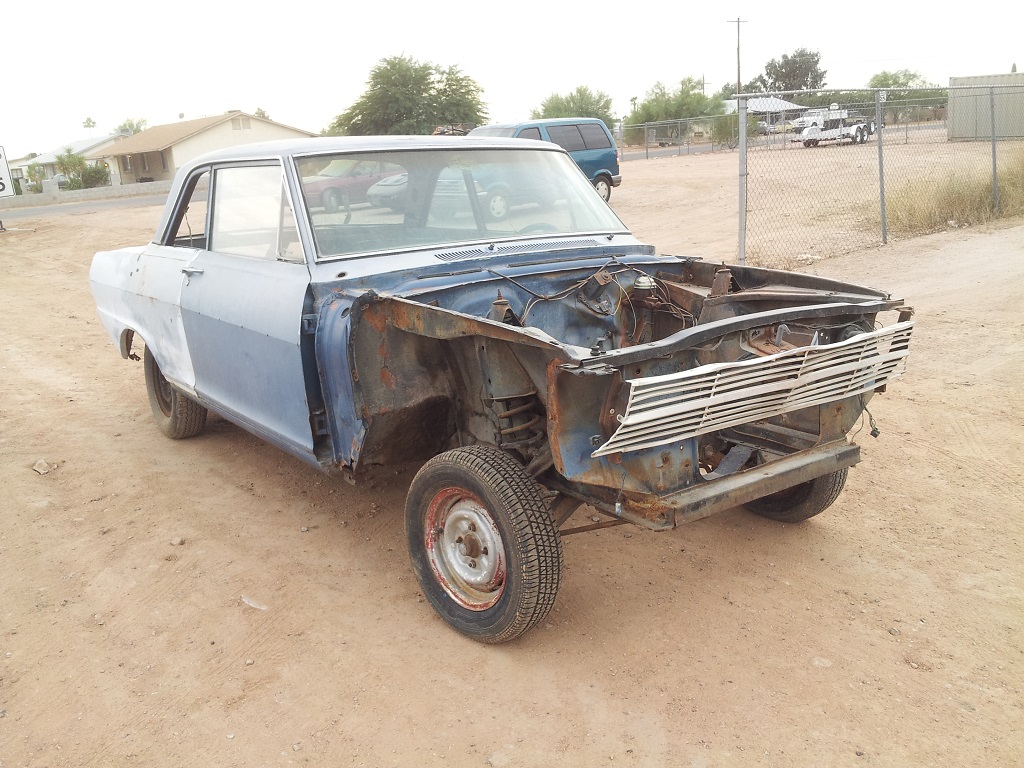

    After talking it over with my copilot Dan on the way home from Drag Week, I decided I need to build an early Chevy II. I looked around for a while, and finally found a 62 2 door sedan, in rough, incomplete condition, for $500. It was pretty much on it's way to the crusher if I didn't buy it.
    Thanks to good friends, I found some parts in nearby Bisbee to fill in most of the missing stuff....hood, fenders, good used windshield, trunk lid, lights, etc.

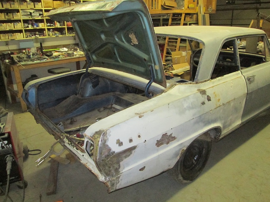

    First thing was to get the car back into a solid body shell, so I could make the racing modifications. The right quarter was just tacked in place, and it was pretty obvious that whoever worked on it didn't have much of a clue. It's a hardtop quarter, on a sedan...but they cut off way too much of the original quarter panel. Here is the corner of the car after removing the quarter
    There was some damage to the trunk floor and the rear subframe. They cut off the corner of the trunk, although it was still attached to the leaf spring. Very strange. I cut off part of the frame rail, straightened it out, and welded it back togther. I filled in some missing pieces.
    Then I put the quarter back on. The trunk lid and door almost fit...fortunately it's a race car, not a show car, so precision gaps aren't too important.

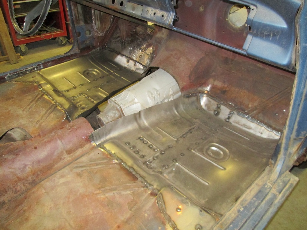

    Once the quarter panel was back on the car, I started on the front floor pans. I got some new parts from Sherman...US made.
    First I cut the old floor out, leaving a little extra around the edge for further trimming. The front subframe was welded to the floor, this is pretty much what holds the car together.
    I plan to run a TH400, because I know how to make them live behind a blown big block...and I have a few laying around. The original powerglide trans was half a foot shorter than the 400, so I had to move the trans mount back, and enlarge the trans tunnel. I decided to re use the original crossmember, because it's a nice strong lightweight design, and it was already there, so it was free. I discovered I could move the crossmember mounts back about 4" by just removing the spot welds, sliding it back, and re welding it.
    The new floor pan tacked in
    I did the same on the driver side, but I had to add some new metal at the bottom of the firewall, to get rid of all the rust.

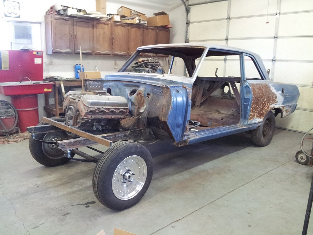

    Moving on to the front of the car, I had to do something with the front suspension. The original suspension is mounted on a bolt on clip...which is actually several parts that bolt together. The sides consist of a frame rail, with inner fender panels, and the control arm and spring supports. There are a few crossmembers and other such parts bolted on to the side assemblies. I liked the look of the original frame rails hiding under all that crap...they are strong, light, and I already own them. So instead of making or buying new front frame rails, I decided to just use the originals. First I removed the original suspension, then I cut all the old stuff off.
    I decided to use a straight axle kit from Speedway. I could have spent some more time and figured out how to piece something together...but I doubt it would really improve the car, or save much money. I did spend some extra money to get the willwood brakes, because I don't really want to try to stop with 9" discs, and the weight savings will help performance.
    The first mock up of the leaf spring on the frame rail.
    I decided to put the springs at the outer edge of the frame rail. I also decided to put the rear hangar at the back of the frame rail. The shackle ended up right at the front. The axle should end up right around four inches forward of the original location, once the weight is all on the springs and they flatten out.

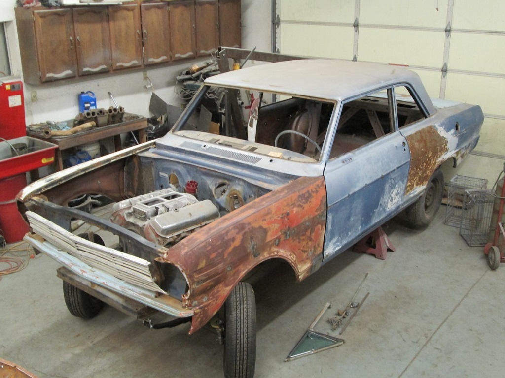

    With the parts assembled, the car is sitting on the front suspension...so it's time to drop a motor in there and see how it looks.
    I jiggled things around to get the engine just ahead of the firewall, with enough room to get to things and allow the throttle linkage to fit, etc. I levelled the carb base and transmission pan to the rocker panels, and centered the crank and trans tail so they have the original offset of 11/16" to the passenger side. When I decided it all looked good, I made the mounts. They are pretty simple, just a tube and some strap. I used an NOS rubber GM mount for the passenger side, and an old solid mount for the driver side. The trans mount is rubber.
    The Centerline wheels are the only rollers I had laying around...don't worry, they'll be replaced one of these days....

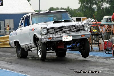

  18. Looks like a lot of fun. Are you going to alter the wheelbase any to get some of that bbc weight onto the tires?

    I plan to move the rear wheels forward somewhere around 8 to 11 inches. I haven't decided yet....what do you think?

    I think 10" looks the best, but it's going to need wheelie bars even foot braking it. I moved mine 8" and had an old pumpgas 454 and it only ran 12's on vintage pie crust slicks and it still did a small wheelie.i

    Next thing is, you'll be fabricating a weight bar/box to hang on the front end to try and keep it on the ground.
    Best thing is to build/buy adjustable wheelie bars that you can attached with Grade 8 pit-pins so you can install and remove them quickly.

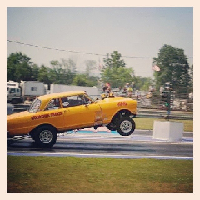

  29. Not sure how far up Dan's rear is, but it sure does wheelies ! Here's a side photo to see the wheelbase change.
    <iframe width="560" height="315" src="//www.youtube.com/embed/WjL57SCCP9Q" frameborder="0" allowfullscreen></iframe>
