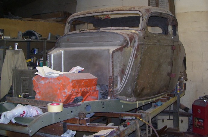

  30. My 34 after using a product called "phix"...phosphorous acid. And it's true...welding is a bitch after using this product.
