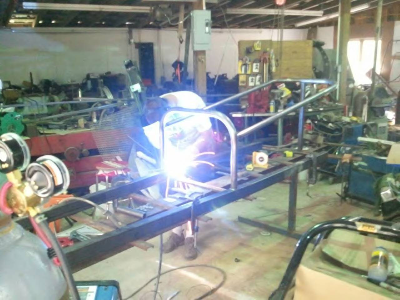

    Well finally got started on the chassis and had a great day. Got the firewall bar in and the upper frame around the shoulder in and a lot of lay out work. So glad to get this thing started finally. Partner is gonna post some pictures soon.

    These are some of the pictures.

    Nice start, I bet you are glad to see tubing going togeather. I sent you a PM.
