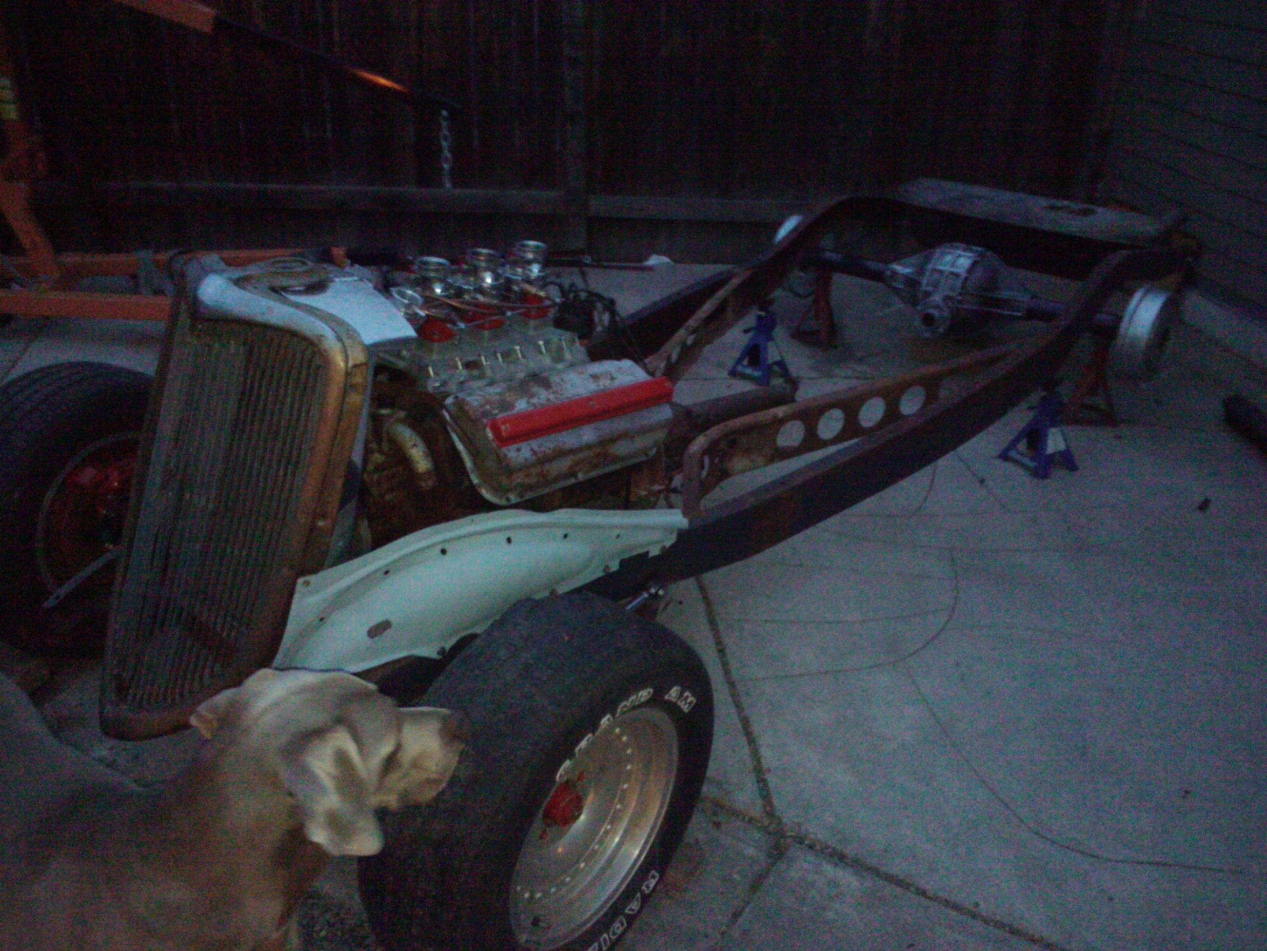

    Todat I got the stainless 4 bar, coil overs, rear spring hanger, and halibrand mounted. (not final welded).

  3. 32fivewindow
    Joined: Mar 22, 2008
    Posts: 226
    32fivewindow
    from USA!
    Quickchange is mocked up and mounted. I still have to do the internals on it.

  5. Roadsir
    Joined: Jun 3, 2006
    Posts: 4,018
    Roadsir
    32fivewindow,
    Please check the four bar frame mounting brackets. I think they are going to hang way too low unless you plan on a pretty high ride height.
    You may want to move them inboard, and raise them up, so the bottom of the frame is equal distance between the two bars.
  6. 32fivewindow
    Posts: 226
    32fivewindow
    from USA!
    I thought about that, but speedway's spec sheet had them laid out that way. The "out of the box" distance between the bars is equall. I wonder should I cut off the top mounting bracket portion, and gussett the frame, and raise the cut portion of the bracket to the bottom of the frame? As it is set now... the 4 bars are level to the ground. Obviously, I again can get rid of some of that front bracket, and still level them. Good thing they are still tacked. HMMMM.

  8. I don't like the way the 4-link loks. They will hang down and look "streetroddy"...
  9. JeffreyJames
    Joined: Jun 13, 2007
    Posts: 16,628
    JeffreyJames
    from SUGAR CITY
    This is absolutely just my opinion and I love your car so don't get me wrong. However that rear and four bar out back are rubbing me the wrong way. I think a triangulated ladder bar set up much like the way rolling bones does there cars with the '36 bones on the bottom and DOM tubing up top triangulated to the center cross member would be the way to go. It would give you strength and aesthetics all in one. And as far as the rear goes, I just have a thing about Champ style quickchanges. For me it would be a V8 styles one or nothing as the champ ones are just way to big. I'd almost like to see a 9" under there instead....does that make me crazy?
    Anyways man, I am digging the shit out of this car and the only reason I felt compelled to say something is because I love the project so much. THe engine and intake, trans and engine placement are what's making me fall in love!

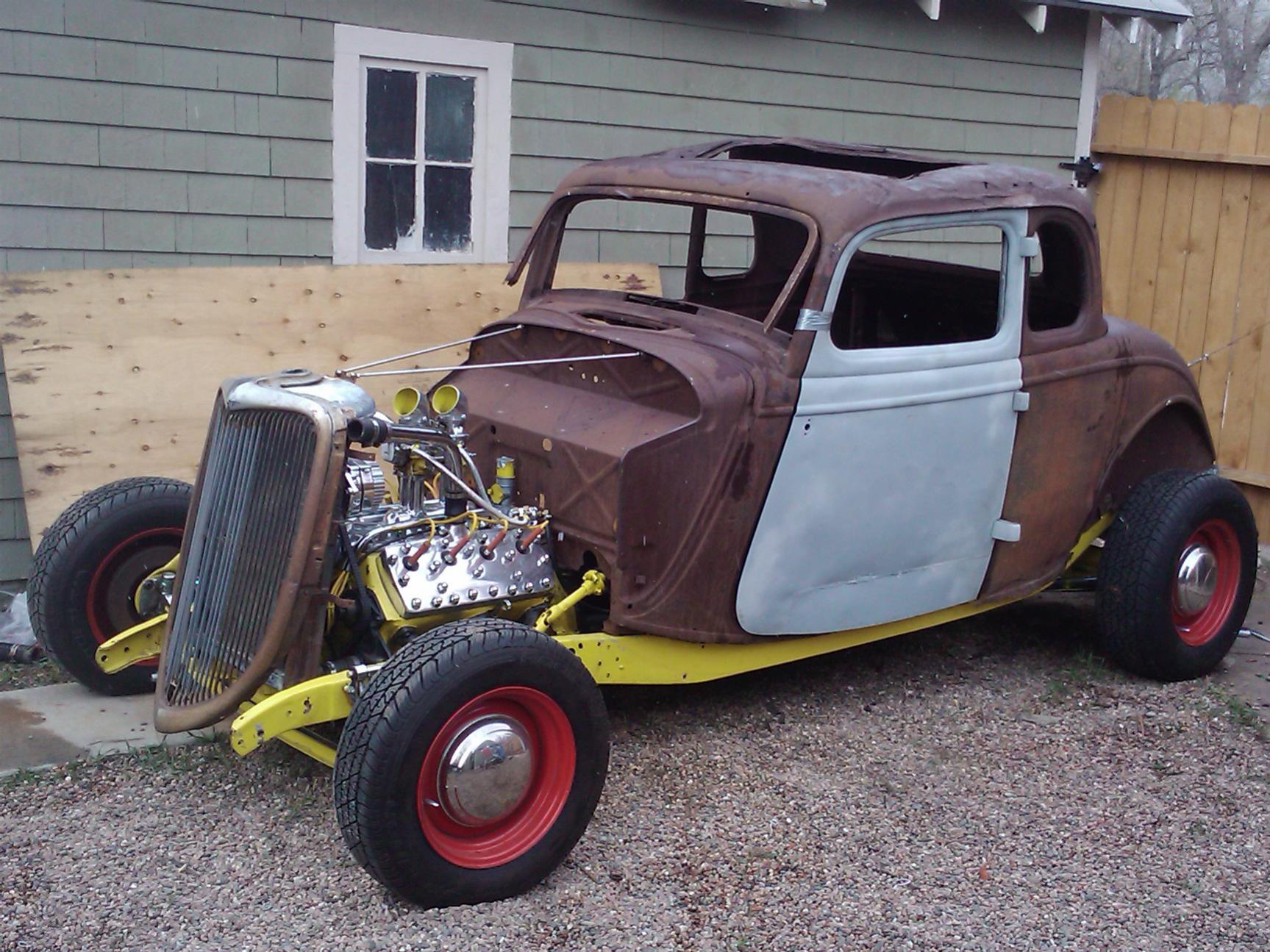

  15. 32fivewindow
    Posts: 226
    32fivewindow
    from USA!
    The 33 with the yellow chassis is full fender-ed now, and has a new roof. The 34 with the hemi is still the same. The weather is supposed to be good this weekend, here's some pics...
    They are both stock height... right now.... The 33 fender-ed car will stay stock height, The hemi car 34 body is also un-chopped... I will probably sell it or trade it for a chopped body. The roof is too nice to cut apart, I should probably save it for someone who would rather have a stock body.
