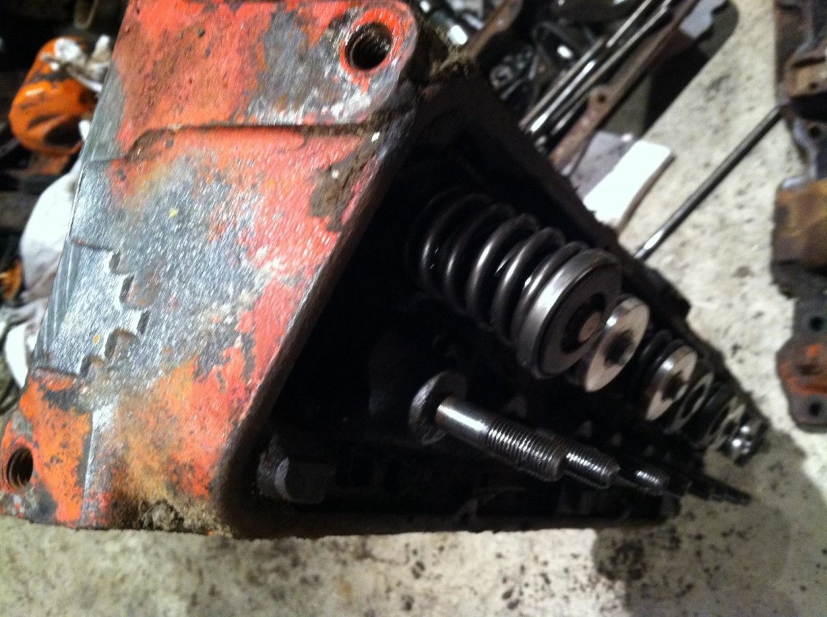

    Hint ,
    Aluminum retainers in/on a stock never been taken apart 327
    picture shows them on the intakes only.
  2. tfeverfred
    Joined: Nov 11, 2006
    Posts: 15,791
    tfeverfred
    WITCHCRAFT! Change them out or the Gods of the under world will seek you out!
    LOU WELLS and henryj1951 like this.
  3. steinauge
    Joined: Feb 28, 2014
    Posts: 1,507
    steinauge
    from 1960
    I am pretty sure those were not OEM.
    henryj1951 likes this.

  5. Wyld Deuce
    Joined: Oct 17, 2005
    Posts: 104
    Wyld Deuce
    from ...
    A: is for Aluminum and Aftermarket.
    Sorry, that motor has been apart before.
    Rcraft and henryj1951 like this.

  7. Moriarity
    Joined: Apr 11, 2001
    Posts: 31,159
    Moriarity
    SUPER MODERATOR
    Did you buy the car new and this is the first time the valve covers have been off? otherwise how could you possibly know?
  8. badshifter
    Joined: Apr 28, 2006
    Posts: 3,538
    badshifter
    Why would they put aluminum retainers on the intakes and leave heavy rotators on the exhaust? As to whether it's original not I have no clue it just doesn't make sense
    302GMC and henryj1951 like this.
  9. tfeverfred
    Posts: 15,791
    tfeverfred
    And they are SHINY. Look at the gunk everywhere else........ C'mon, man.
    sunbeam, reagen and henryj1951 like this.

  12. henryj1951
    Joined: Sep 23, 2012
    Posts: 2,306
    henryj1951
    from USA
    will up load head markings here in a sec
    falcongeorge and timmy2times like this.

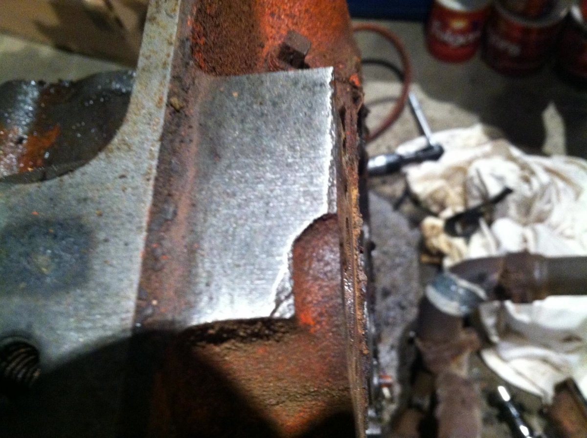

  18. I've been in GM dealers parts departments since 1970 and never seen a mix either of aluminum and steel in any production motor. And never seen an aluminum retainer used on any production motor either, serious durability issues on those too.
  19. henryj1951
    Posts: 2,306
    henryj1951
    from USA
    They said it was 1968/69 before your time. (just havin fun).
    How bout this oil filter pad (area)---> pic
    timmy2times likes this.
  20. badshifter
    Posts: 3,538
    badshifter
    The springs and rotators are shiny as well on the last set of pics. That isn't consistent with ANY old engine I've ever taken apart. The crud does not "just wipe off" and old engine I've ever dealt with either. Let's see the intake, it looks like a standard cast iron piece with a choke stove? So you only "think" you're the first to have it apart? Do you know the history and it's a guessing game for us, or are you looking for help I.D.ing what you think is a factory valve train? Looks pretty rusty on the outside. Marine application? Double grove water pump pulley, not a deep groove, kinda excludes performance duty?
    Solarman and henryj1951 like this.
  21. squirrel
    Joined: Sep 23, 2004
    Posts: 56,085
    squirrel
    they didn't use that short pad on the deck (where the engine number should be stamped) when they were making 327s, it's a later thing (late 70s? 80s?)
    I don't see any clues that would make me think it had never been taken apart, or that it is a production engine.
    henryj1951 and Moriarity like this.

  24. studebaker?
    mr57 and henryj1951 like this.
  25. badshifter
    Posts: 3,538
    badshifter
    You could speed the process by posting casting numbers. Or bore. Or stroke. Or info on where you got it. Checker? Avanti II? Holden?

  27. henryj1951
    Posts: 2,306
    henryj1951
    from USA
    down the cyl 3.995
    010 rear of block casting number
  28. squirrel
    Posts: 56,085
    squirrel
    4 bolt 327? huh?
    redlineracer42 and henryj1951 like this.
  29. squirrel
    Posts: 56,085
    squirrel
    Did it have the thin steel shim head gaskets?
    Ragmanray and henryj1951 like this.
  30. henryj1951
    Posts: 2,306
    henryj1951
    from USA
    So is more likely to be just a 350.?.
