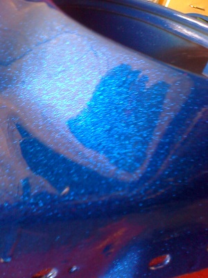

    Paint metalflake pearls and clears and paints that I have been hoarding for years.
    Custom mixed blue only 3 years old cleared and ready for
    Metal flake with interclear so it looks dull it tricked me so I added metalflake to the clear too
    Clock delete
    Radio delete
    And with the 50 Meteor delete in the finished dash minus wet sanding.
    Yes I painted this in my garage and I do have a few runs and flaws that will need sanding out and it's my fault they came from the tact rag. This is two tablespoons of flake in the interclear and about 1/2 tablespoon of one in the first layer of clear after interclear. I will post pictures of it complete as it's still drying. I am not a painter by any means I took a beginners class in like 1998-99 at a community college. I have painted a few cars for people and a few dashes but no for a long time. The flake looks pretty crazy in the sun. Under the garage lights not that great. For people thinking they can't do it all it takes is trying. I used pretty cheap guns the primer was a HF 1.8 tip. The clear and base I used a Home Depot Husky 1.4 tip gun I bought on Clearance for $21.95. The hardest thing to figure out is how much air to use. 45 into the gun gave me 20-25psi to the gauge on the gun. The primer I sprayed outside sanded with 400 and base coated. I hit the dash when I was putting all the stuff back in so I had to sand a few spots with 800 and flash coat it before the gloss coat. Then interclear. Wait and sprayed 3 more coats of clear. I would have been golden but I had extra clear in the gun so I spayed one to wet of a coat and have a few runs on the down slopes of the dash. I didn't clean the garage all crazy like some guys do. I left the door open and just sprayed the floor down with water.

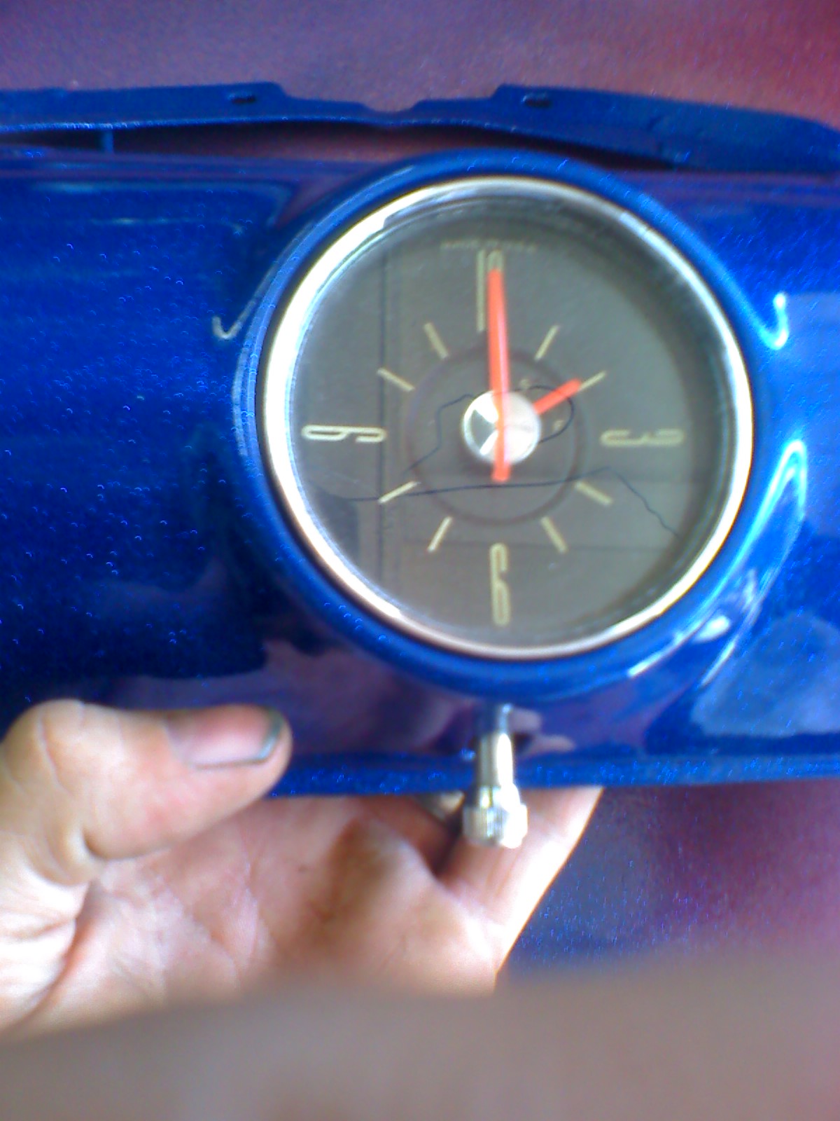

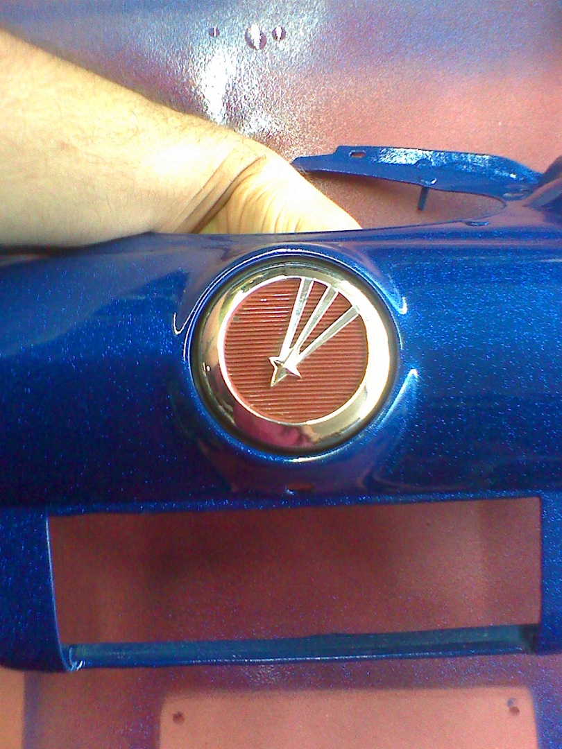

    Larry here is the 49 that I bought the dash for.
    So I have all the shoebox clock deletes the US three ring one painted to match the future car one with falling meteor and the falling meteor.

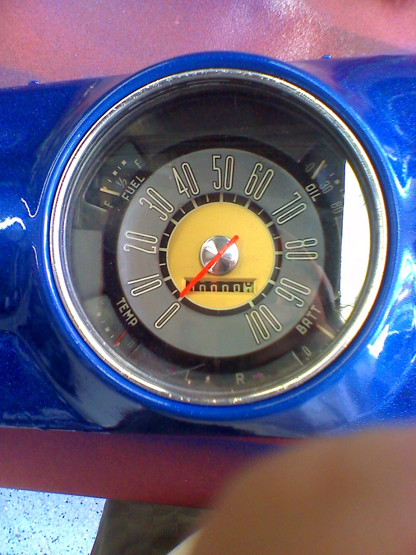

    Here are the clocks one could get with the shoebox / woodies
    Woodie speedometer NOS speedometer gauge an evilbay score $20 for the speedometer $12 for bezel.

    I'm doing the Meteor with the furtura car and the Woodie Gauge cluster. I am debating on the stock steering wheel and a 52-54 Mercury. I am going to flake both of them in the next few days and which ever one I like most I will use. I do have the Meteor horn button along with all the others that came in the 49-50 Fords and Woodies minus the crazy big dollar accessory wheel and button. I don't really like the look of it and for the money I would rather have other things.

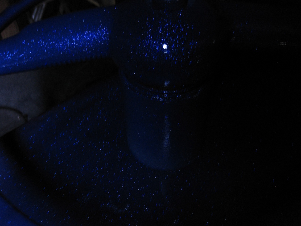

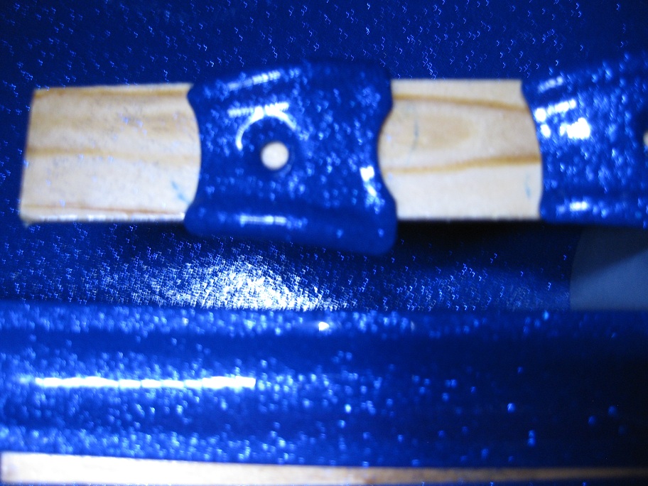

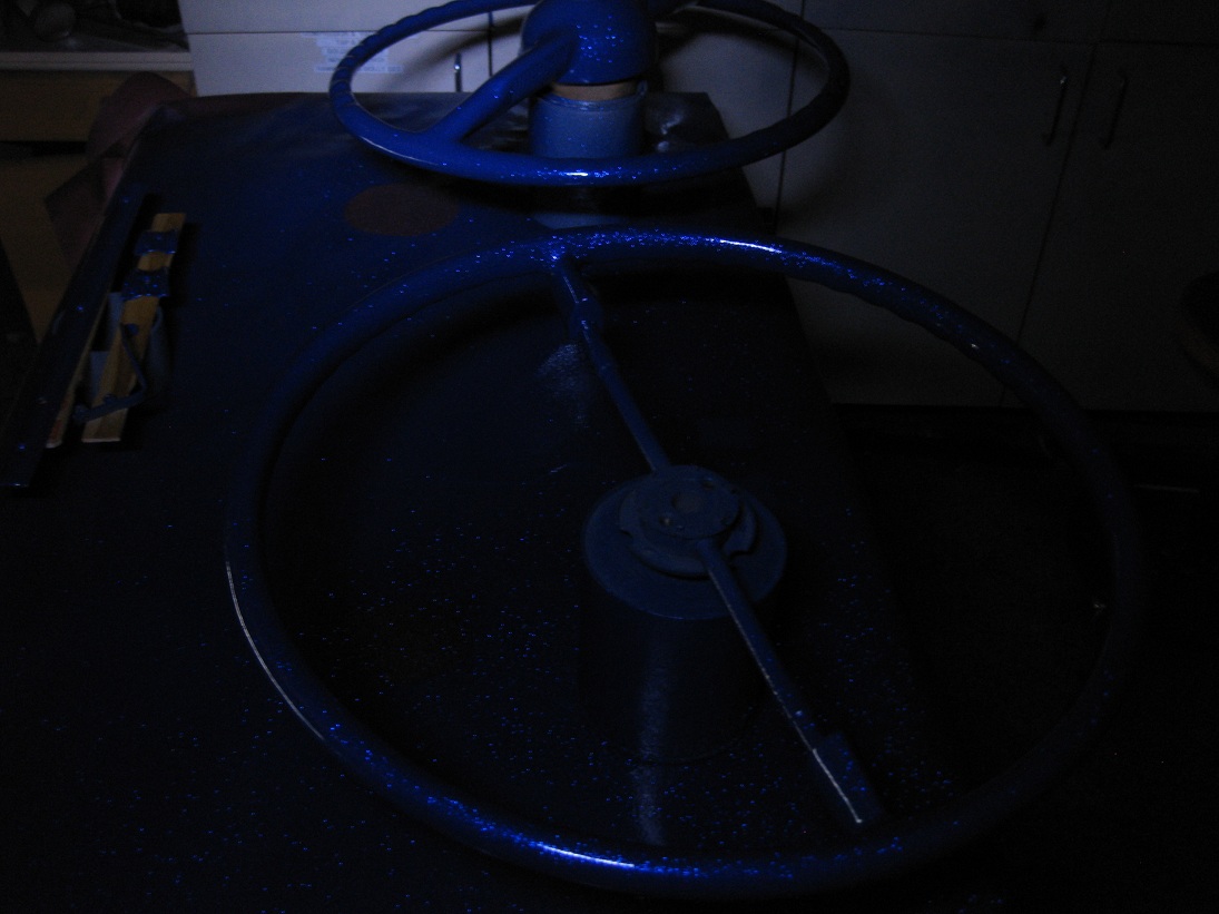

    After staying up way to late to wetsand the dash to 2000g I got up this morning while the Boss and wife were out of town and did this!
    One word I will say to anyone that isn't a pro painter. AFTER COLOR CLEAR YOUR PIECES BEFORE INTERCLEAR!
    I would be done with the side panels if I took my own words to heart. Now I have to repaint 3 of the 4 panels so I will have to repaint them all. I messed them up by not clearing before interclear. I could have saved myself alot of headache if I had cleared before. Lesson learn the hard way. I'm loving the color the dark pictures are with the door shut and lights out. The others are with a small led flashlight

    1952-54 Mercury steering wheel with blue metal flake. Looks Awesome in person.

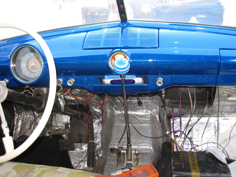

    Buffed out the dash and installed it today. I still have to figure out if I am going with a white steering colum or blue. It looks really nice in person. I polished the screws that I had that fit. The steering wheel in the pictures I bought off EvilBay and the seller mailed it cracked when they said refubished. Sent it back they redid it and the first drive it have these cracks in it. The crappy part was it was past the time to give bad feed back. You can see the origianl paint under it and the first color they painted then the repair job paint. It's just a super crappy job.
