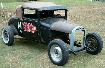

    well since there was a little spoken of my new car on the "track nose A" thread i figured i would post some pictures.
    this car is by no means finished. i just painted it right over the welds to take it to the jalopy showdown on a trailer...it does have a motor and all the mechanicals in it...just need to do all the plumbing wiring and finishing touches on the body, make another seat etc.
    this is a 28 sport coupe that i cut up.
    its channeled 4 inches, shortened 3 inches in the doors, rear deck stretched 5 inches and lowered 3/4 then body lines added around the back and along the bottom. the doors are thinned down a good bit and the whole interior capped off. the frame is Z'd 2 inches in the back and the front end has 37 front spring perches welded to the back of the axle making it a sort of suicide front end...its 46 axles and spindles and brakes, flathead V8 motor with a 3 speed toploader trans. well anyways heres the pictures

    wow, thanks everyone....didnt expect so much response from a "coupe"
    the nose scoop sides will get filled in and alot of other things...this is just a "so far in the progress update"
    shiny. i didnt end up using your posts...these are the stock ones..the roadster stuff needed changed around so much seemed like a shame to cut it up and i decided to leave the bigger step as the last remaining stock coupe part

  17. I'd like to know more about what you did to the body, you said you stretced the deck 5 in, could you explain that a little more.
    it looks dead on, very cool.

  25. I see, that makes sense, I wondered if you changed the length of the quarterpanel, to replace what you took out of the doors? I figured you would have to do that so that the whole body wouldn't get shorter, but it looks like you didn't? I hope that makes sense. Again, it looks great.

    i did shorten the entire length of the body 3"...i took it out of the sub rails behind the doors but then remounted the quarter post..and then shortened the doors 3"
    heres the car when i chopped it 4" and when i roadsterized it but before any actual changes other then the 3" shortening
