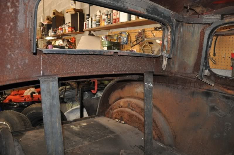

    Well I was told that I should share the build so here it is. I have been a vintage VW hot rodder for many years and was looking to do something different. I sold the bugs and went out to find something that I could really sink my teeth into. I headed into the mountains of North Carlina looking for something to keep me busy for a while, I looked at a few cars and on the way home I found a 32 Chevy coupe stuffed in the back of a garage in the north Georgia mountains. It took everything I had in my pocket but I made a deal. The frame was boxed, a Mustang II front end, a tired 350 Chevy with a turbo 350 on it and a camaro rear-end with 373 gears and a new 1/8 plate steel floor that looks pretty good . Nothing was tied in or hooked up. How in the world am I going to build this car is all I could think of on the way home.
    So with that feel free to give support and <!--[if gte mso 9]><xml> <w:WordDocument> <w:View>Normal</w:View> <w:Zoom>0</w:Zoom> <w:DoNotOptimizeForBrowser/> </w:WordDocument> </xml><![endif]-->give criticism as needed. Keep in mind this far from anything I have ever done. I have the tools and the shop, I just need some cash and with a little help from some fellow Hambers things will work out just fine.

    Carl, not a bad looking chevy, but it is not a 32 chevy, it is a 31 chevy. 31 chevy has a visor and the 32 did not, was more round with a body line around the windshield. There are other items also different on these two years. PM me if I can help, had a 32 sedan for 20 years.

    Looking at the inside of the drivers I recall why I passed on 35 Chevy a few years back ... price was right but I couldnt get past sagging wood framed doors mentally ... they are almost wood framed / steel skinned stage coaches ... You have your work cut for you ... it is a beautiful looking car though ... Good luck.

    I plan on buying lots of 1x1 steel. It will be fully framed inside the way it should be.

  6. Carl it look good.Looks like your gonna have fun re-framing the body but otherwise looks real solid. If you want to see the sufferance between the 31 and 32 take a look at my album. Good to see another Chevy being saved!

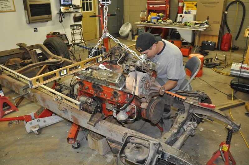

    Time to do some work on the motor since its just about dragging the ground. The motor mounts needed reworking and setting the motor in its new home would not be as bad as I thought it would be. PS don't leave vice grips on the hoist on the lowering side of the twist nut that lowers the motor. It will come crashing to the ground when your just about under it.
    I hope its in the right place. I will have to cut the floor a bit since I raised it up about 4-5"

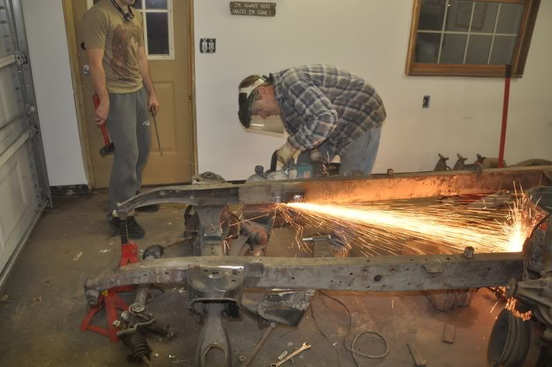

    I hated the Mustang II frontend, It had to go. It would cost me a good bit to replace but definitely will look better with an open wheel car. Big grinders and cut off saws make short work of big jobs.

    Smart move removing that ugly front suspension....
  16. Damn brother....looking good, and thank you for cutting the mustang front off.
