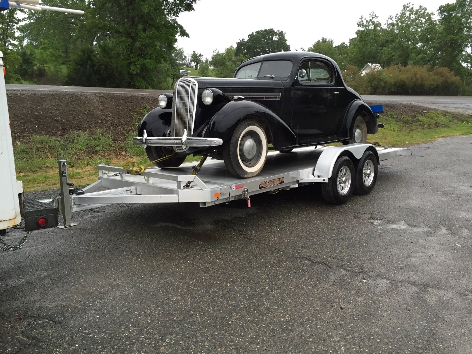

  1. So my fiancé has been really itching to have a car of her own and being the buick lover I am and she has become I was able to trade an old 65 c10
    I had for this awesome 36.
    It's all original were the 3rd owners runs like a top! It's nice to take a little break from my 52 ( http://www.jalopyjournal.com/forum/threads/1952-buick-pearl-a-factory-custom-my-first-chop.967980/ ) and have a cruiser again!

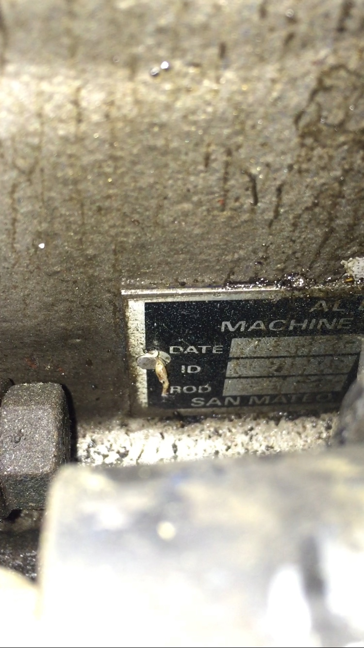

    I went and traded it and surprised her at work with it she had no clue and she was stoked! I don't have an complete game plan as of yet but I plan to go through it a little bit and make sure everything is ready to rock, the motor was supposed to only have 2k on a rebuild and there is an old tag on the side of the block but the starter is in the way of it.[​IMG]

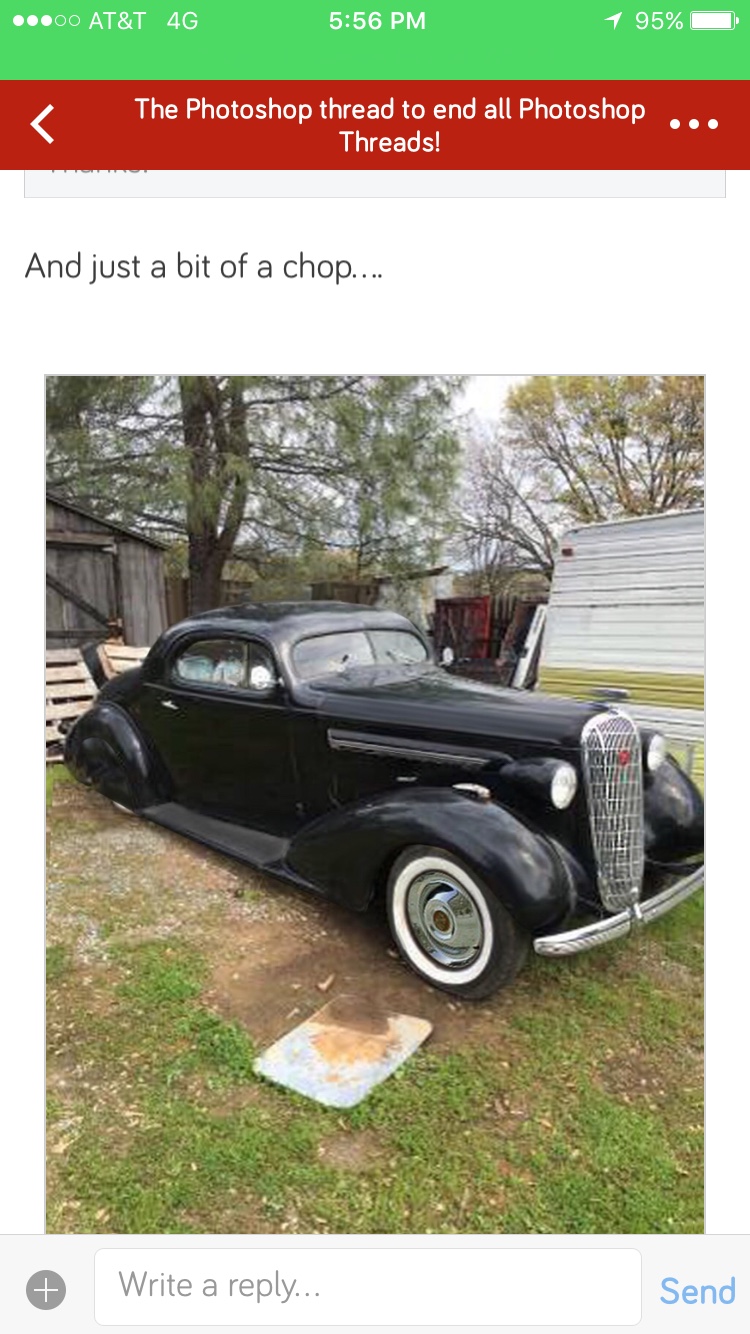

    The paint is peeling on the back as u can see so I'm not sure how I will try to preserve that. The only Rot on the whole car is in the bottom of both doors where the wood has gave way, besides that it's a solid old girl. [​IMG] were thinkin of a mild chop, skirts, and hubcaps. Everything period correct and I plan to build some speed parts for the straight 8. 2x2 intake and a split header. The only thing that doesn't currently work is the horn. And the heat control valve and chock aren't working properly. It's been sitting a little while and just started weekly so it's time for a few seals and love. Let the fun begin. Here's a photoshop for shits and giggles.[​IMG]

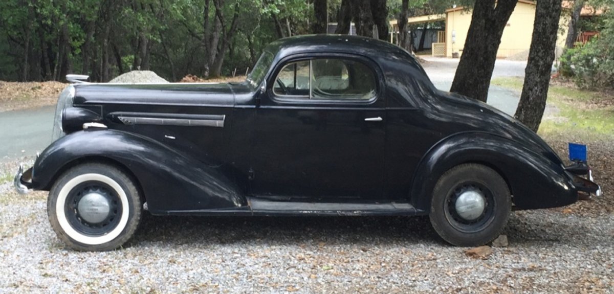

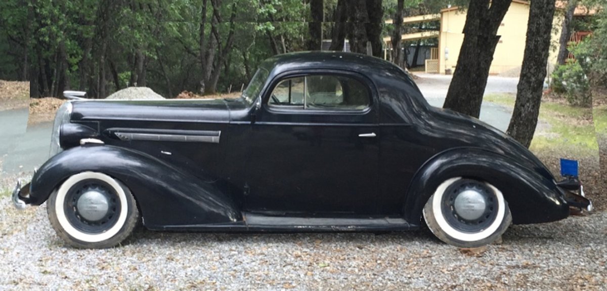

    As for your plans, I love the skirts and the wheelcovers and the speed parts for the engine. As for the chop, the car seems to have a really nice overall roof and windshield height, but the side windows seem to dip down into the doors awfully far and don't line up with the top of the cowl or trunk.
    I did a quick Photoshop to show what it would look like if all you did was make a cut across the door just below the window and raised that area up a few inches to match the trunk and cowl lines. No cutting of the roof necessary and I think it gives the look of a great chop without all the work. A guy of your talents could knock that out in an afternoon.
    This is the before picture, just to compare, I cropped it down some.
    And here's the "chopped" version, which has no cuts on the roof at all, just raised the bottom of the window opening.
    I think it's something worth considering. It could even be raised a bit more, for more effect. Either way, be sure to post updates!

  18. Squablow
    Joined: Apr 26, 2005
    Posts: 17,432
    Squablow
    Here's a crudely lowered version just for a perspective.

  20. Squablow
    Posts: 17,432
    Squablow
    Here it is raised up even more, I think I like this one best. It would even save most of your paint, just have to blend in one strip on top of the doors.
