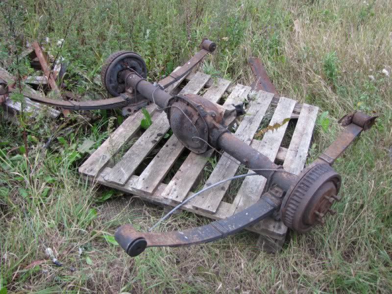

    The top piece is done now.I found some hidden cancer from around the patch i've made before to the rear floor,so i have to tear that patch off and make bigger one....
    I think this is a score,a rear end from US made Ford Granada.
    I guess now you are wondering that what a hell he is talking about?
    We dont have much US made Granadas around here,so thats why its a score.
    Guy who sold me that,told me that he sold front fenders,hood etc. to the guy who has been looking for them something like ten years...
    I dont have any idea why that guy didnt buy them from states.

  12. Finnrodder, Great looking floor you rolled , I have a 50 coupe , My avatar, It has a granada rear end also ! works great, I pulled out the 4 speed trans and changed to a C4 automatic to go behind the 289 , so smooth, Keep the pictures coming , looks excellent ,,,,Sam
  13. Nice work man! But I have never seen a rear end out of a Granada with a removable rear cover...:confused:

    Guy that sold me the rear end,said it was from 76' US made Granada.The width matches to the Granada's axle and so does the wheel pattern...

    My granda rear end is a normal 8" ford axle and not like the one in pic
    but maybe ford made axle with removble rear cover.
    her's a pic on mine

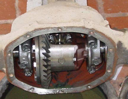

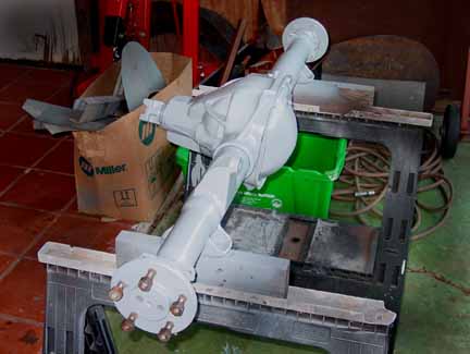

  18. themodernartist
    Joined: Feb 16, 2006
    Posts: 153
    themodernartist
    Yep! Cover is in the rear on the Granada. Not a problem so don't worry about the cover being in the rear. Both of my cars have Granada rear ends in them. I have a '47 Ford Street rod (with an 8") and a '51 Hudson Custom (with an 8.8") and have never had a problem with them. Besides, they are less expensive than the other 9"ers.

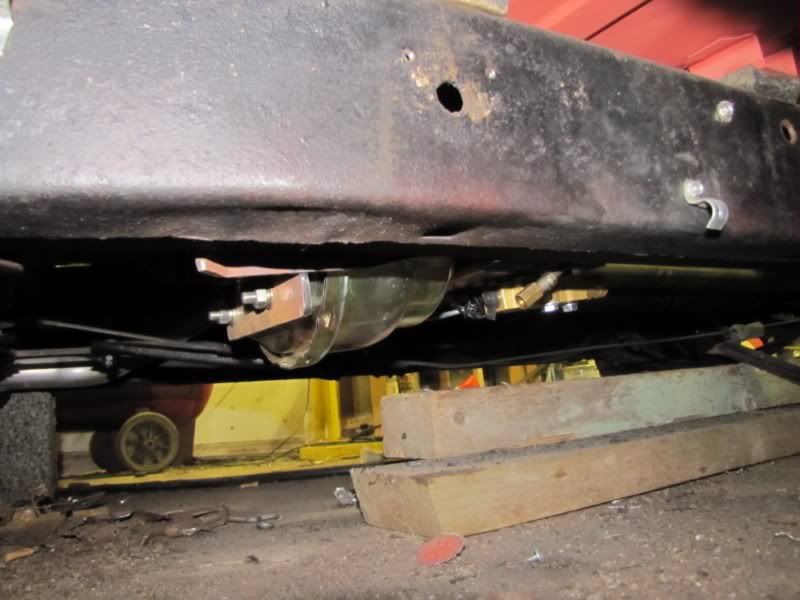

    Do you have a photo from under the car for the Master Cylinder set up?

  22. Finnrodder
    Joined: Oct 18, 2009
    Posts: 2,683
    Finnrodder
    from Finland
    Here's two:
    The angle for shooting those pics werent the best possible and sorry about the crap on the floor.I have to pull it out of the garage and sweep the floor before i start to work with the passengers side..

  24. Jay Ess
    Joined: Oct 18, 2007
    Posts: 438
    Jay Ess
    from New York
    Thanks for the photos! It looks like you have it tucked up nicely and you did not have the notch the cross member for the brake rod. I am looking to do the same thing and was worried about bottoming out the booster. Looks like you have the solution. Again, many thanks.

    from Finland
    Good to hear that those pics helped you.There's not much space between the crossmember and the brake rod,about 3/4 inches.
    If you want to get the brake booster higher,it will be more complicated.Have to make a notch or a hole to the crossmember for brake rod and have to modify the pedal assembly aswell to get the brake rod in correct line.
    No point to go that far with Jamco's kit,its more reasonable to make your own in that case.
