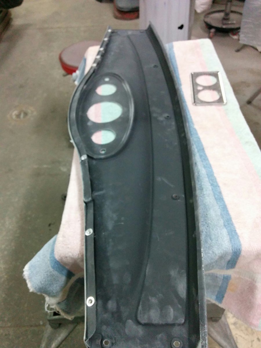

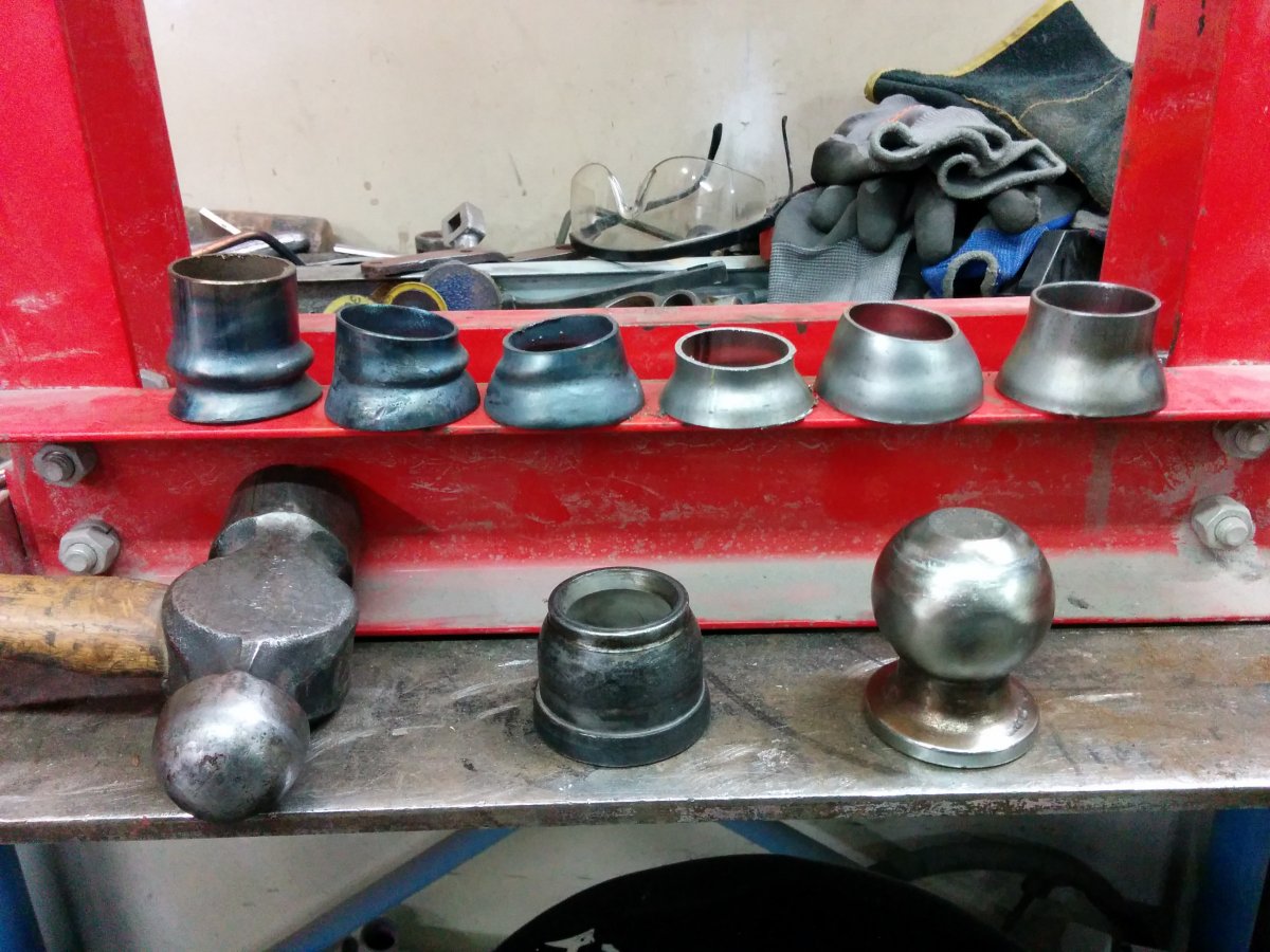

  13. IMG_20140504_114952_604.jpg IMG_20140507_124255_243.jpg Part 14, Dash, Steering column, Wiring, and gauges, and such
    The dash in most of these trucks is all ripped and torn at the column mount area and this was no exception. It had a chunk of angle iron bolted in to replace the torn away metal, the column tube was killed and steering wheel was rough.
    I made a patch for the dash and welded it in, welded up cracks around the mounting holes and put a reinforcement piece along the bottom edge. Initially I was just going to use flat stock, but after seeing how Cory Taulbert did his, I decided to copy, cause, well, he's a pretty smart guy.
    I used 3/4 x 3/4 square tube, cut diagonally to get a L shape and used a shrinker stretcher to get the shape of the bottom edge, then spot welded it to the bottom lip. I also set a bunch of 1/4 20 nutserts on the vertical edge to provide mounting points for various things.
    The contributing factor to the dash ripping at the column drop is the lack of strength of the column tube. Being one to never throw away old Ford parts, I went into the shed and grabbed the column tube from the meat truck, being a BB, everything is larger and stronger. The column tube is a thicker wall metal, so the top flange on my steering box had to have the OD machined down, so the tube could slide over and get clamped. The BB also didn't have the groovy bell shape on the top, so I got out the press and through some trial and fail, managed to form an acceptable bell shape I could tig onto the tube.
    I was really OK with the pickup column drop being broken, because the meat truck, being a BB used a 32 column drop, and it was nice and restorable, so I did. I love this piece, very complex, kind of an amazing piece of engineering. IMG_20150823_234643 (1).jpg IMG_20150612_124015.jpg IMG_20150614_100903.jpg IMG_20130425_110424_688.jpg 11272434_431853066988244_358130492_n.jpg IMG_20150616_203347.jpg IMG_20150616_002837.jpg 11374504_1434871470166885_1124100447_n.jpg 11272434_431853066988244_358130492_n.jpg

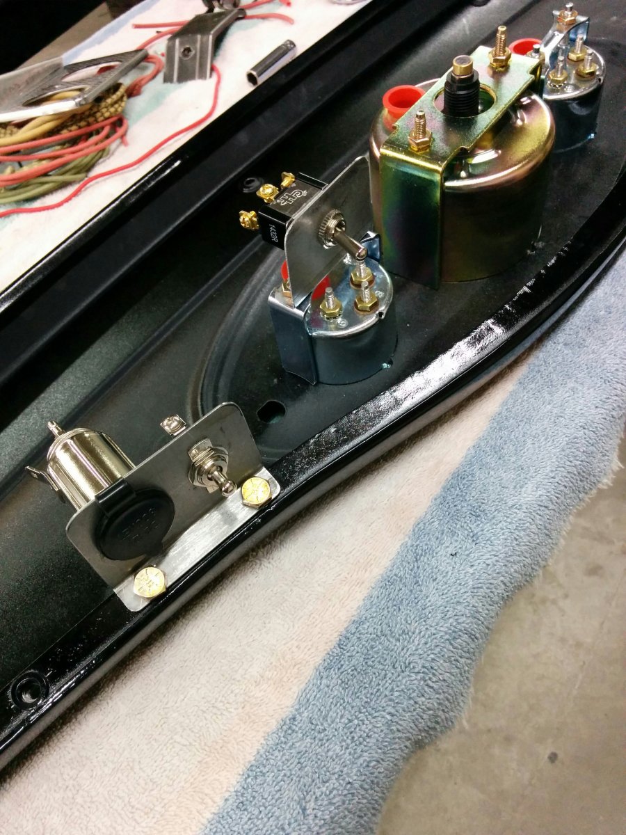

  14. Part 14.2 Gauges
    I don't have the money to be in the true vintage gauge game, so I would have to go with new with a vintage theme. It came down to SW Wings or AutoMeter Old Tyme Black
    SW for the win. Bought the 5 gauge package. I would have preferred to go mech gauges, but I only was willing to use so much dash space for gauges, having two temp gauges wasn't realistic, so I went electronic and put a 3 position switch behind the temp gauge to switch sides of the engine. IMG_20150827_193925.jpg IMG_20150831_194036.jpg 11925601_1493223710988353_906787960_n.jpg IMG_20150828_141212.jpg IMG_20150828_141303.jpg IMG_20150906_235738.jpg IMG_20150906_235543.jpg
    Initially I planned on using the stock speedo, but after having the oil and temp installed,
    it didn't take long to put the speedo in too.
    For gas and volts I was going to mount a panel to the left below the dash using the nutserts I had installed.
    This panel is from 1954, I mistakenly posted 1957 on IG
    This came out of my parents house, it was a wall control panel for the built in stove top, there were two of these on the wall, each had two heat dial knobs and a light to let you know the burners were on. They did a kitchen reno in the late 70's and I kept these and a few pieces of stainless.
    I always thought these would make a cool panel for a couple gauges. The shape works with the 33 square truck. I cut the holes and also mounted my start switch where the light had been.
    The column tube, dash and steering wheel got sprayed in natures paint booth, I polished out a few aphids and put it all together, and in.

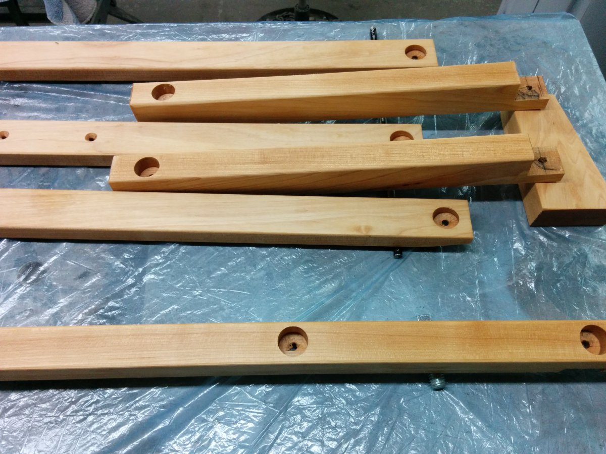

    A while ago, a partsman friend of mine got IMG_20150902_161342.jpg IMG_20150817_163054.jpg IMG_20151116_213400.jpg IMG_20151116_213105.jpg IMG_20150823_234721.jpg IMG_20150824_225158.jpg me the asphalt wire loom stuff, same as what my reproduction light switch harness had. So, I bought a length of it and used it. I really like the way the wiring kind of disappears on the black engine.
    I also cut, drilled and installed new maple cab wood at this point.
