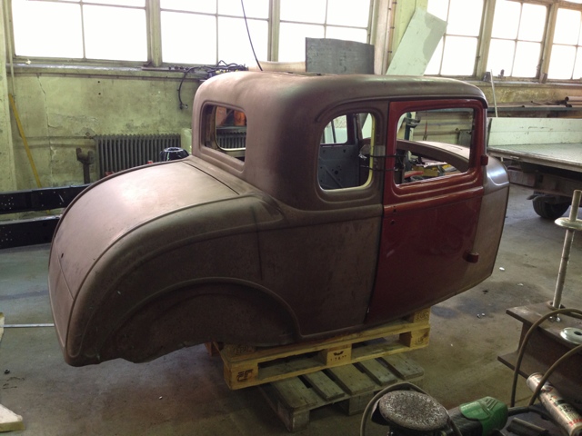

    Last week i took my 32 frame out of storage and start building it, so i guess its time to start a build thread about it.
    Its going to be "period" correct mid/late fifties style.
    331 caddy/37 lasalle ImageUploadedByH.A.M.B.1403984238.611859.jpg

  4. bonesy
    Joined: Aug 14, 2005
    Posts: 2,999
    bonesy
    Cool. I'm looking forward to this.
  5. big duece
    Joined: Jul 28, 2008
    Posts: 6,830
    big duece
    from kansas
    Holy crap, that gave me goose bumps. Your body in primer is a clone to mine. Please keep us posted.
  6. T&A Flathead
    Joined: Apr 28, 2007
    Posts: 1,985
    T&A Flathead
    I will be watching. It's good to see another 5w being built right.
  7. This is going to be a good one...
  8. mylle
    Joined: Dec 24, 2006
    Posts: 90
    mylle
    Damn..thay looks like twins!

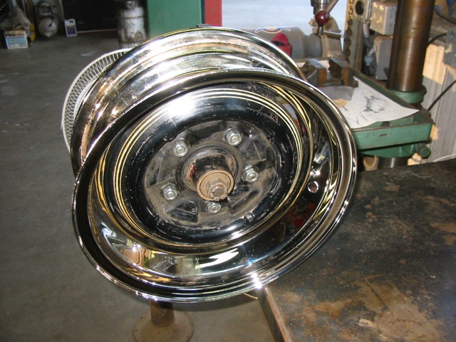

    Wery little garage time today, so i rewerse two 41 merc wheels and remove original reinforcment from the frame. Henry did have some powerful tachwelder back then!!
    My plan is to conjunct original rear reinforcments whith my 33-34 x member and then rivet all back togather. ImageUploadedByH.A.M.B.1404064199.978159.jpg ImageUploadedByH.A.M.B.1404064334.894707.jpg ImageUploadedByH.A.M.B.1404063851.628492.jpg

  18. pumpman
    Joined: Dec 6, 2010
    Posts: 2,674
    pumpman
    Damn, that body is cherry! Love the old reverse trick.
