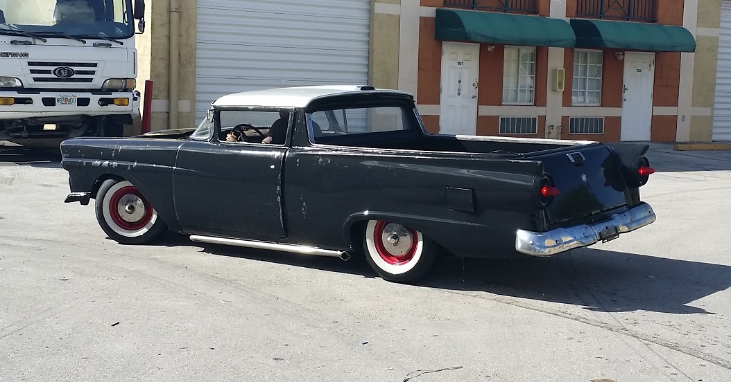

    Ive always wanted a chopped top car. But was never able to find an affordable one, or afford to have a shop to do it for me. I had a body shop and did paint and bodywork for many years but never had the chance to try to chop a car. I recently sold a 1965 VW Beetle, and decided to look for something to build with a vintage custom feel. Cruising through craigslist I came across this 1957 Ford Ranchero. Contacted the guy who had it for sale, and fell in love with the look of the car before I even went to see it. When i went to see it in person my main concern was the chop, but looked very well done with great lines, and doors open and close very good.
    So after negotiating, we made a deal, and we went to a local Uhual and rented a tailor and took it home.
    Special Thanks to Noel for helping me by taking time out of his day to help me pick it up in his truck!
    Quick Breakdown of the car.
    Its a 1957 Ford Ranchero
    Chopped 3"
    Roof has a scoop off a '58 Hood, and has a hood off a '58
    Has a Strong 302 V8 .30 Over with a mild Cam.

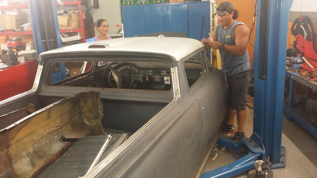

    Here we are loading it up, and heading to Miller Mantovanelli Owner of MCW Customs for the game plan 20140830_120826.jpg 20140830_125830.jpg

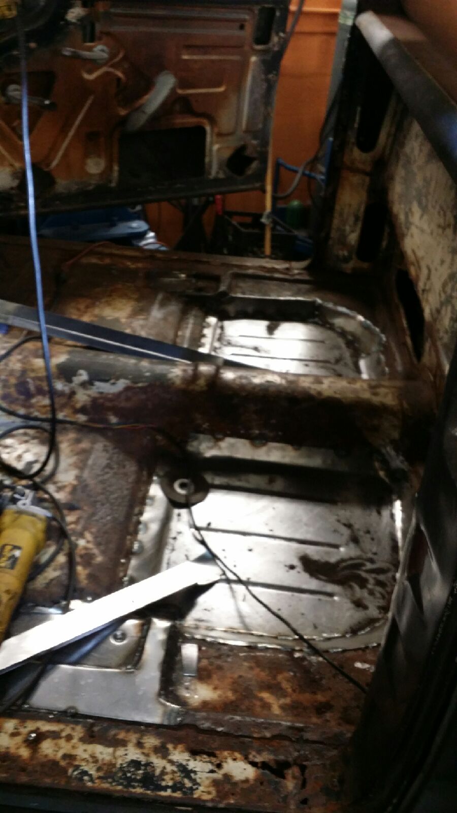

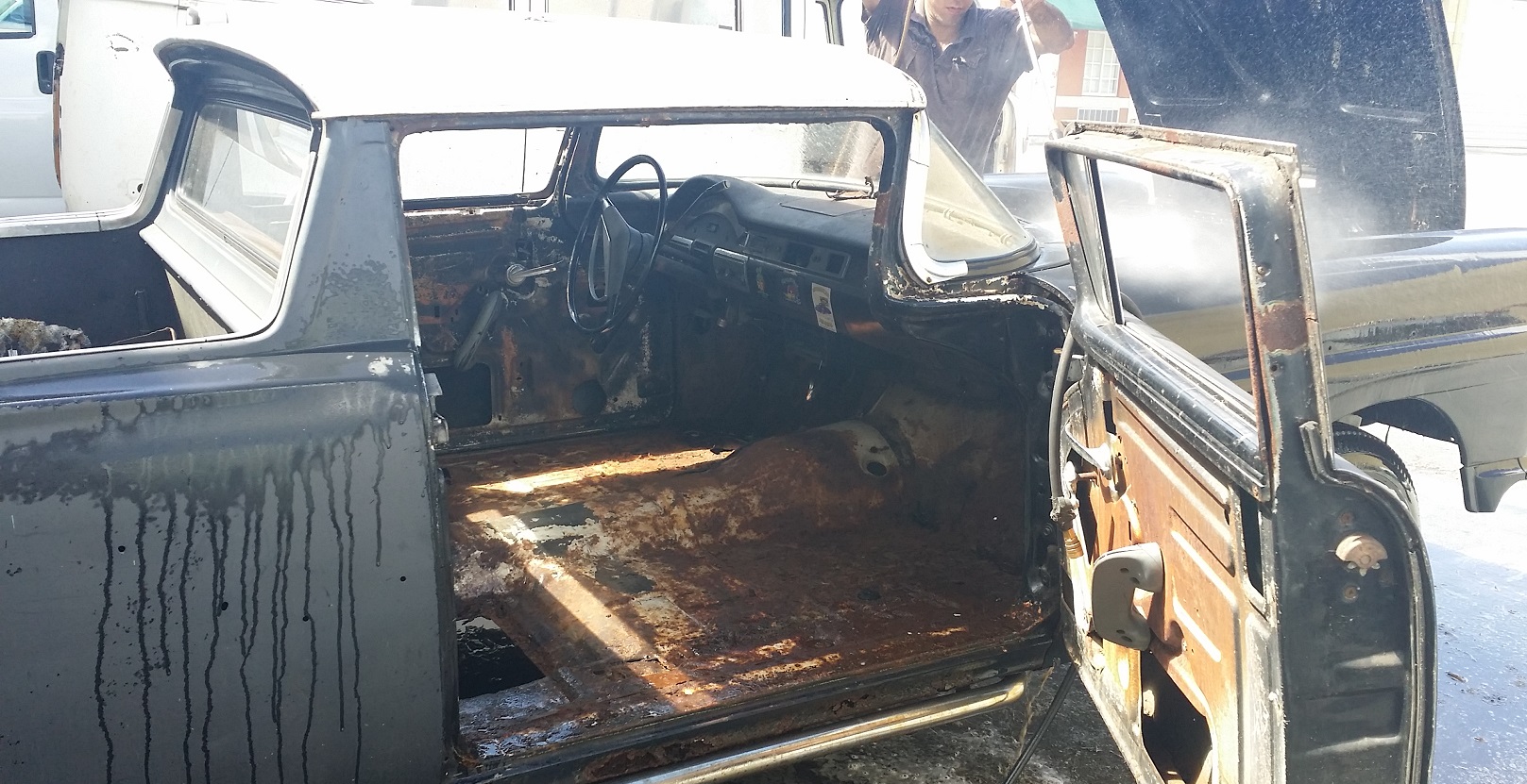

    The Previous owner stated to me the interior was trash, i believe that to be an understatement...lol..
    There was more leaves, twigs, bugs, frogs, and things we couldn't figure out what they were.
    But MCW Customs started to tare it apart to reveal the floors.
    As well as a well needed pressure wash to take out the years of grime on the car.

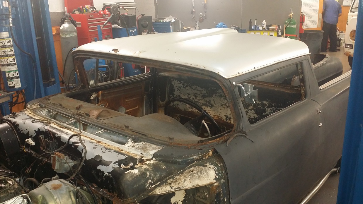

    Originally this was going to be a short cosmetic thing.
    But After seeing the potential this car/truck has.
    We decided to go a little further, and want to make this the best car we possibly can.
    so the tare down got a little more complicated.

    Glass Just Came Off.

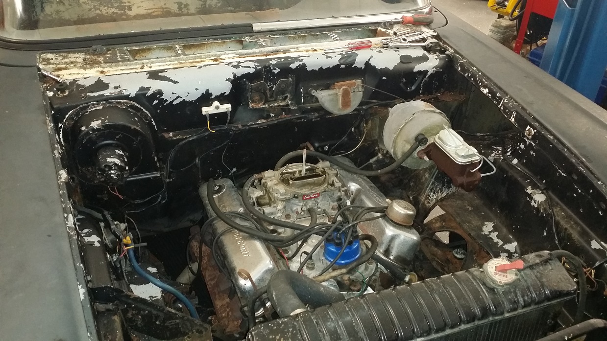

    I appreciate the love guys. We thought when we started to tare apart the car there would be a lot of surprises. But the car is pretty dry, does have some rust. But very solid for what we were expecting.
    The drive train will be staying the same, other than some cosmetics. Everything as been rebuilt, and runs very strong.
    More pics as progress happens

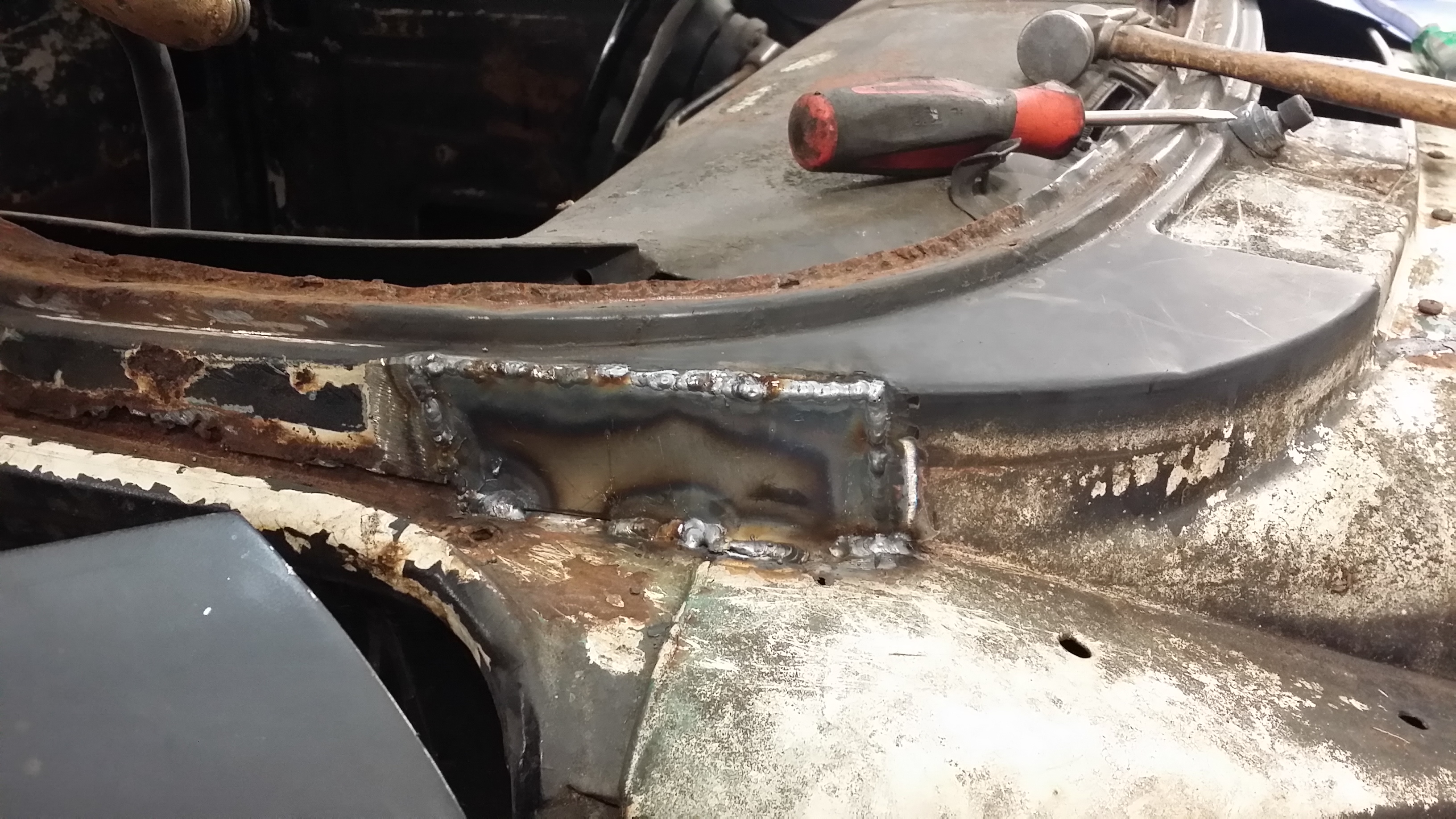

    Some metal got done today,
    Started the Lower corner of the rear.
    They did the inner and the outside.
    Just need to finish up the lip,
    And the the other side. 20140903_170620.jpg 20140903_171254.jpg 20140903_171441.jpg 20140903_173423.jpg 20140903_174436.jpg 20140903_175704.jpg

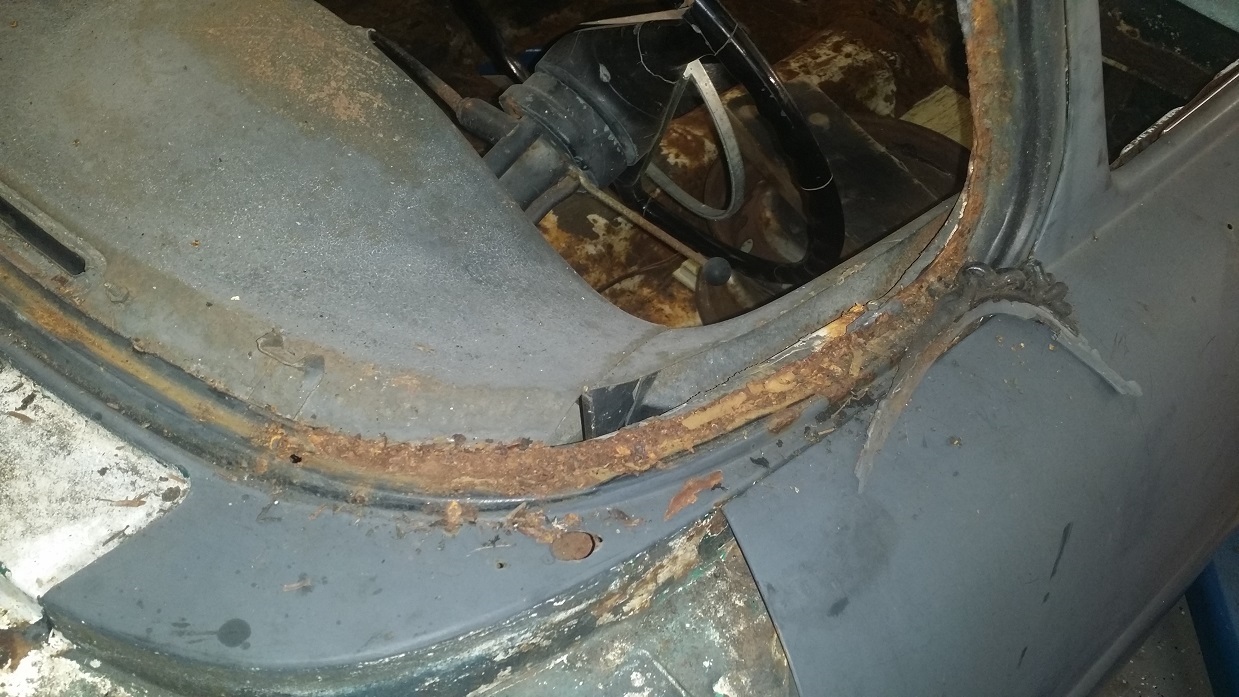

    Finished up the rear right corner, and did the left side. and started some other minor repair.
    more to come tomorrow 20140904_123443.jpg 20140904_123432.jpg 20140904_165754.jpg 20140904_171658.jpg 20140904_172924.jpg

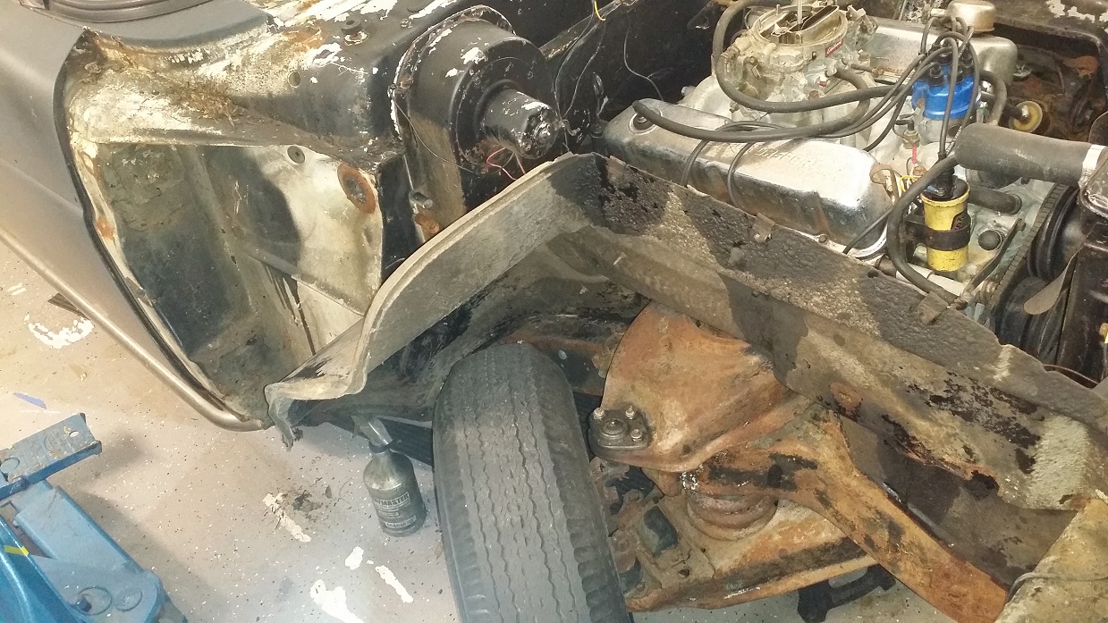

    In the pics, your front wheel wells , core support, and splash panels look good, that's a plus as that's another common rust area.
    Not sure what to recommend on the windshield "rib". That's the area that seals the widshield seal, so it may need some new metal.
    The bright trim around the bed and going up around the back window is stainless except for the two top corner pieces just under the roof. Those corner pieces are chrome plated, usually rusted. You may find more trim on the Ranchero is stainless than you would expect. Your vent window frames, for example on most '57 models is stainless, as is the windshield trim and any side trim you may have. The grille is chromed. All '57 fords forward of the firewall are the same, regardless of model or platform....except for trim and corresponding holes of course.

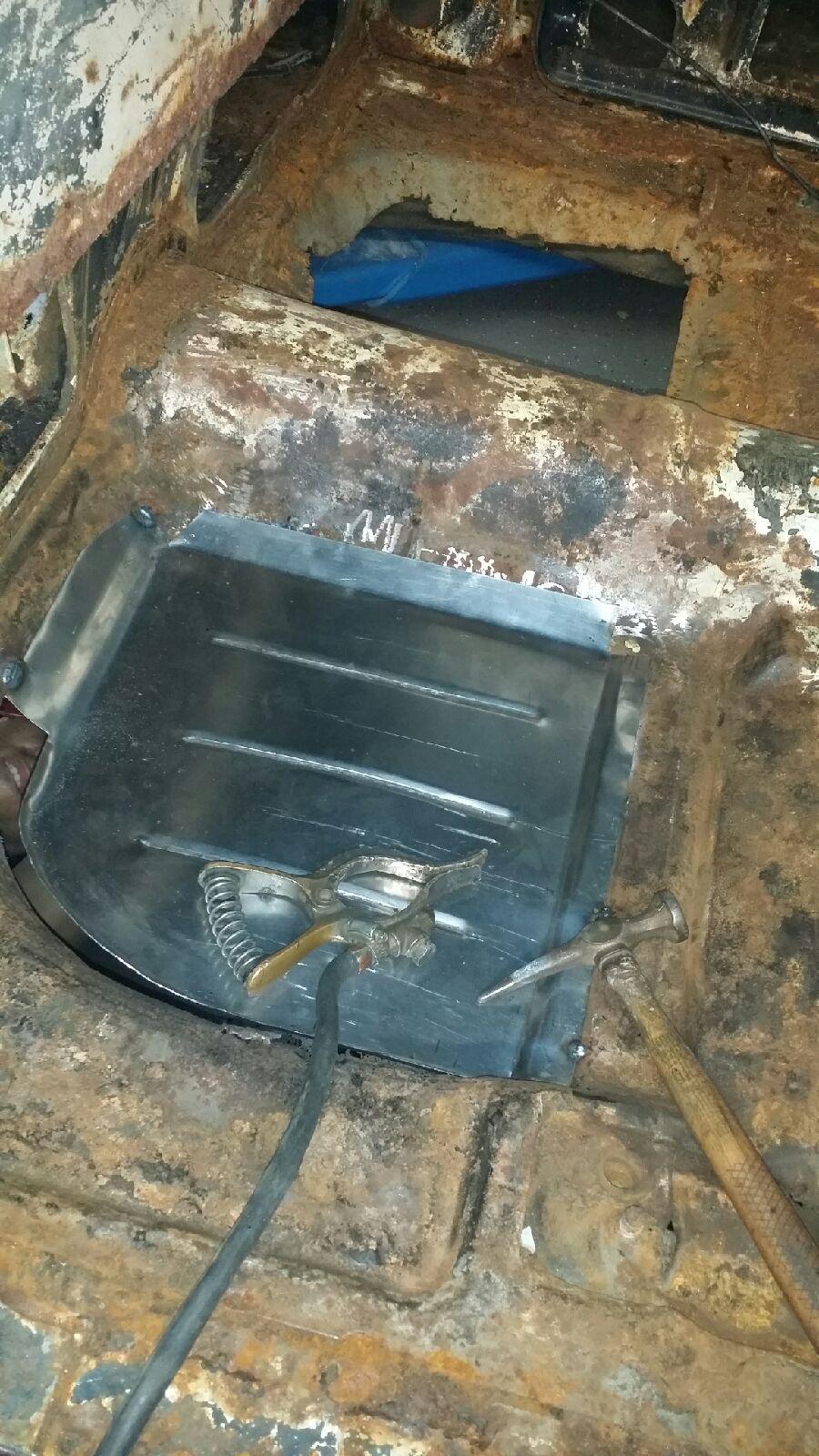

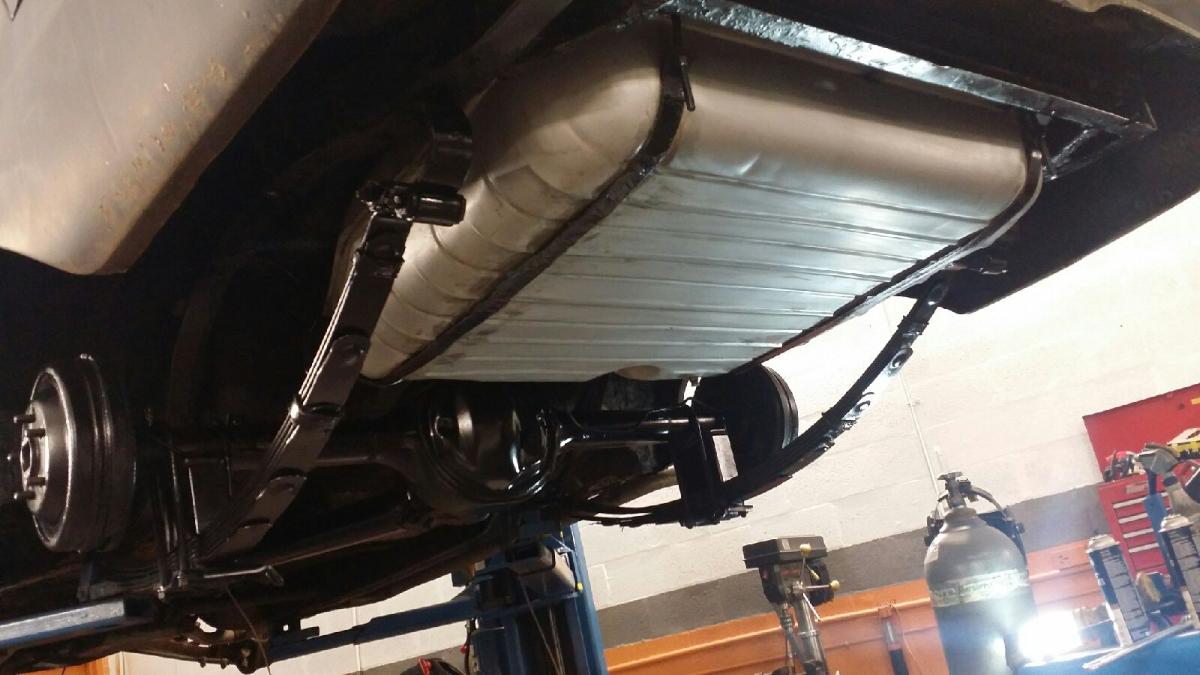

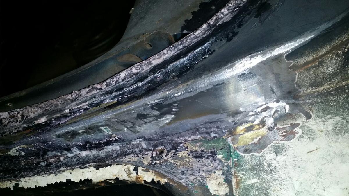

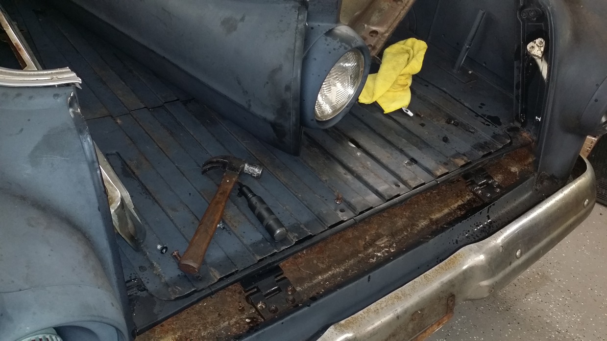

    Metal guy started the rear floor sections on Friday, Saturday metal guy not in so the undercarriage of the car started to get wire wheel and paint to take off the thick undercoating. They did the rear part of the frame and differential. Then complete floors, front suspension and steering then the wire wheel will go inside.
    Just that rear section left the shop floor nice and dirty... 20140905_164228.jpg 20140906_184237.jpg 20140906_171334.jpg

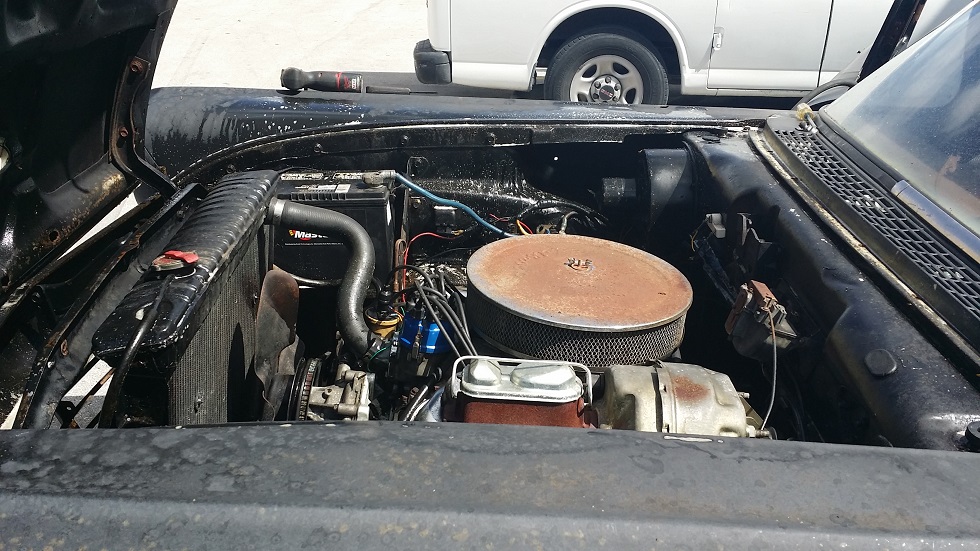

    Some floor work, and a picture of the engine, will be prepped for paint soon as well as the frame and all suspension. Previous owner already did all the bushings. 20140909_121446.jpeg 20140909_121702.jpg

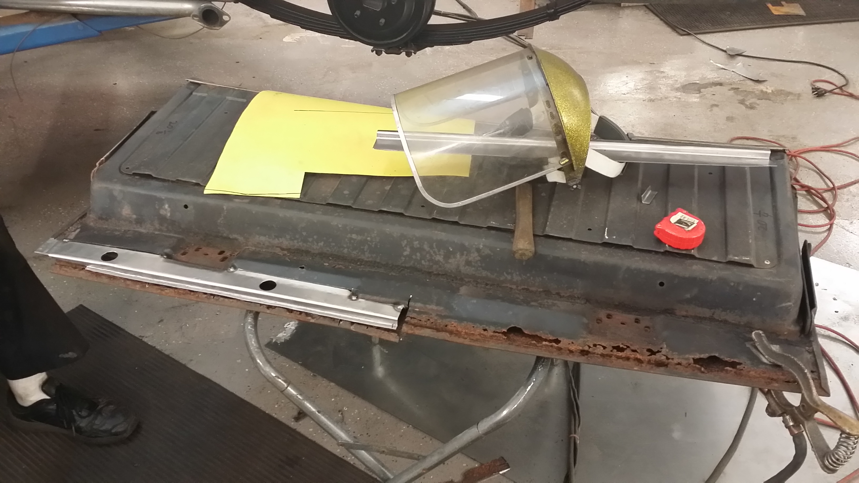

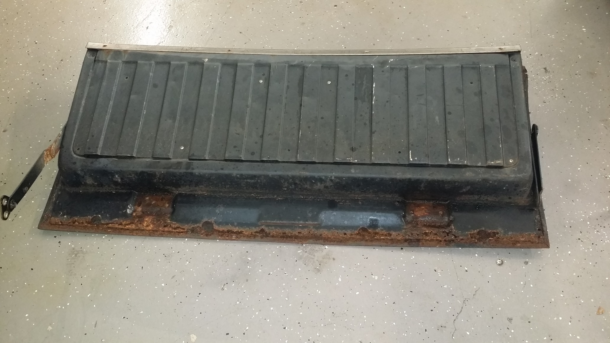

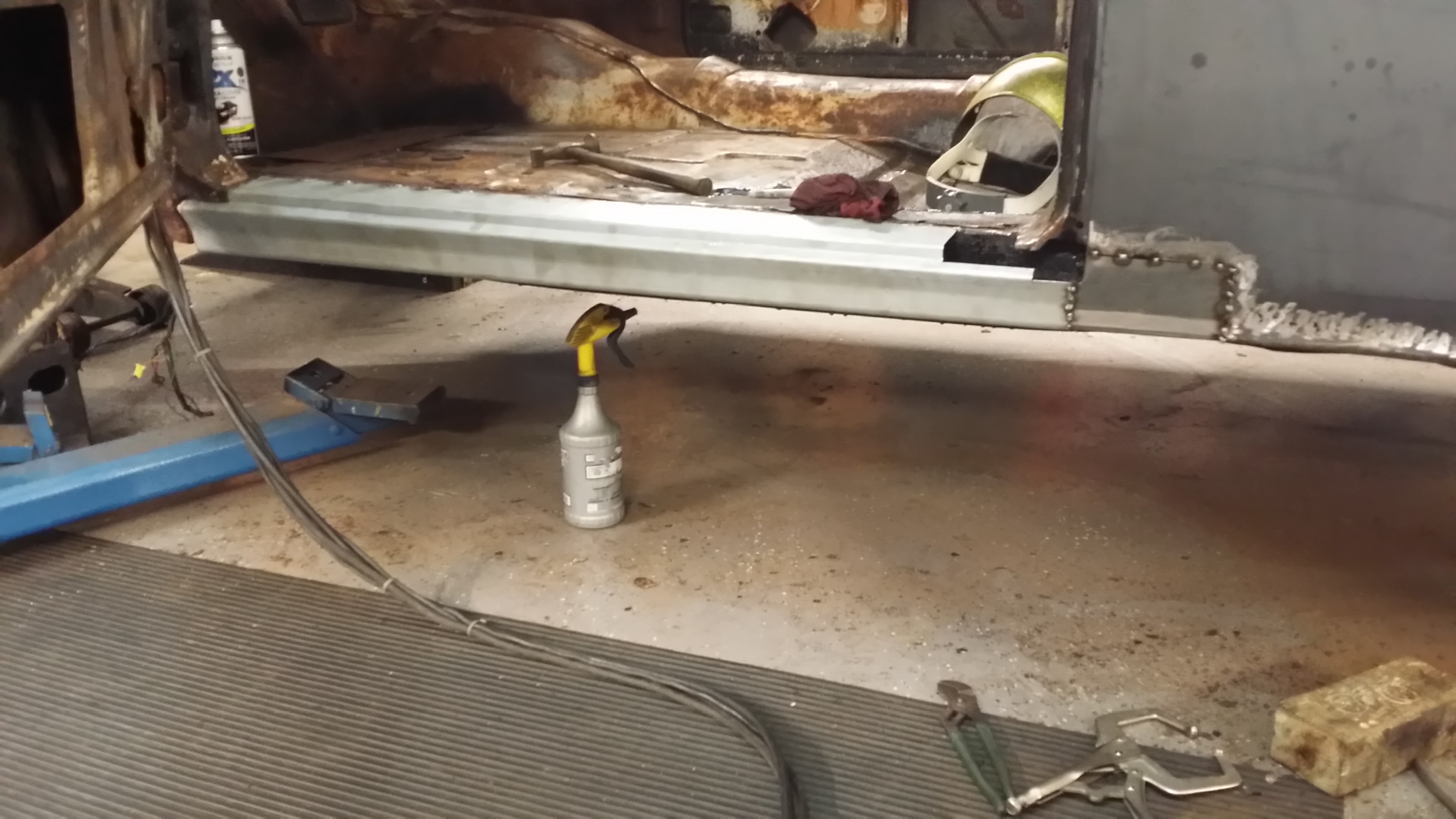

    Alexis fro. MCW Customs really working hard on the job with Miller getting it done.
    Tailgate was done today. Just needs a little more welding and ready for body work.
    And the rockers got started. 20140910_123921.jpg 20140910_142306.jpg 20140910_143246.jpg 20140911_162709.jpg 20140911_162732.jpg 20140911_154023.jpg 20140911_162640.jpg
