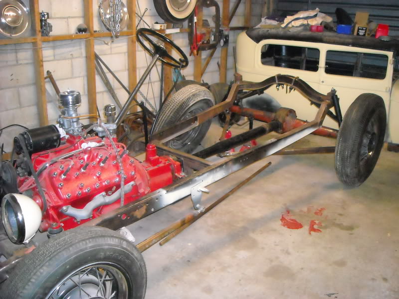

    I decided today to pressure wash the engine. It sucks when it is cold out but I figured I would try it. It was 15 degrees and I made a lot of steam. It came out pretty clean though. I need to do a little brake clean cleanup and it should be ready to reassemble. The pan was the worst part. It was full of sludge.
    Another reason to pressure was was to clean out the block of rust. This is the second dust pan full of rust that I removed. I am sure there is still some in it. I ran water through it until it was clear.
  7. I couldn't resist bolting it together to see how it looks:
    I also managed to spray some etch primer earlier in the week:

    Nice build! I am in the process of building a 27 T Tudor in an A frame with a 53 flatty and open drive. My engine is in the same condition as yours and i would like to know how you cleaned the the engine with in the short block configuration? especially the pistons and valves.
    P.S. Looks like you will have alot of fun when its done!!!!:D
  11. Thanks, I think it should be a fun little truck. To clean the engine I just used a grinder with a wire brush. When I was all done I used a hot water pressure washer with good soap. When the block gets hot enough, the grease releases. I also used a needle scaler for hard to reach areas on the block and in the passages.

  21. This weekend was not real productive for the truck. I did manage to get a oil pan that did not leak and get it cleaned up. I pressure washed the block and pan again and got it cleaner. I also fired up the sand blaster and cleaned up a few more parts. I found a pair of pumps that are better than what I had, plus I did not want to use the double pulley pump.
    Then today I managed to install the pan and water pumps and put on a coat of primer. Maybe by the end of the week I can have the engine buttoned up.

  28. I did a little more priming and painting today. The red is still wet but I had to put on some goodies to see how it looks. :D I painted it red because I was told red is for racing.

    I picked up these tires for the rear 6.50-16 Firestones:
