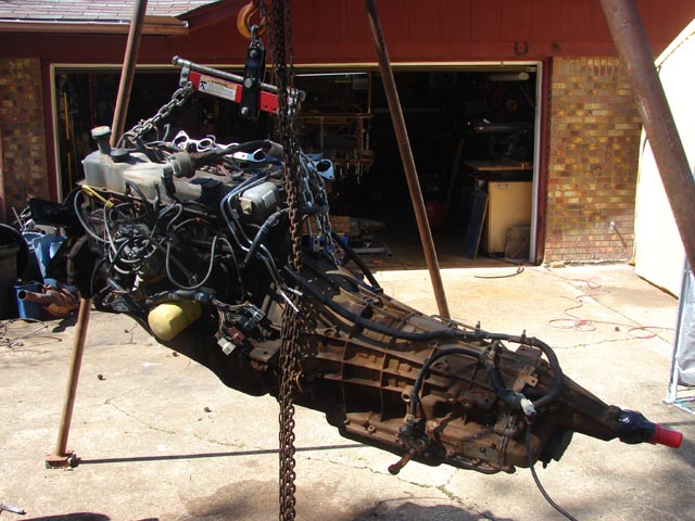

    Got the stone axe [300 Ford six] unloaded and undressed

    Pictures as promised
  5. Old28
    Joined: Jan 11, 2009
    Posts: 1,289
    Old28
    Looks like a good start on parts. I like those mid 30's wide five spindles and wheel. :)
    Are you going to modify that intake and run 6 one barrels?:D
    Keep us all in the loop as we love to see a build move forward.

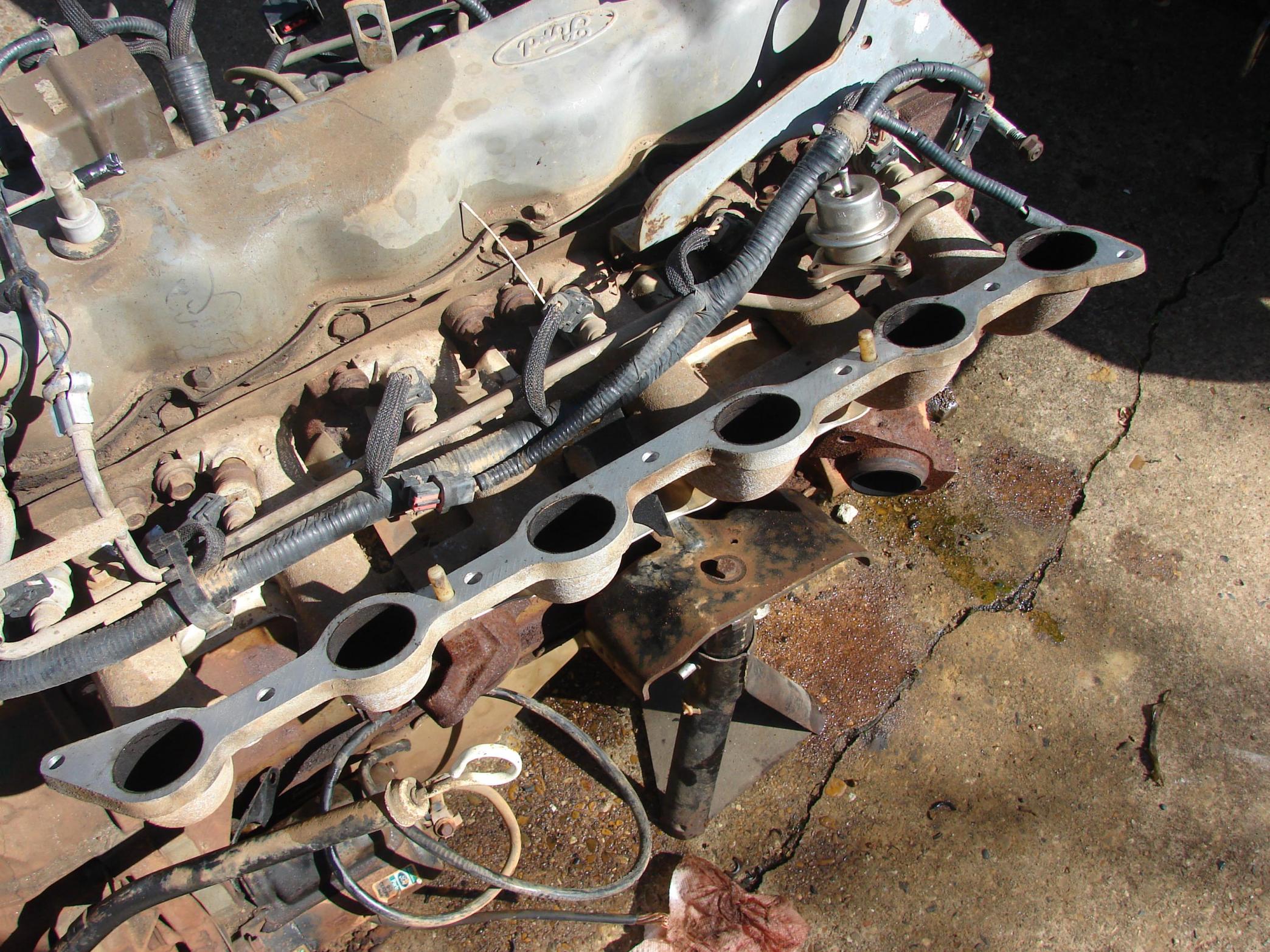

    I'd love to go with stacked fuel injection on this motor, but ... that isn't quite within the rules either. Seems like a natural spot for a homemade box plenum type manifold. I've got a pair of Holly/Weber progressive two barrels that might be legal. I'm not sure what four barrel I could use.

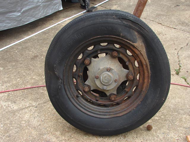

    The wheel is swap meet '39, on a modern JFZ wide five hub, borrowed for mock up from Miss Enid (my avatar). I've been looking forever for the adapter snouts to Ford spindles, without any luck. Plan B is empty Ford wide five hubs and drums, like Marty Strode used.

    I got a set of those..

    DodgeBrother, Wish I could say you could run that trany, BUT sorry, no computors.
    Yes, you can run those carbs. Most any 4bbl. carb is ok. I think a vac. sec. carb has a lot of advantages in launching the car to prevent wheel spin. Thanks for asking your questions as they help other people wanting to build these cars.

    Plan C is repop Ford hubs with space saver spares!
