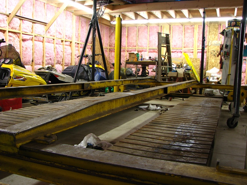

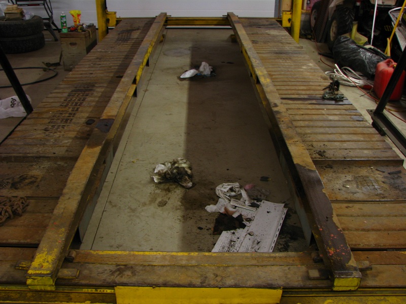

  17. Yes I have one. It is an old 70s Bradbury. I wanted a two post badly when I first started to shop. The four post came along first and I thought long and hard about pros and cons.
    I ended up with the four post because it works better for me. It has a separate frame that the ramps drop away from, leaving all four wheels romovable, the same as a two post. Plus you have more stability in this configuration. Add the fact that your ramps are there incase of catostrofic failure. Also the ramps hold tools. Lastly I have an upper storage area that the hoist works like an elevator allowing me to get heavy items up and down from storage.
    When removing heavier wheels and tires on a two post you either have to drop the vehicle or wrestle with the big things to get them on or off the wheel studs. With my four post I can drop the ramps to lift the wheels into position, or just leave them sitting right there on the ramps while work comences.
    If the ramps are ever in the way they can be dropped back to the ground alowing maximum access. Just my take on it.
    Doug.
