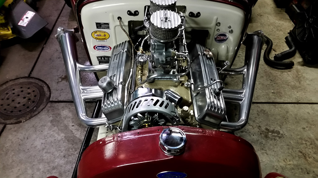

  1. My carbs have been leaking a little for the past few months and it has lead to a bit of grime and paint damage. As I tried to clean things up around the carbs, everything else just looked worse and it just snowballed out of control. I hope to have it back on the road in the next week or two though if I can stop changing things.

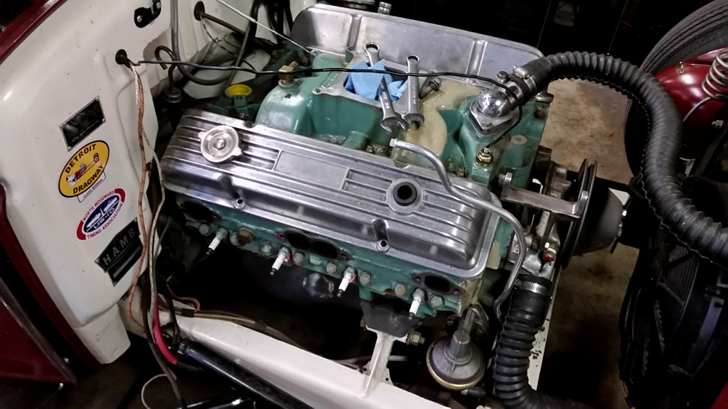

    It's a basic 60s SBC, 350, Ford/Holley 94's and when I built the car I used Detroit Diesel Alpine Green for the color and I liked the color quite a bit. The new parts added are stainless studs, some new brackets for holding stuff, alternator cover, fan and pulley, air cleaner nuts, aluminum water neck, aluminum timing cover, wire lacing, and of course the carb rebuild kits from Mike's. Sorry in advance for some of the blurry pics, I seem to have a less steady hand as I age.
    Before I got started, a test drive or two into the hot rod season

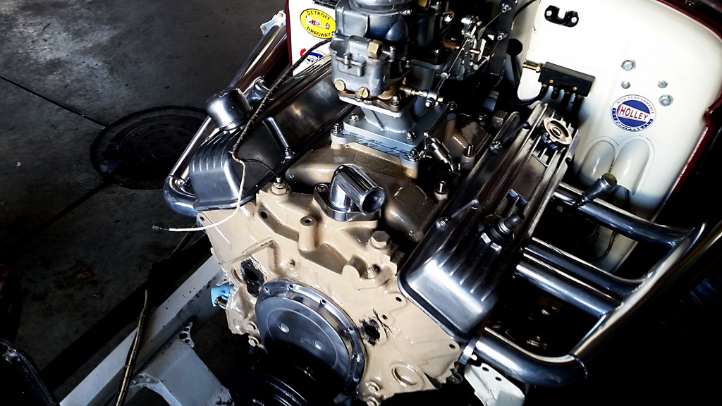

    Carb's off, looking at the dirt and mess that will cause me a months work
    Knowing a repaint was inevitable, I ordered some more Detroit Diesel Alpine green paint, this time using Motor Coater. Well the Amazon label on the can said Detroit Diesel Alpine green, however it didnt look like it inside. Might as well see what it looks like.
    ....So that's not green. After peeling Amazon's inventory label back, I can see the Motor Coater label clearly states Cummins Beige. I contacted Amazon about the wrong color and they said a they wanted to refund for the mistake and to keep the paint since I opened it.
    I didn't want to wait for more paint, and I kind of like the color so on goes the free Cummins Beige paint!
    Stripping and painting.
    Mostly cured, random work.
    Now the insanity can begin. I had these two unused bosses on the manifold, so I moved the PCV over to the drivers side, made a new line and some brackets to use them up.
    More installed, some mockup ready for teh next stages.
    Took a painting break to cleanup some wiring, a little bit of rcable lacing and rerouting.
    Cleanup and prep for timing cover anbd fuel pump.
    Started putting the fuel system together.
    Fuel pump, timing cover, fuel line, water pump, alternator, balancer,and pulley.

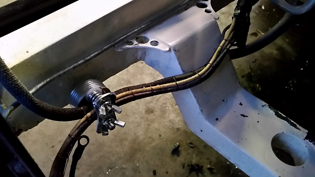

    My neighbor had some round aluminum cutoffs sitting around he was going to toss so I made up some wire harness standoffs. There are two more that go in on that frame rail.
    Nice front view of the mostly assembled engine now, more wiring and accessories on.
    Cleanup and final mounting on drivers side.
    Passenger side, need to finish up the fuel system and build a cover to go over all of the brass and regulator.
    And how it sits this morning
    More to come if ya'all are interested - a few things left to do still....

    You do some pretty detail work! That is a very nice car.However if you drive it much it is going to do the same thing again.That wont undo your detail work,but it sure will mess up your fresh paint . I dimly remember some vehicle or other(may have been a tractor?) that actually had a factory drip pan between the carb and manifold.I bet you could make one out of stainless without too much difficulty.

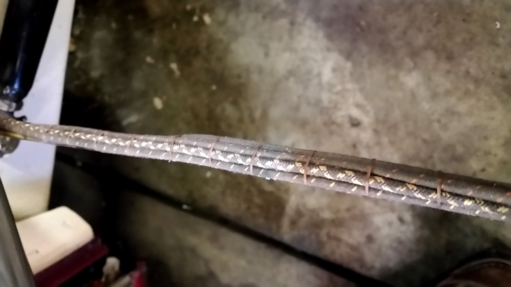

    Main harness, cloth wire and cable lacing.

    Main harness wire bundle standoffs. Mounts in the center hole. TO the right is the scrap pieces I used to make them.

    Those pcv and fuel line clamps look to me like they could eventually bore a hole through the line, which could create a vacuum leak on the pcv line but worse would be a potential fire risk on the fuel line. I think some rubber cushioning to prevent metal to metal contact would offer more peace of mind.
  12. Yes the headers are ceramic coated, I had them done last fall by a local shop.
    There is silicone above and below the line a larger one of up for the tension screw and a thinner one at the bottom made form Sugru. Anywhere I have metal to metal contact there is either nylon or rubber.

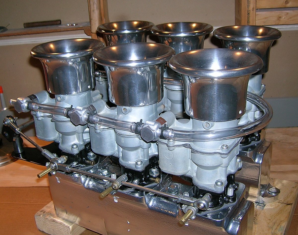

  13. Nice attention to detail. And I like the color. I'd opt for a tri power intake but that's just me

    I could use some advice on how to hide or at least make look less pronounced the 6-wire weatherpack harness on the frame rain. I have thought about making a leather sleeve or and aluminum cover/housing. Any thoughts?

    as for the weather pack cover I would do aluminum as leather absorbs water and also some leaches the tanning acids out when wet and might cause corrosion issues ( the WP are tight but they still ocassionally leak )
