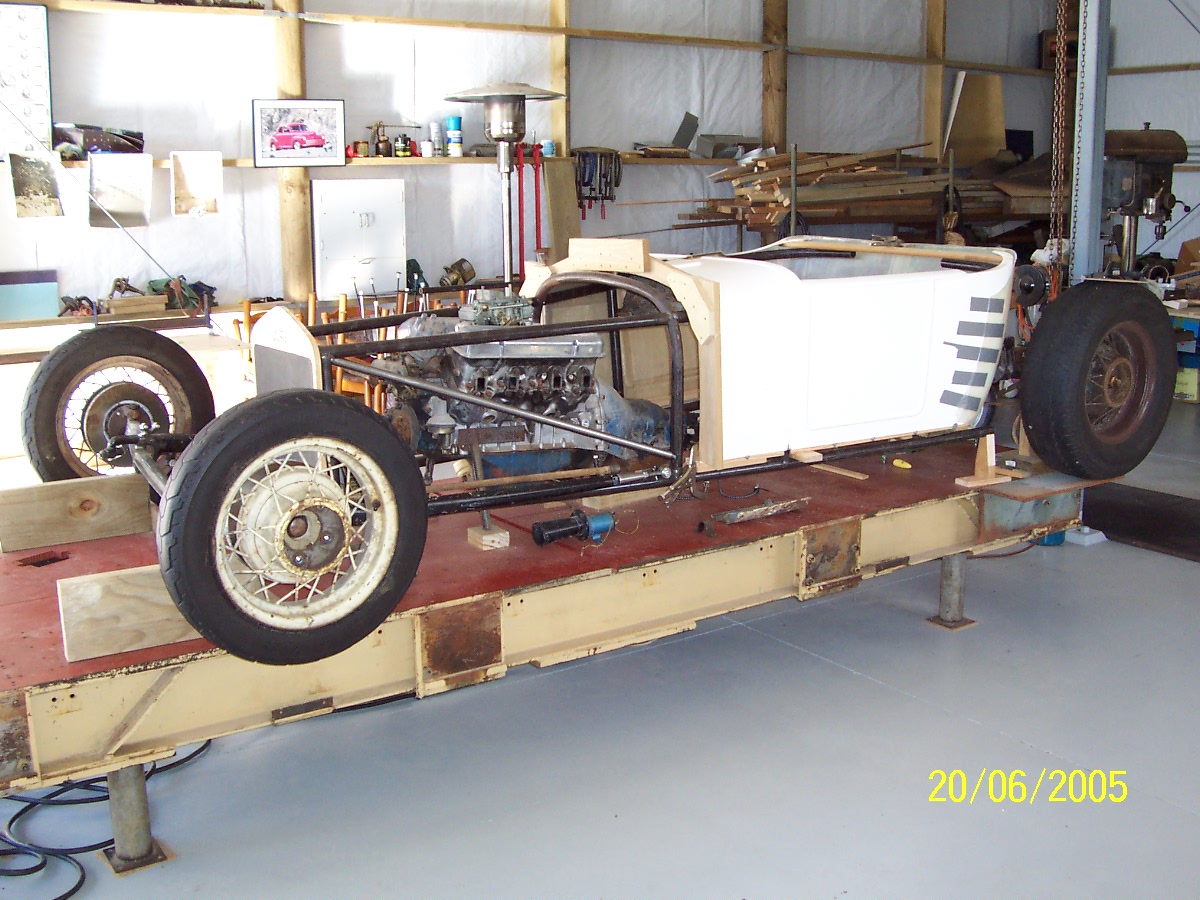

    Well here it is guys and gals, I have finally taken the time to start the thread that will lead me to the end of the road.....for this project.
    About 8 years ago I set off on this journey, to do a quick build up on a simple inexpensive car, to fill a gap while the family was young.....Ha! so much for that theory! The plan was to build a 1927 T lakes modified roadster with a tube frame and Alloy V8. As they say "The best laid plans of mice and men......"
    I am currently at the stage whereby I have a whole pile of panels away at the paint shop at the moment, the engine is being reassembled and my club is set to host an indoor display mid July....this year! The other big event is our national governing body is hosting the 50th anniversary Hotrod show one week after we hold ours. I am hoping to be ready for both of these events.
    I will post up a few historic pictures of the build to date, then work my way to the present time, and then try to keep you all up to date with news as it comes to hand.
    If anyone has any questions along the way....jump on in, and I will do my best to answer them.
    The first picture is a sketch that a friend did from a photo for me.

    100_0218.JPG 100_0217.JPG 100_0220.JPG 100_0219.JPG Initially I laid all the major components out on the table and worked out where I wanted/needed everything to fit/work. From this point I made up a temporary wooden frame for the body support, from there I reverse engineered the chassis to fit around everything.
    The front suspension is based around the tried and true combo of Henry's parts, but I didn't want to have a transverse leaf spring. I had decided to go with a torsion bar type set-up to give me some adjustability and tuning capability. To make this possible I found some torsion bars from a 1970s British light weight sedan and then proceded to make them work.
    To keep the torsion bars functional I had to link them to the axle some how. On the right side (Drivers and drag link side) I used a spherical joint fixed to the wishbone, which in effect provides a panhard like connection to this side. Due to the two sides of the link arms from the torsion bars swinging in opposing arcs, the left side required a 'knuckle' to allow for movement and avoid binding.
    I had also hoped to take the car onto a dirt track one day and the torsion bars will allow me to preload the outside wheel and unload the inside wheel to make it go around corners! Time will tell!
