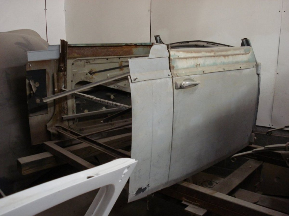

    Here is one of my little secrets, although nothing stays secret for long. Take any vw body , hack off the front, narrow 8 inches, find some convertible door tops or doors . Also from the conv. donor car take all the top bows and stuff and have a folding top, or not. I will use some more door skins for the sides of the cowl and I have the conv. windshield posts and cowl top for a windshield. Let your imagination run free. A rust free roadster body. I was going to finish the back off like a touring body cut off behind the front seat. I started this at least 20 years ago, and here it sits. Try not to take my ideas before I can do something wiyh them first, lol.:D

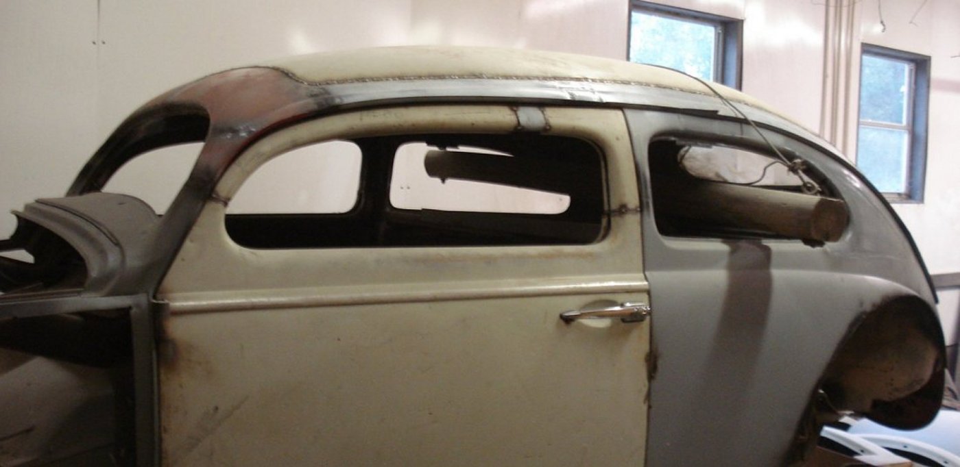

  13. What did you do for glass ?

  17. The back window frame is the back window out of my '39 Chevy that I cut the roof off of to make a Carson top car and had saved the roof for stuff like this so the glass is flat and just made a pattern and went to the glass shop...
