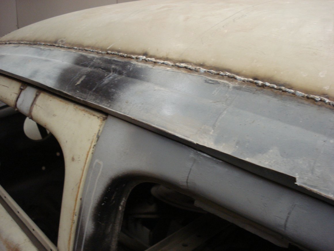

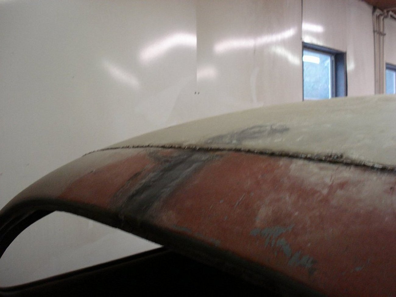

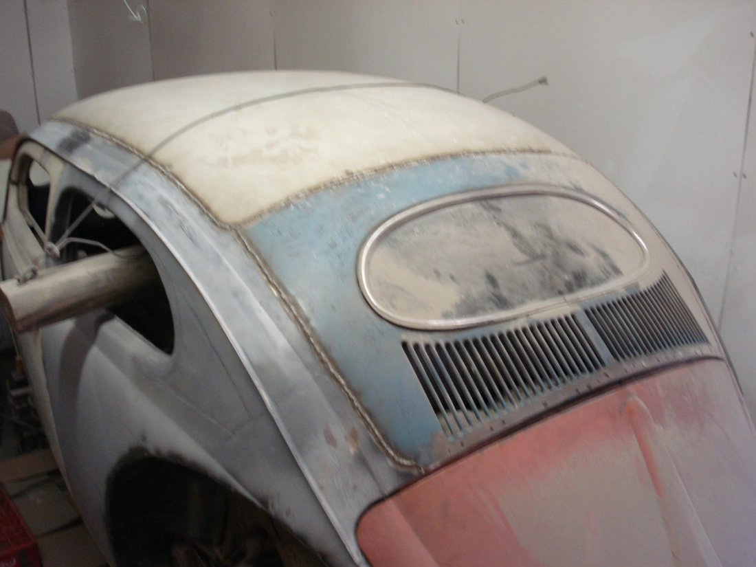

    Here is how I chopped my 56 bug. I went in about a inch fom the ridges and took the whole middle of the roof out. I used another roof section cut big, and slid it around on the roof until it looked right. I had to put in another oval window section because mine was too rusty. I remember widening the roof a little in the front. You lengthen the sides of the roof a little ways back inbto the Quarter window, there is actually a little straightpart of the roof there. Move the door post back. Cut the back at a normal spot. Maybe You can tell something by the pics. I think I cut it 4 3/4 in front 4 1/2 in the back. You won't be able to get a drink at the drive thru. You can chop a bug to much and it will look bad and its harder to do, your donor roof won't quite be long enough etc. Cut your roof out , cut the sides and windshield down, slide a roof around till it looks right. You still got to do the insides. Good Luck.:D

    I just remembered why I widened the front of the roof. A 58 has a small windshield like the 56, I had seen some drag cars that leaned the posts , and the windshield hole never looked right too me, too pinched in the corners. The posts look stock, but lower , kinda the same window hole, just lower. I think I widened it about a 1 1/2 , and only in the front. I thought that was easier than leaning four posts in. That shortened body car is neat , but still has a weld right in the middle of the roof. No bondo in the center of the roof my way. There is a bunch a ways to do it, and I bet somebody will blow all our minds with a better way.:D

    I chopped my beetle the way that Walt did. It really worked well and it didn't require a donor roof. I think I took about 2 inches out of the cowl and back firewall to get the pillars to line back up with the roof. I did weld an oval rear window into the roof so I could get rid of the large 67 rear window.
