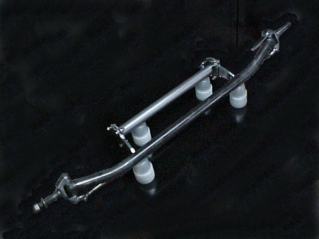

    I covered up the Jim Brissette Fueler, cleaned off my work bench and away we go. The front axle, spindles, kingpins and tie rod was up first. After measuring for the kingpin fit, I had to ream out the spindles and axle ends. I got within .002'' of the finished size, assembled the spindles to the axle ends and did the finished size reaming.
    Fuller told me to wipe the kingpin down with Vasoline and all contact surfaces. Don't use black grease, it will bleed out and make a mess. The kingpin fit was good, minimum play at .002'' at the spindle end and the spindles rotate smoothly.
    I then disassemble the all this, cleaned it and rough finished the spindle on a Medium and Fine Scotchbite Wheels. I may not have to chrome them they came out so bitchin.
    The tie rod length was measure with the Jamnut threaded 1/2 way on the Heim Joint ends, threaded into the tube adapters, cut from 3/4 x .058 4130 tubing and preassebled with 3/8 RH Alloy Heim Joints, (not he cheap stuff you can buy at Lowes) and tube adapters. Once the 1/8'' Toe Setting is set, you are not going to move it, you don't have to buy a Lefthand 3/8 NF Tap to retap the tube adapter after welding and Pat Foster said so. Not recommended for the street use.

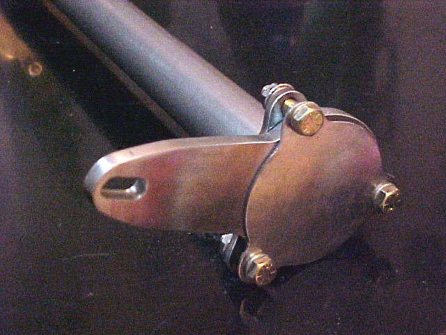

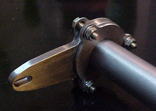

    The flame cut parts for the torsion bar assembly were all deburred, surfaces were smoothed out, holes drilled and chamfered on the end caps and arms were rough finished on the Beltsander & Scotchbrite wheels.
    The Torsion bar tube is 1.500 x .065 x 18.625'' 4130 and the Fuller tube arm support ends are fitted, pressed on and will be Tig welded later. 5/16 NF, Grade 8 bolts with aircraft washers, and mini steel metal locknuts for hardware.
    The Kent Fuller Torsion Bar Arms are 3/8'' thick 4130 with 4.250'' pivot centerlines. The front axle mounting 3/8'' hole ends are slotted on the arms. Even though the Torsion Bar Arms pivot in parallel, the arms angle out and run parallel with the hairpin radius rods.
    Not only unique and a signiture of a Kent Fuller Chassis, but keeps the front axle in alignment with the chassis, no side movement of the front axle.

    2) What was the reason for the relatively "narrow" 38" front track as compared to most other diggers?

    I am building for my pleasure and enjoyment. Sorry no contract work.
    Kent Fuller told me that the tubing was leftovers of 1.500 x .125 4130. He use to order random lengths for a cheaper price on the tubing.

    c-10 simplex
    Ok, so no aerodynamic or stability reasons for this---just random/economics reasons?

    Sounds like it to me. Kent Fuller is a very sharp thinker and if you can "read" him the answers are simple.
