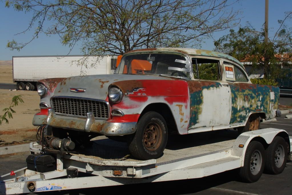

    I was hesitant to start another 55 Gasser style build but have been assured that it is just what the H.A.M.B needs so here it goes! I bought a pretty decent 150 Utility sedan last year with the intention of making a gasser out of it. [​IMG]

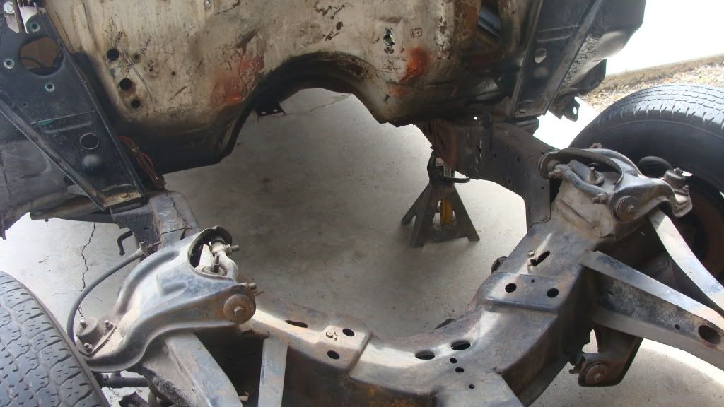

    dblgun
    Old front frame[​IMG]

    Cool Project but also a great deal of hard work and sweat.
    The 55 looks decent how much did you have to pay for one in that condition it you don't mind my asking?
    Here in Florida I see guys with old 68 camaro's on trailers that are complete rust buckets asking anywhere between $7,500 and $9,500 dollars.
    With the recession going on I think a lot of guys are holding off building anything right now.
    One the guys who really wanted to build his own car through in the towel and went over to Daytona for the last Turkey Run car show and brought one for $26,000 dollars.
    He told me it's cheaper right now to just buy one then to build one.
    I know most guys love building their own car but for others it just does not make sense right now doing it.

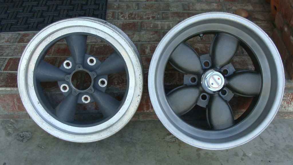

    I've decided that I will stay with my 200s's in the rear and am going to run a pair of Crestline 15x4's that I have. Anybody have any good ideas on running the 5x5 1/2" pattern on my Dodge hub? Does not look like there is enough area on the hub to redrill to the large pattern. Maybe I should repattern the wheels. I am open to any suggestions.[​IMG]
