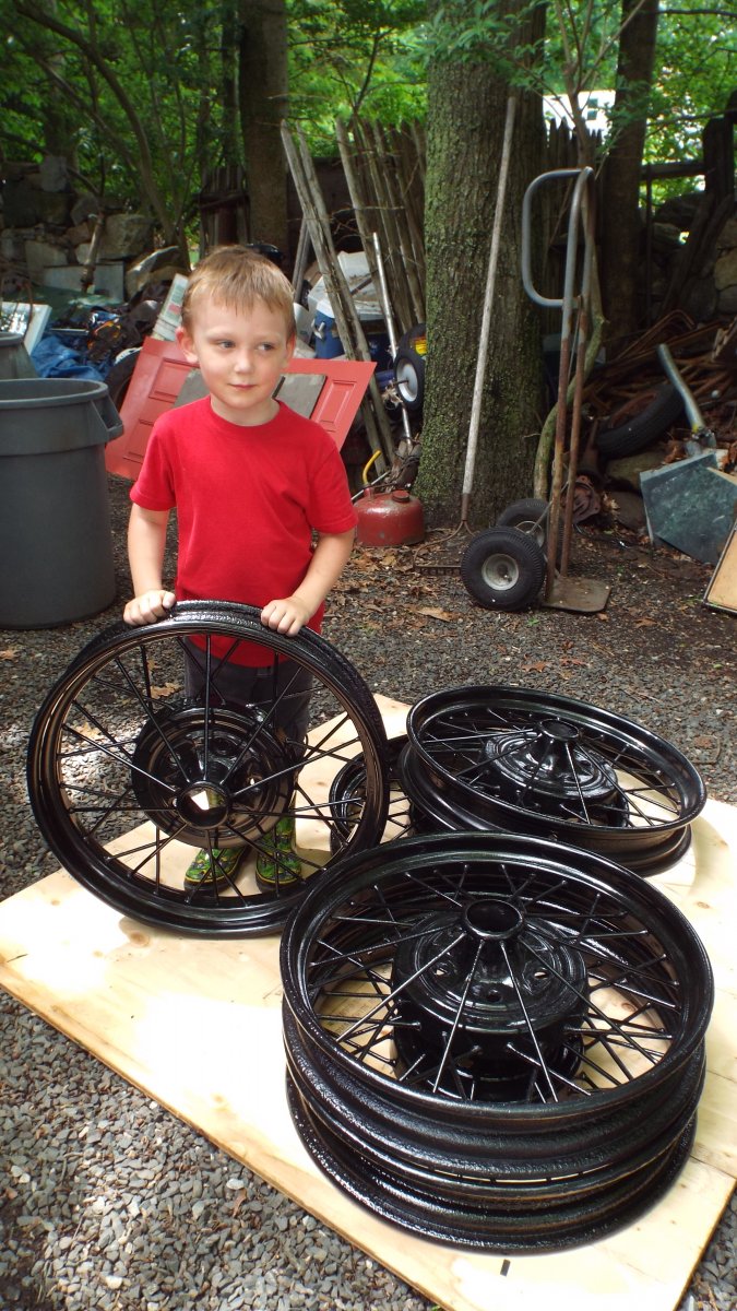

    Grandson is now 4, just added five powder coated wheels to his A chassis project. Can he join 4Ever4 now? Bob

  9. OK now the 4 year olds are showing me up. Time to move faster on my project.
