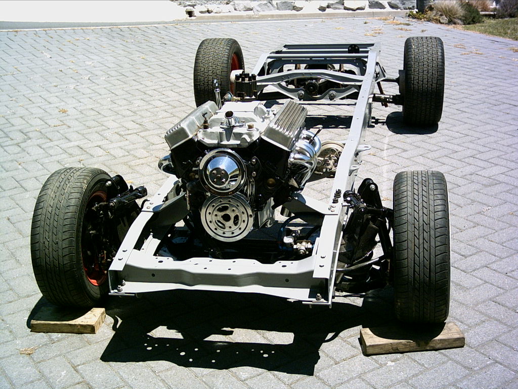

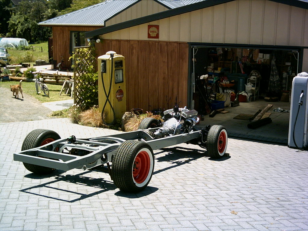

  27. Pics of my '46 pickup chassis. series 2 xj12 front and rear.
