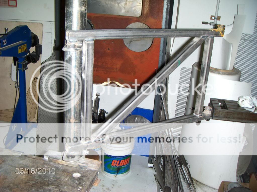

    I had used this plasma tracer that I built a few years ago in my build thread and several people wanted more info so I blew it apart and took photos of the details.The dimentions are not that important because I built mine out of mostly what was in the scrap pile, and it was made to fit an existing table. I don't believe that I have more than $40 into it so if you can afford a plasma cutter I would definatly recomend building one, It is just too handy!
    I started out with a mast made from a heavy piece if water pipe, and fabbed a bracket that would let me adjust the height of the tip as needed for different prodjects, and this has been important, it is held onto my welding table with two 1/2 bolts so it can be removed when I'm not using it.
    next up is the tabs that mount the swing arms, no rocket science here, just some scrap metal, but the holes do need to be paralel to the mast to keep the arm working level threw it's swing.
    The sealed bearings are just some alternator bearings I got from work, they cost about a buck a piece, they are held on with a 5/16 bolt and a couple of washers that are there as spacers to keep the arm cups from dragging.
    next up is the swing arms, Just figure out what the furthest point that you want to reach and make each arm half that distance. I used 1" square tubing, and it's plenty stiff after cross bracing it.
    The bearing cups are just 1" waterpipe that has bee turned out to fit the bearings with some #10 set screws to tighten them up.
    Here it is on the mast,
    The other arm has mounts that are off set to the side, this allows the arm to fold without binding.

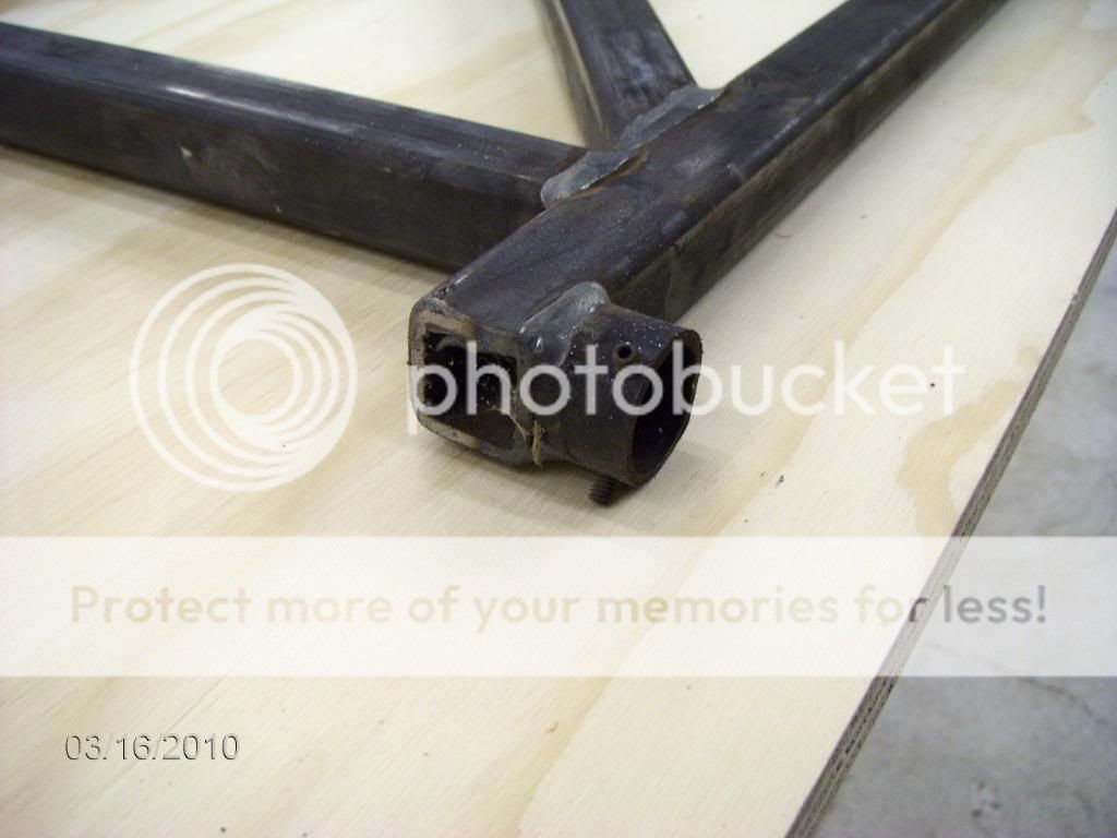

    next comes the stylist it's just a machined adapter that holds a hardened steel roll pin, it needs to be as close to the size of cut that your plasma makes so the parts are duplicated to the right size.
    and then the holder for the torch, I just used a cut piece of tubing with a pinch bolt, this needs to be mounted so the torch is directly below the stylist(also important to make the parts duplicate correctly).
