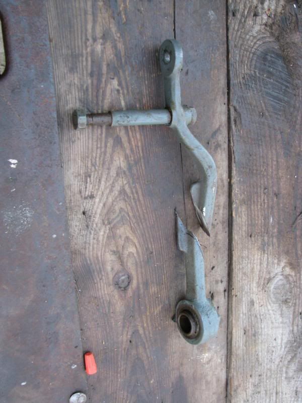

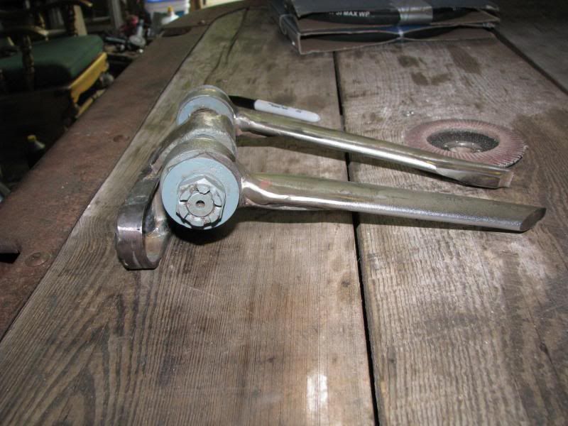

    Before I got too carried away, I decided to mark up the second batch of a-arm parts
    I started on the angled piece this morning
    figure out where to trim
    trim
    add some back?
    transfer new cut lines
    weld
    grind
    admire
    grind some more (first arm)
    grind some more (get rid of open end wrench shape...oh yeah, I welded on the corner pieces too)
    start on the next one...

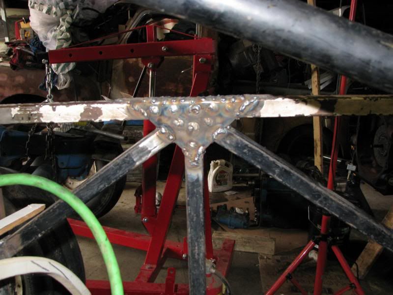

    The last time I moved the car, I did something stupid. To balance it on the chain hoist, I ran the chain around the dash bar and the firewall bar. The leverage pulled the dash bar forward and damaged the frame.
    Well I worked on making the frame stronger.
    First, I cut out the damage and welded in fresh metal.
    Then I came up with a reinforcement plate to spread the load out (more cop car metal)
    glued in
    seriously glued in
    top surface ground down
    I still have to do the other side....
    Next time, I won't lift the whole car by the dash. Engine and trans are coming out.

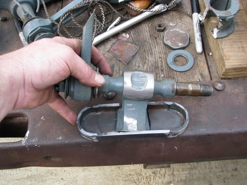

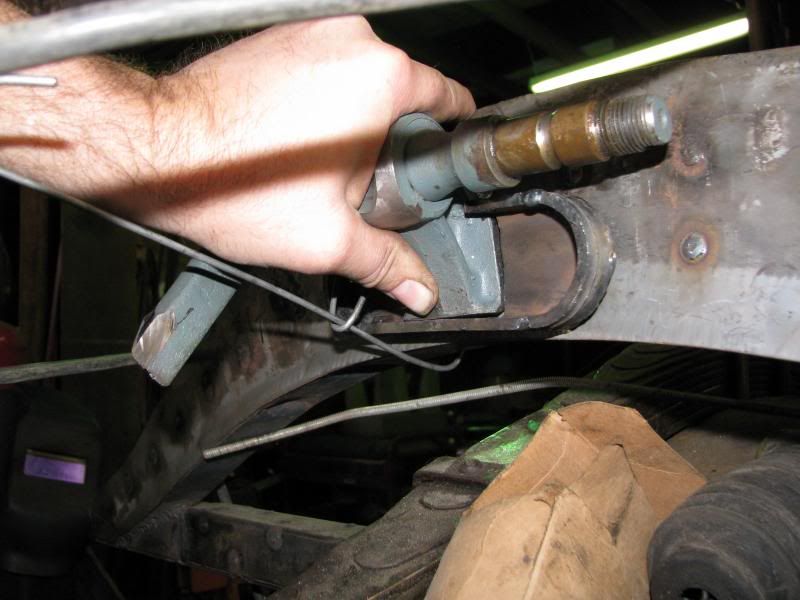

    I worked on figuring out what it will take to get the upper a-arms attached to the frame.
    I cut these from a piece of 2x4
    so that I could do this
    The idea is to mount the mercedes shafts on plates so that the arms can be bolted to the frame. The problem is that the frame is not square with the world...the rails are pinched.
    The arms need to be mounted at an angle.
    simple enough...in theory
    now to make it pretty
    make mirror image one too...

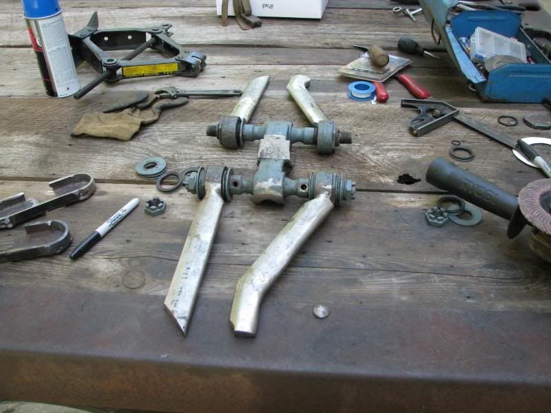

    Welded up the other a-arm kit
    and one of the mounting brackets
