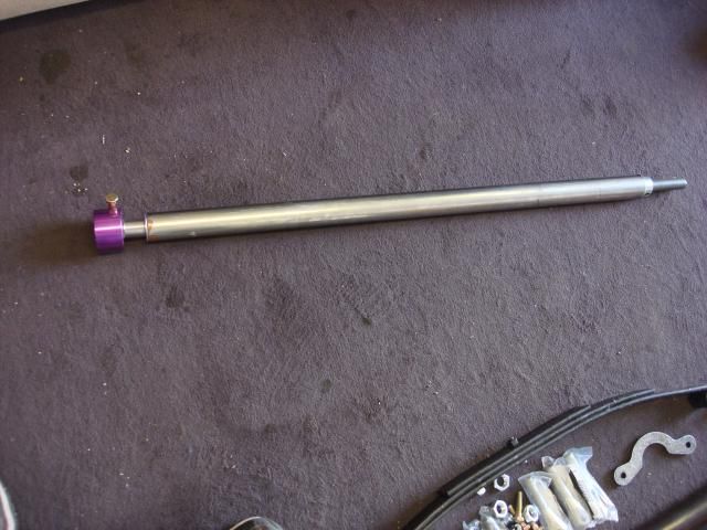

    Thanks, guys. Did I mention I LOVE getting car parts in the mail ? Today the brown truck showed up again and my front end parts from Ron Pope Motorsports showed up. To say I am happy would be an understatement ! :D They are absolutely beautiful and really well done.
    This transaction with Ron, from start to finish , was about as good as they come. He kept emailing me to make sure he was making them exactly how I wanted, and he got them done exactly when he promised. That is all most of us ask for, and a lot of businesses could learn from guys like Ron. I also like buying from HAMB members like him when I can. A big thanks, Ron, we will be doing more business for sure.:D
    With Christmas and all the parts I have been ordering for this build I am going to have to pull in my reigns on buying stuff for a while and get my savings back in shape. But I have enough parts now to begin getting the frame further along. I picked up a little more 2 x 3 tubing today because I am rethinking the rear part of the frame to allow me to install a 4 bar setup the way it should be done.
    Here are some pictures of the stuff that came from RPM today:
    It's little details like the holes he added that really make these parts cool:
    Don
